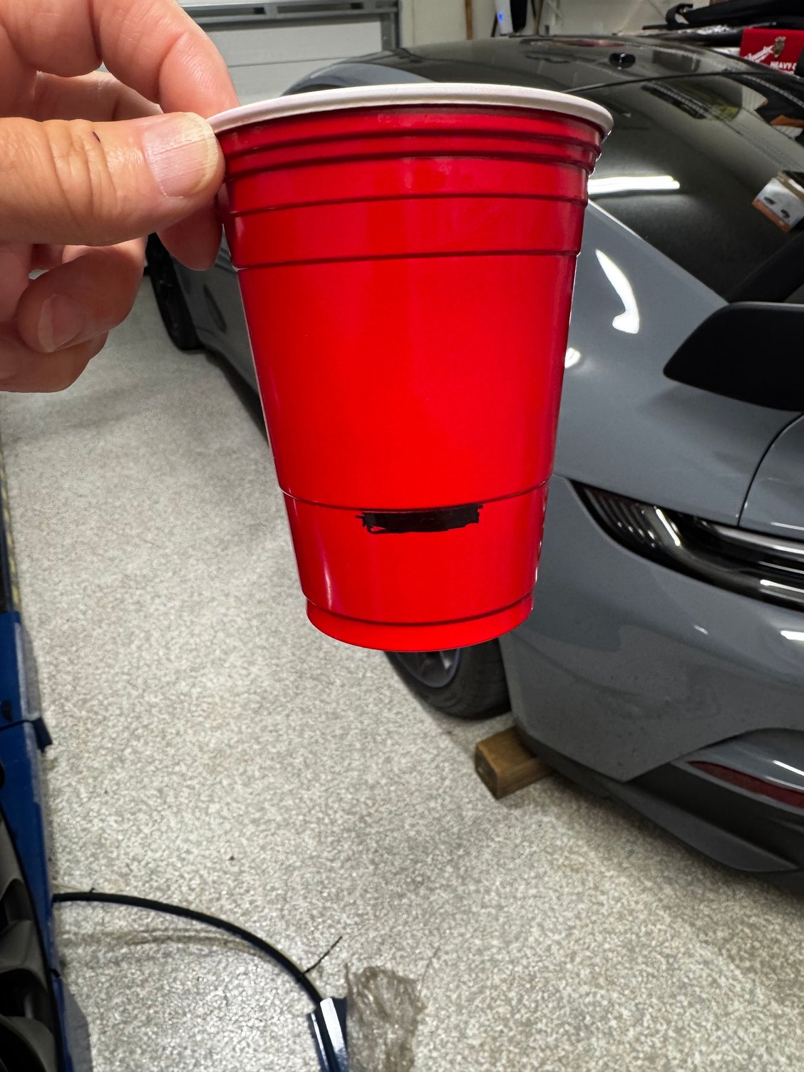

This method works well for me and fits in there without a funnel. I can’t emphasize enough how little you need to move the gauge or the app 25%.

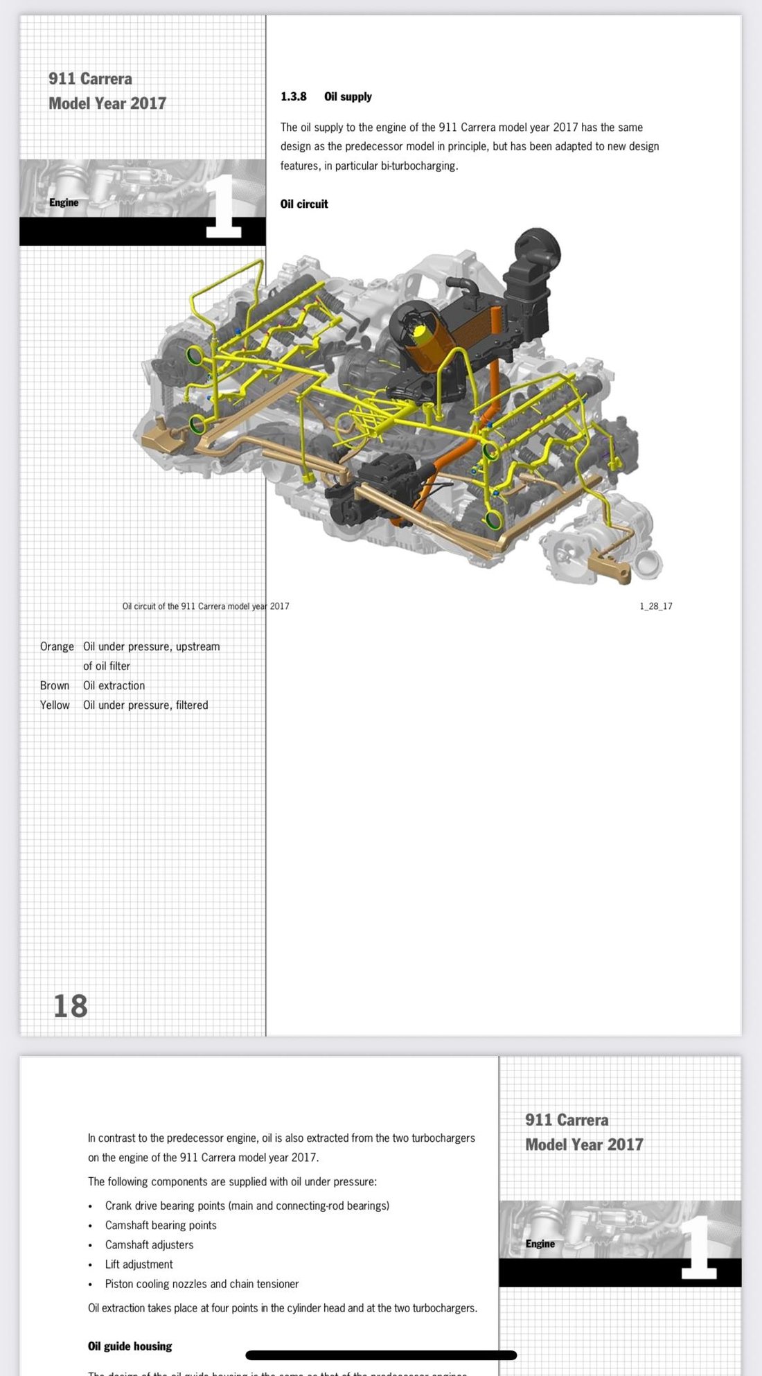

This is from the previous gen 3.0L but consider if you have an oil sump in the engine’s basement with the separator and all the oil then it doesn’t matter what windage and baffling its got, its wet sump. The oil is being held in the bottom half of the engine.
In any case, when Porsche decided that we have to run the car to temp before reading the oil level then thats when the DIY’er needs to be careful. That situation and a novices best attempt at hitting full on their first pour is dangerous. If you know what you're doing, its all good with me either way. If a DIY forum asks someone who has worked in the oem automotive sector for a little bit, you’re going to get that kind of an answer. Some people think its overthinking...
If you don't overfill it, you set it to the max acceptable, don’t track your car, and only drive a few hundred spirited miles than it probably doesn’t matter. You’re fine as long as you don’t go over filled. Most people have done their diy oil changes on here with no problems, so nothing to overthink. We’re talking worst case i guess.
