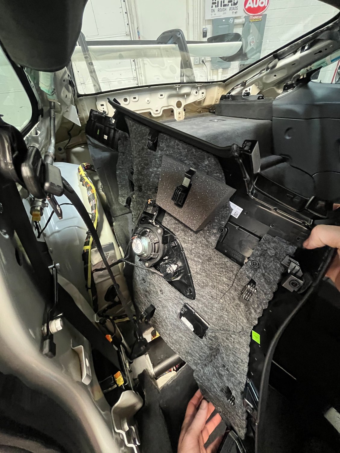

@thewiseowl is the rear power adapter the same as the one in the front? also, do you have a picture or video that identifies which pillars we need to remove and how?
drivers side rear pillar (right rear) — picture #1
on my 992 3RS from what I recall the connectors were the same front and back.
pull the rear (bottom of rear glass)
The pull the driver side right rear pillar (right to the rear glass) … looking from inside the car
careful for the clips and the orange looking string that’s attached to the pillar …
