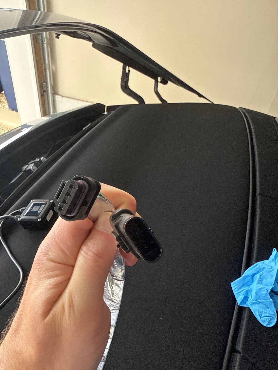

I ordered the 992.2 GTS variant and it came with a 4 pin connector. Do we need a 5 pin connection?
