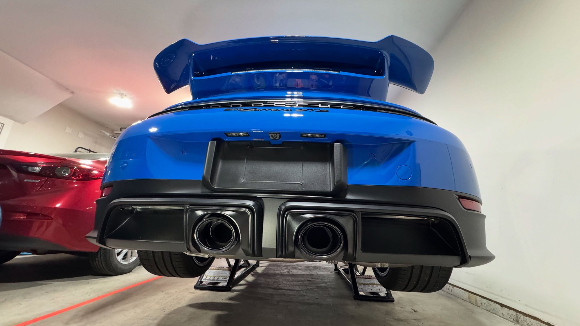

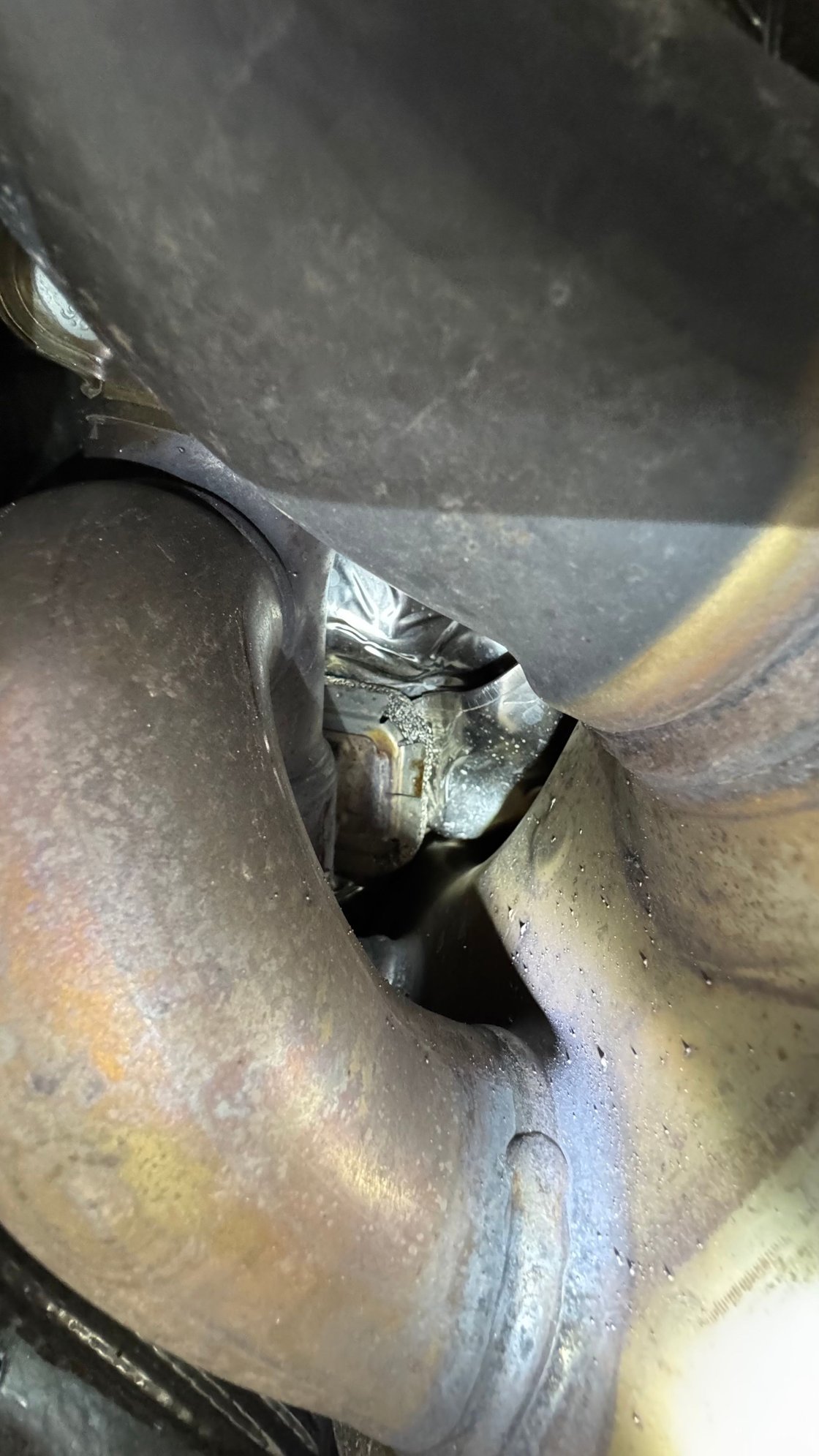

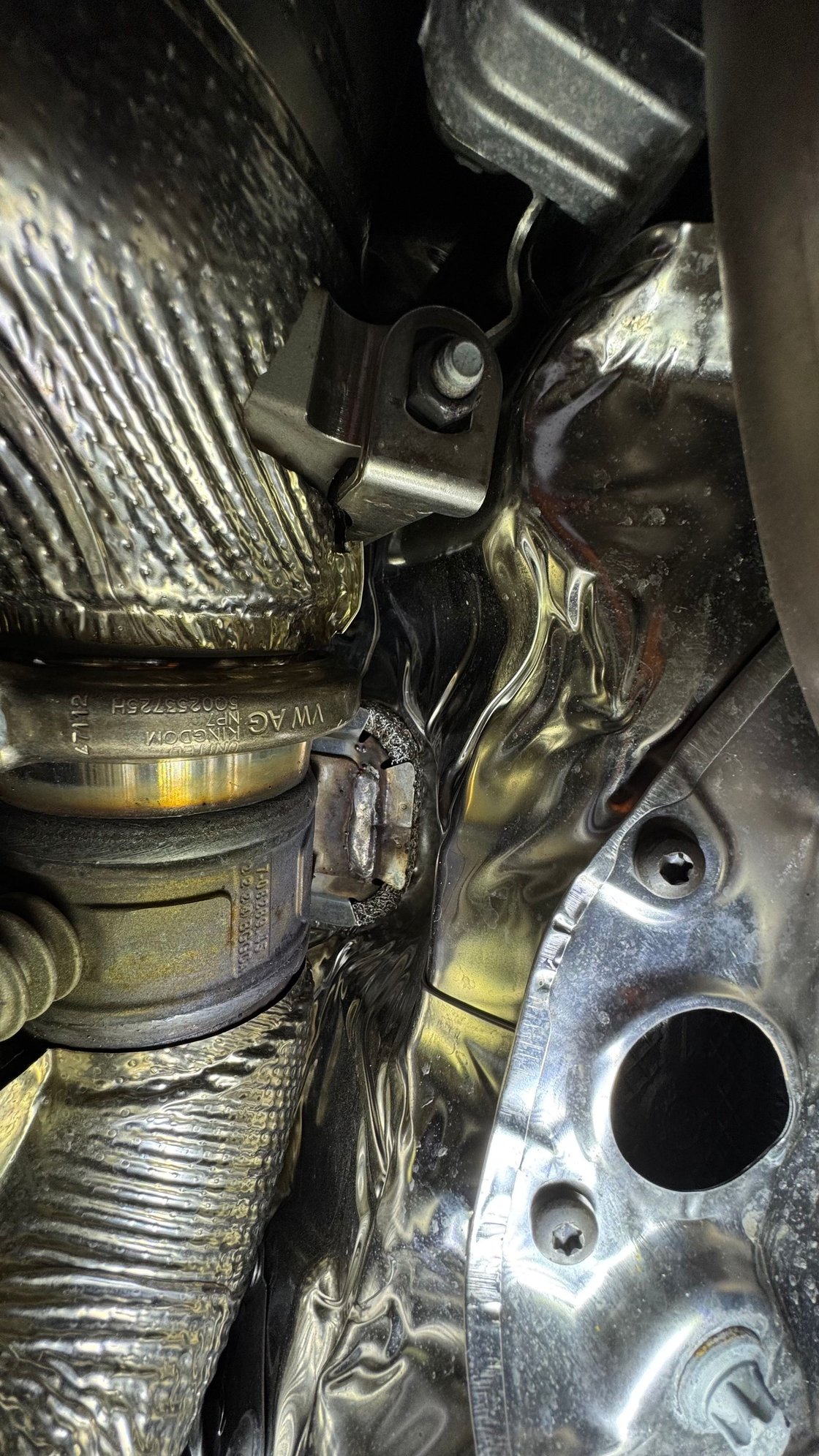

Well I’ll put this to rest shortly.
The 992.2 has its valve actuator buried in the heat shield this time and not accessible from the undercarriage like the .1s.
You’ll need a rear bumper cover off install
here is my car as I tried to install my own valve controller:
on the butterfly valve, you can see part of the stem return to a more closed position after idle.
I’ll have free time and this controller should be installed on June 25th and I’ll report back.
