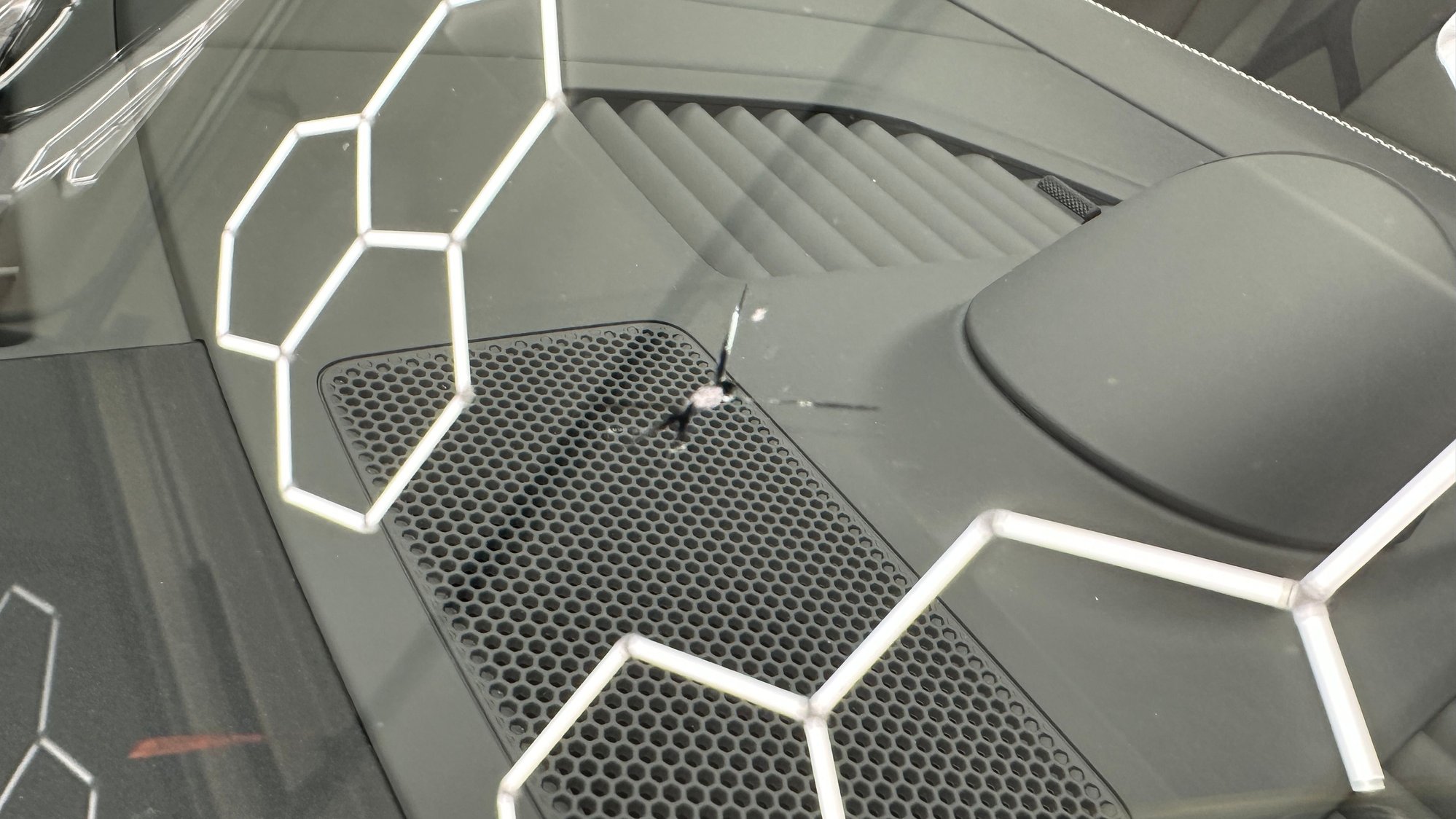

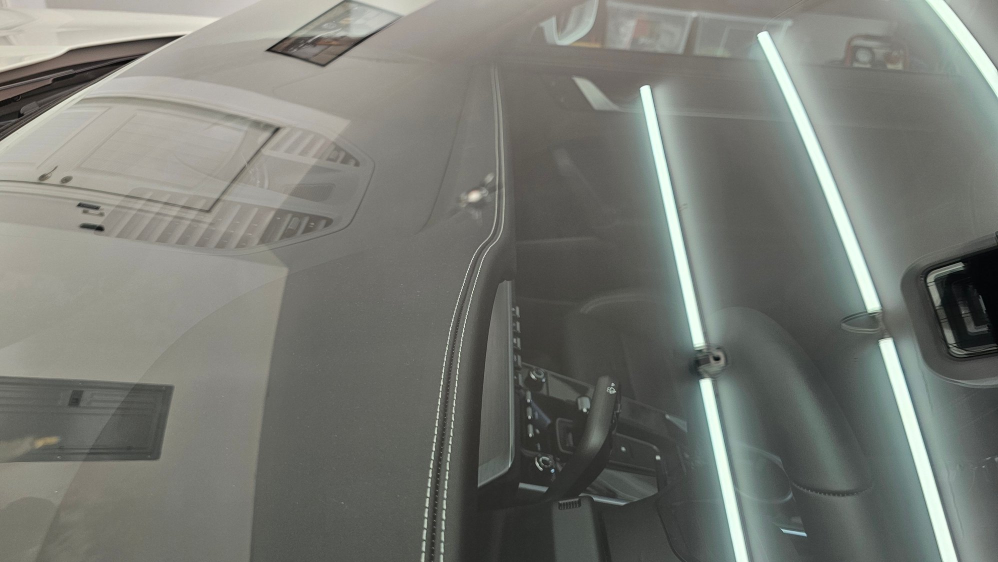

I got a rock chip in my windshield this weekend. Just 4 months into having my car. I've been driving my other car for 8+ years and never had a rock chip. Oh well, I guess it was just my turn in the barrel. What sucks is that my insurance company won't fully cover an OEM windshield. I'm going to get one anyway. But here is my real dilemma. I have PPF on my windshield. Should I replace it when I get my new windshield? I'm 50/50 on this right now. I still want to protect my windshield against sandblasting and the pitting that comes with that over time, as well as the smaller rocks that can scratch the glass.
Thoughts?

Chip? That looks like a major divot! Sorry you've had to endure that.
I would definitely go with an OEM windshield. As for PPF on a windshield I've never had it so have no experience with it. Good luck.

Thanks Mike. It is certainly a divot.

i can’t tell where the divot is, but if it’s not in your direct line of sight, i’d check if it could be filled. i’d rather have even an imperfect fill than go through the hassle of a new windshield.

It's certainly in the driver's line of sight. I thought about a fill but I've done that on a previous vehicle and while it certainly repaired the "reverse bowl shaped" hole in that particular windshield to the point where you couldn't tell from 5 feet away, I could see the repaired spot every time I looked through the glass. This time around the damage is different. it has those small "spider leg" cracks around the impact area. I don't believe that the liquid injection would properly fill those. I could be wrong though.

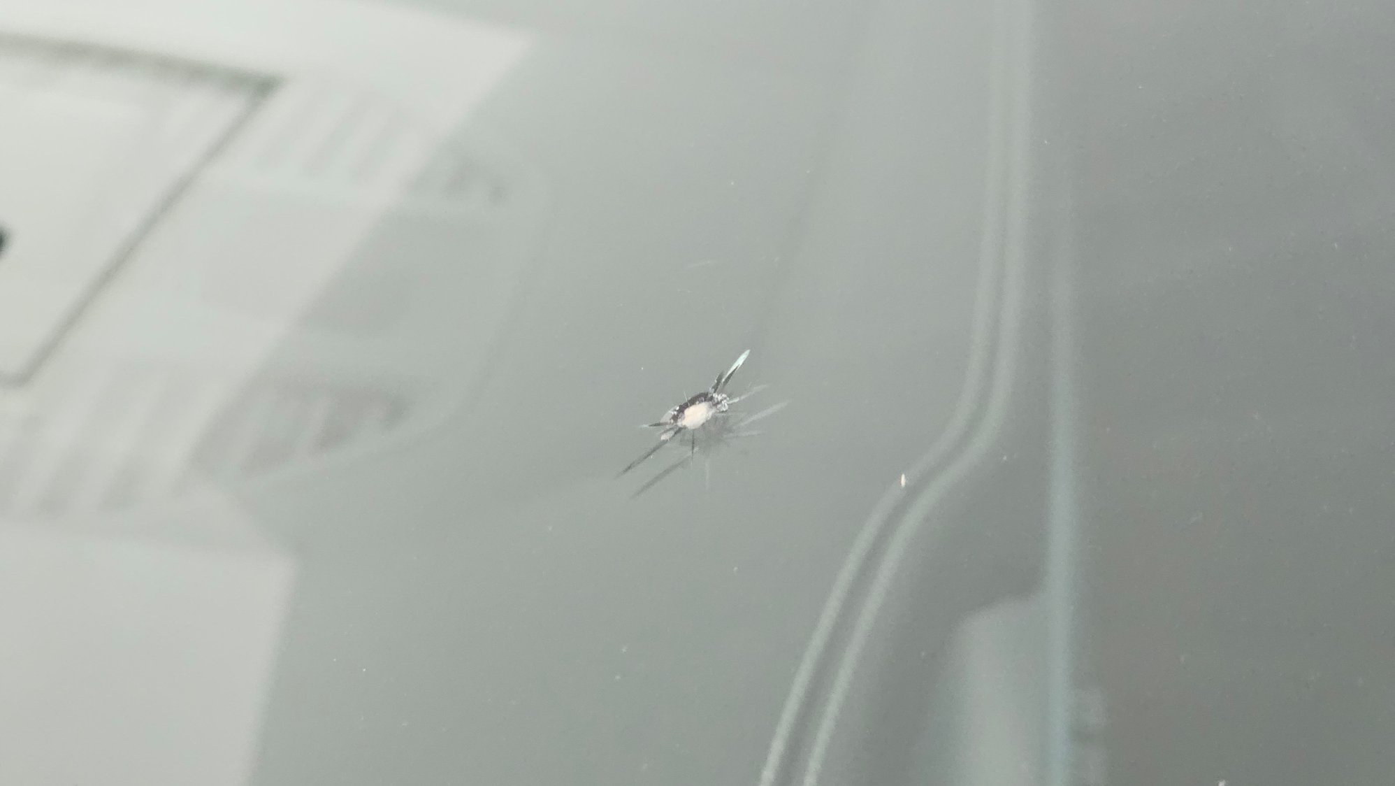

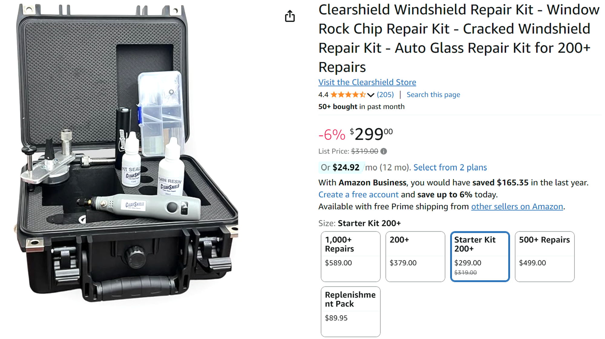

That divot may be too big for chip repair, and it looks to be right in line of sight. But if you're going to replace the windshield anyway you might want to try learning chip repair on it for the inevitable next time one of your vehicles gets a chip. I got a chip in my 6 month old 911 windshield, and don't have glass protection on my insurance (USAA is great otherwise but doesn't seem to even offer it). Looking at a couple grand, or attempt it myself (and then spend a couple grand if I failed). So I watched this YouTube head-head competition on windshield crack filler brands. This guy's channel is random tool tests, but he's awesome:

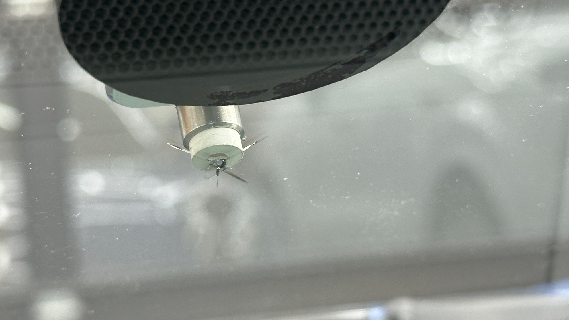

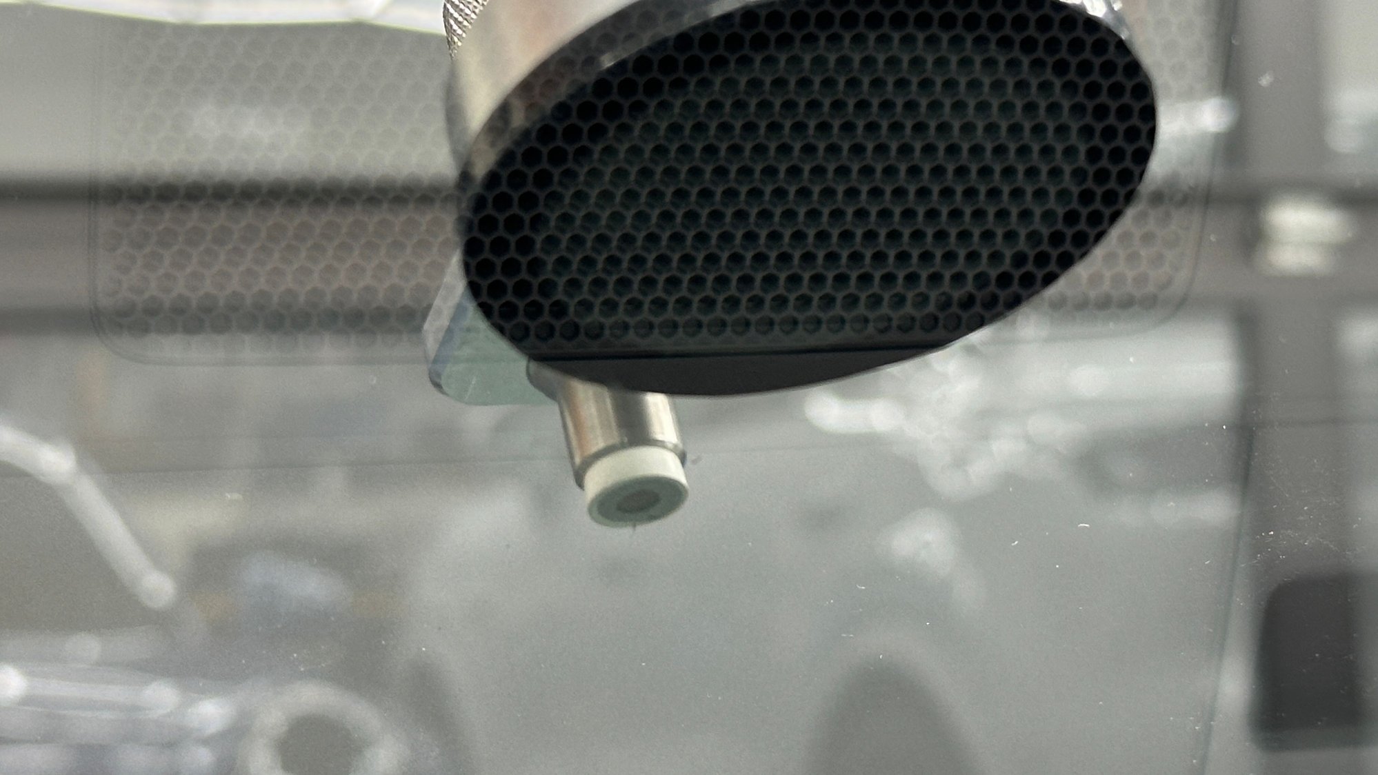

So while the #2 option was $13, I watched a few "pro" windshield repair videos and really for crack filling, tools and experience are what make a pro a pro. Interestingly it's air in the cracks that is what mostly makes them spread, so pulling out the air with vacuum and filling the crack lines with UV-curing filler are what will save the windshield. So I got the $300 kit off Amazon that won the competition, and that the pro Project Farm hired in that video said was "pretty much what they use". I studied up all I could, and figured this was the price of one Safelite repair (actually, safelite doesn't list Porsche as an option when I checked their site).
Here's what I started with, and the result:

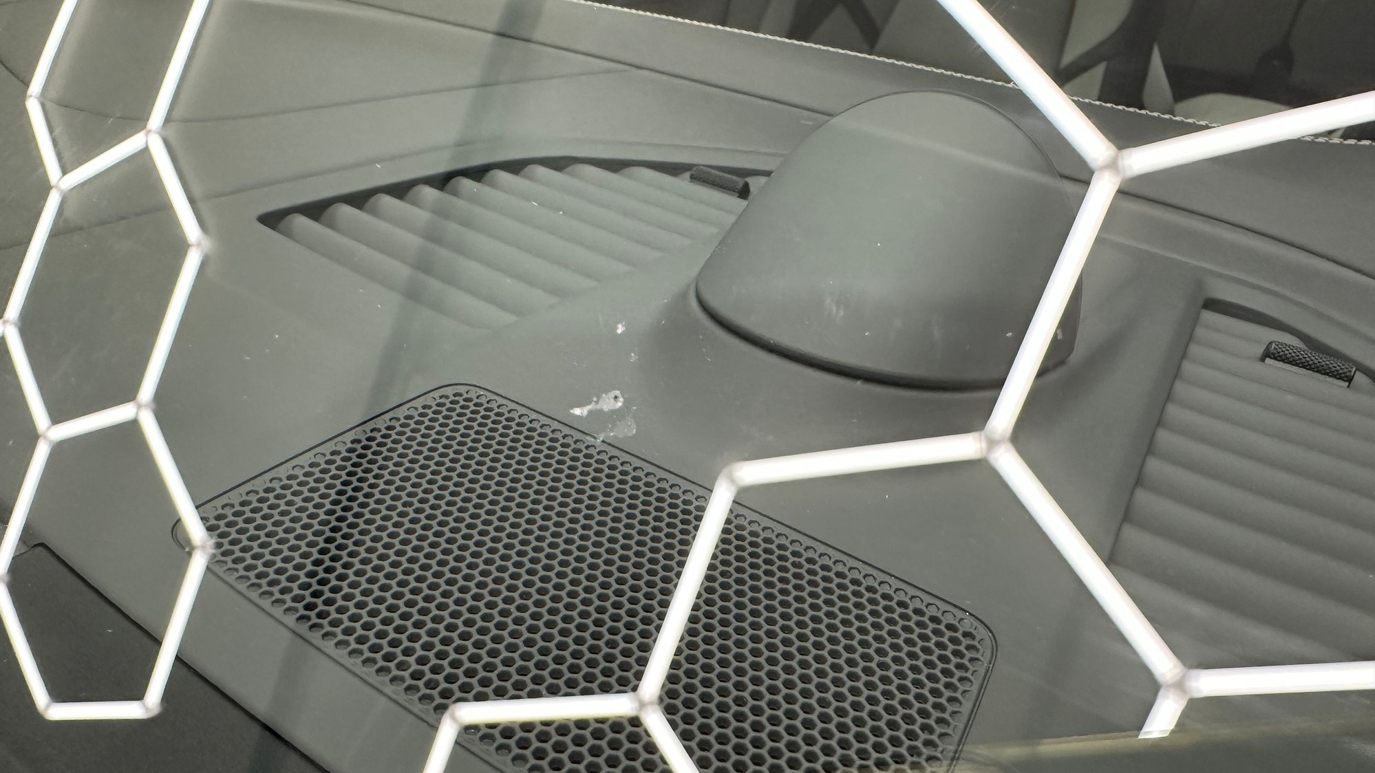

Cracks almost invisible now

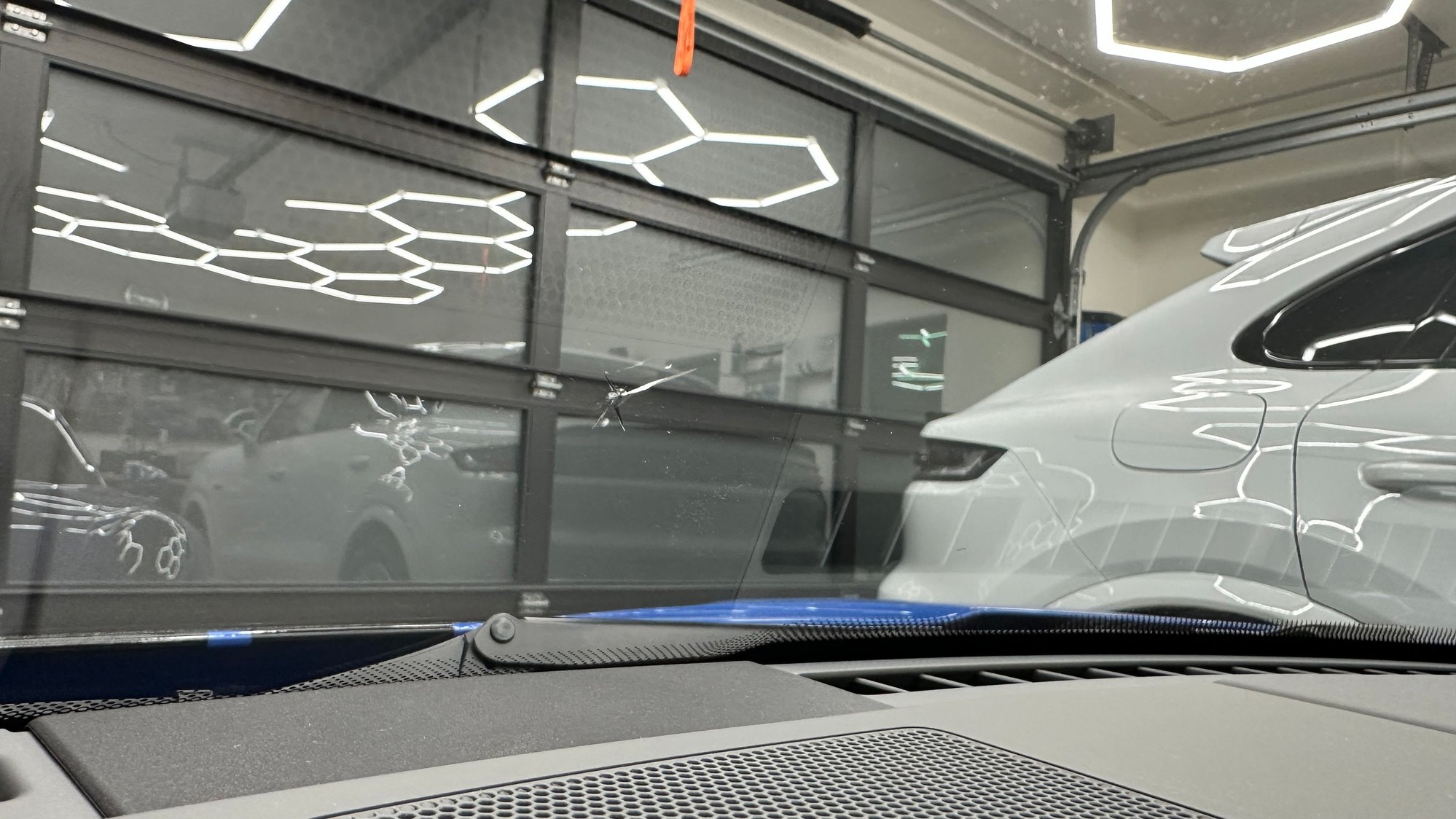

Final result
Final result
For my first repair, I'd give myself a B-. Would be an A- except the damn dremel wandered the second I pressed it to the glass and made that tiny circular pit an elongated scar about 2mm. But the cracks are gone, and haven't returned after a couple spirited drives. And I'm now equipped for 199 more repairs. The YT videos were a huge help, and the tips like using a lighter on the backside of the window to get the filler to spread and using a mirror inside the glass (I used my iphone selfie camera) to see how the repair is coming from both sides were game-changers.
If my day job doesn't work out, I'm equipped to start my own chip repair company now with a whole "one" experience level. Anyway, I feel this kit was more than worth it and I got a real sense of accomplishment from this. I recommend anyone that has an interest to give it a shot. Worst case, you still need a new windshield.
