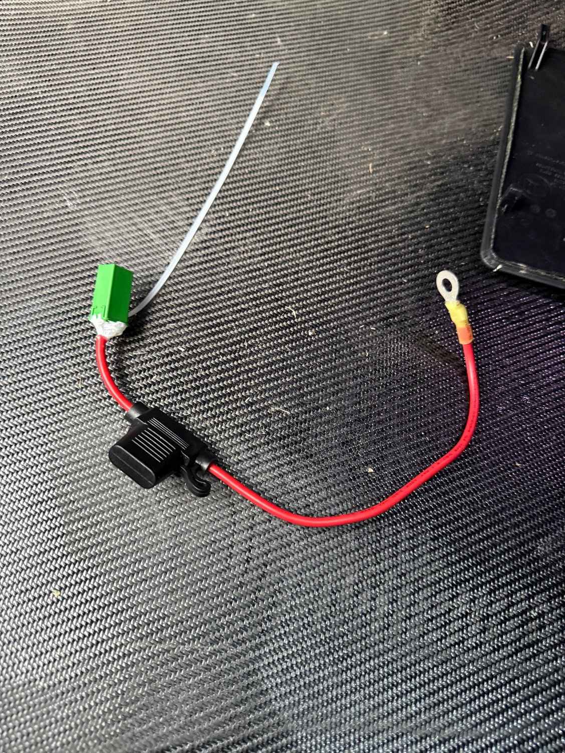

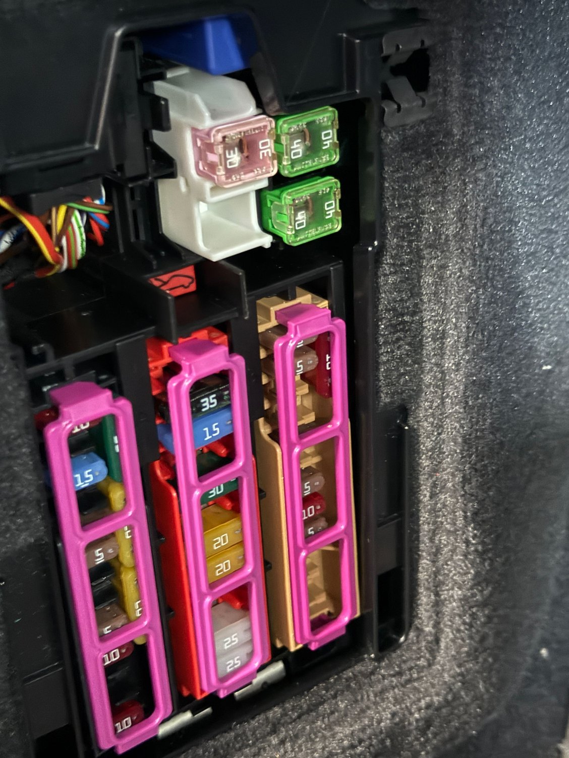

This issue was resolved when the flatbed arrived. A technician at the dealership had made this cable and popped it into a fuse. He then turned the electronics on with his Noco via the cable and we were able to pop open the trunk.
Also, regarding that short I posted earlier, that will only work for a gt3rs because of the placement of the radiators. On the S/T there is a radiator there and you would have to jack or lift the car and remove the wheel well paneling to get to the emergency cable.
