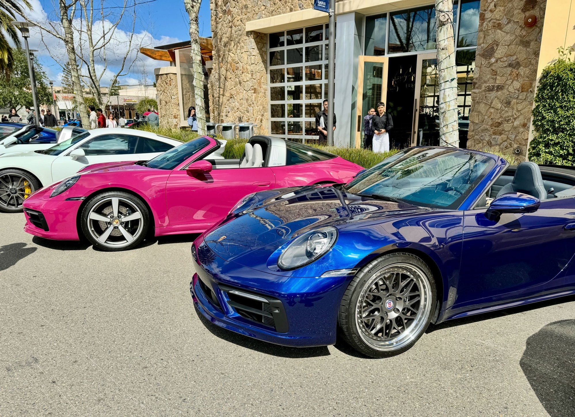

Our C4S Cabriolet with SPASM (and HRE wheels), and C4S Targa. The Targa is very compliant and comfortable. Cabriolet noticeably stiffer.
I think the easy fix for you is KW HAS (height adjustable spring) kit or Techart HAS kit (Basically the same, different colors) which will give you the lower look and firm it up a bit with less spring travel. We also put M-Engineering stage 1 tunes on both, with exhaust valves open 100%. Great sound and tons of power. A few small mods, and enjoy it.
Techart HAS
https://shop.techart-usa.com/product...EaAm0kEALw_wcB
