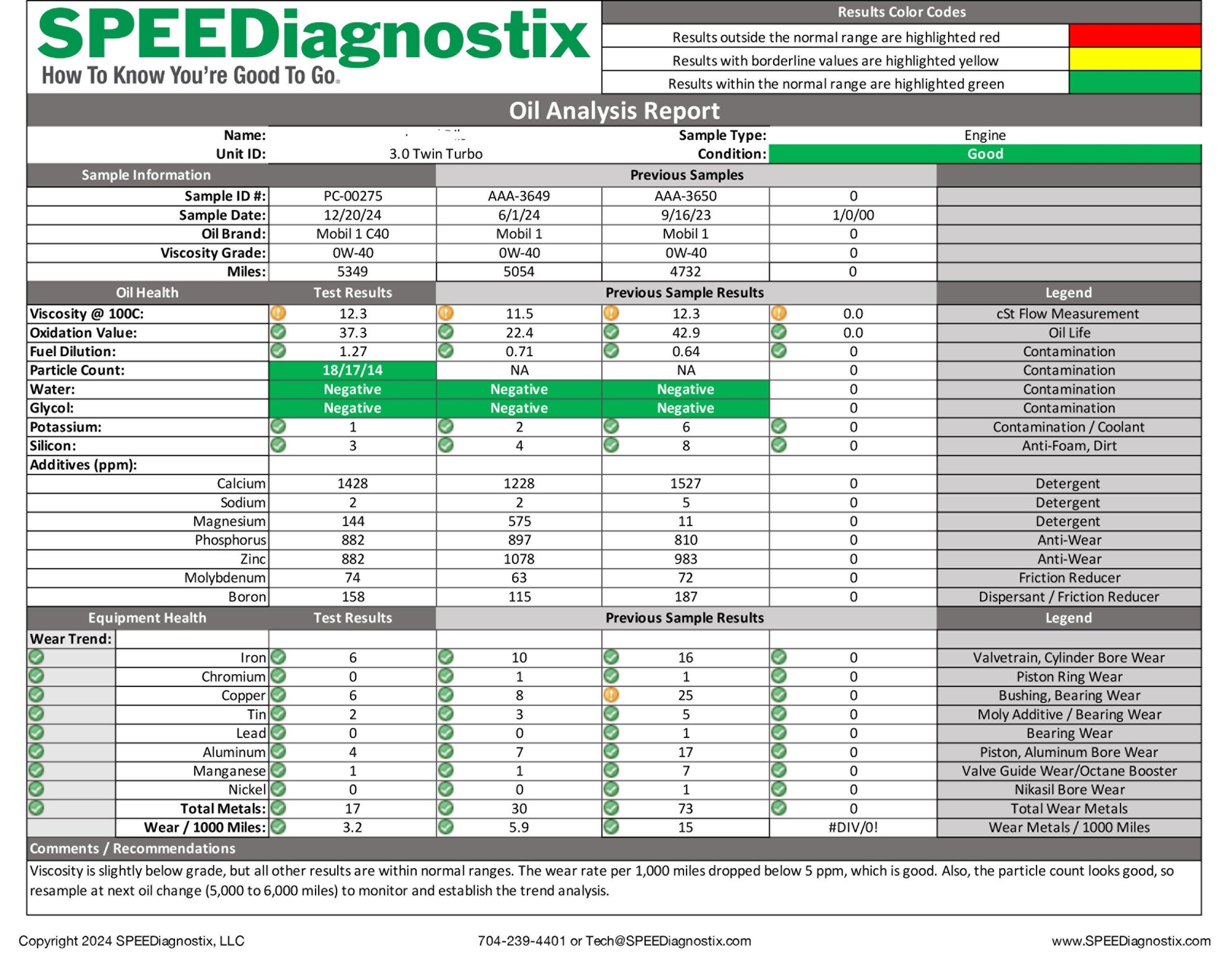

Default ~15k Oil Sample Report
3rd oil change. Engine seems to be doing quite well.

What intervals have you changed the oil? I did my first at 2k miles. Was going to do another at 7k.

@TK42ONE Thanks for posting.... Are the "Miles" shown, miles on the oil, or total miles on the vehicle??
If total miles on the vehicle, please drive you car more!!

Miles shown underneath each sample are the miles on that change so approximately 5k per sample. Yes do need to drive more. Work is on 3 miles away.

approx 5k each sample. The miles for each and under the sample number. Sheet has 3 total changes.
