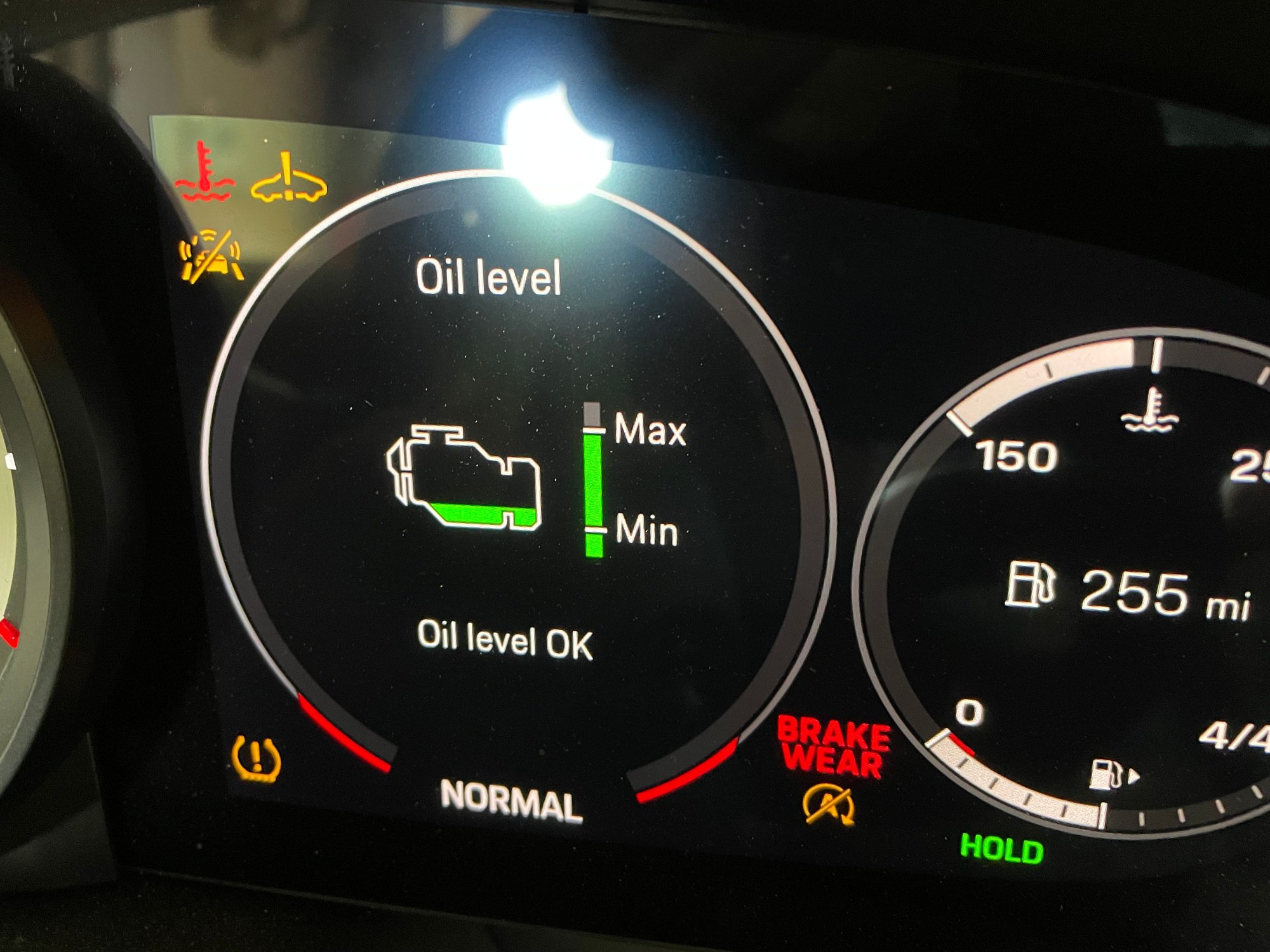

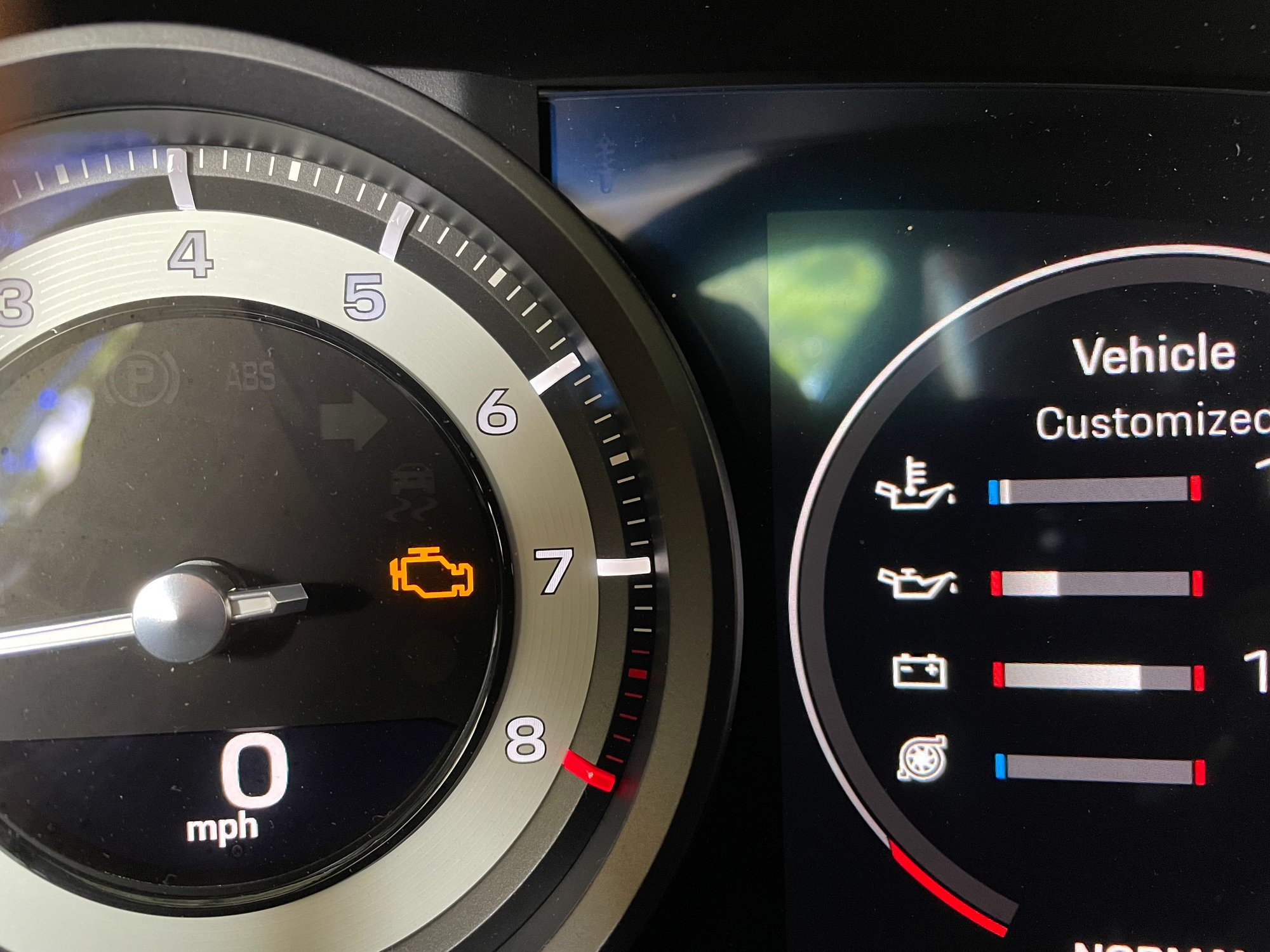

1. Go to this specific screen to the right showing oil temp and oil psi.
2. Press scroll wheel on right side of steering wheel once. A new display will pop up with 4 possible selections. Using the same scroll wheel, scroll down to “Oil Level”. Press same scroll wheel once to see the following.
3. This same info is also available in the Porsche App under “Vehicle Details”.

Correct ??? BUT read the thread…..particularly post #6 where OP then responded back to Siberian stating he could still not find it. Hence, the photos to help OP.
