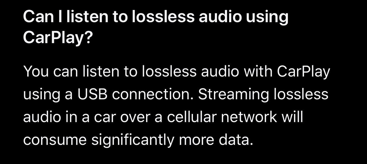

Apple used to have technical documentation available somewhere that detailed this -- unfortunately I wasn't able to find it, so take this with a grain of salt because it's from memory. I believe wired CarPlay transmits an LPCM signal (I saw at least 16-bit, 48kHz, but it may support higher these days) to the car, while wireless CarPlay always re-encodes to (again, iirc) AAC-LC. Thus, wireless CarPlay is lower fidelity compared to wired, without a doubt, and wired does support lossless audio, but only at ~CD quality.
I did find this document, which addresses the availability of lossless audio over wired CarPlay in the FAQ: https://support.apple.com/en-us/118295. Note the absence of mentioning wireless: that's Apple-speak for "wireless carplay does not support lossless audio".
