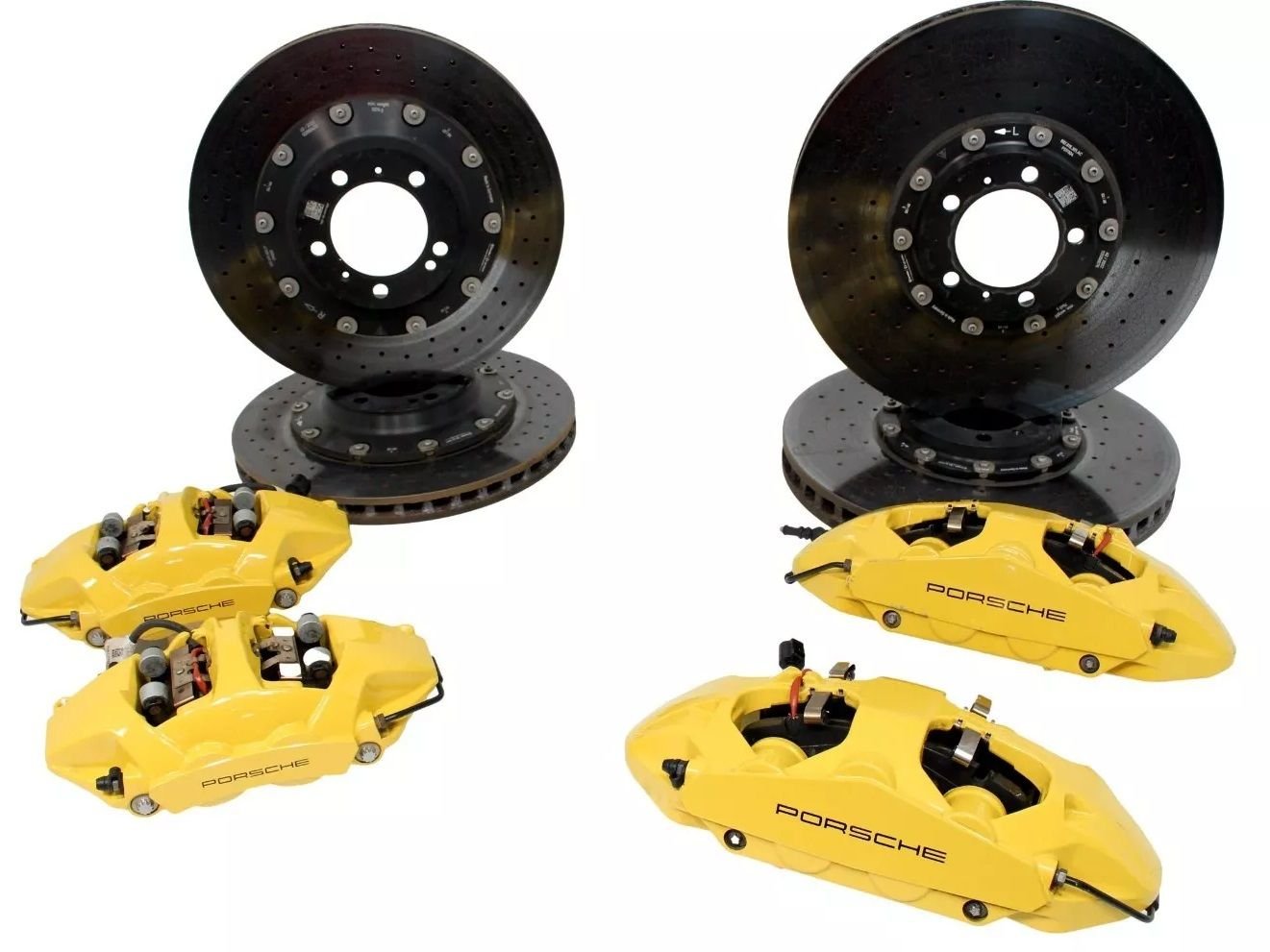

Don't know if you're a fan of Ebay, but these are listed...
2023 PORSCHE 911 TURBO S GT3 991 GT4 SPYDER CAYMAN TURBO CARBON CERAMIC BRAKE KI | eBay
5 piston front calipers with 420x40 ceramic rotor and 390x32 rears
I think the only concern here is needing the brake booster to get proper braking pressure?
