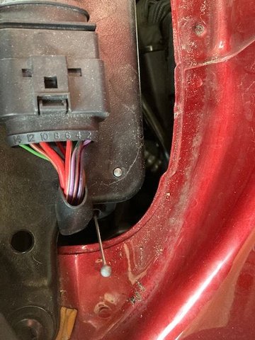

Uncertain if the 992 has this. But, my 991.1 had a manual pull cable for engine lid behind RR tailight.
Thanks! Willing to see if it's still there but the situation's further complicated cause I have a ducktail. Trying to think of ways to disassemble the tail light. I'll follow up if I ever figure it out.
