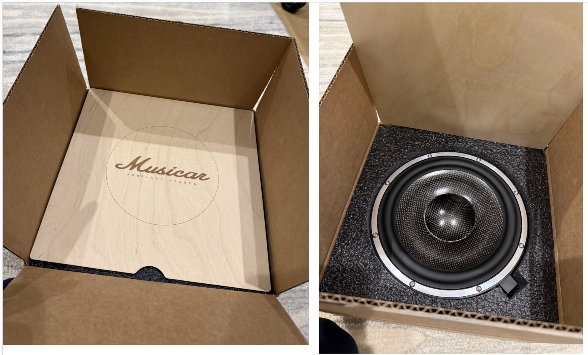

To get things started, I received the package a few days ago. Things are starting off strong as my first impressions are that it looks like a lot of thought and care went into packaging:

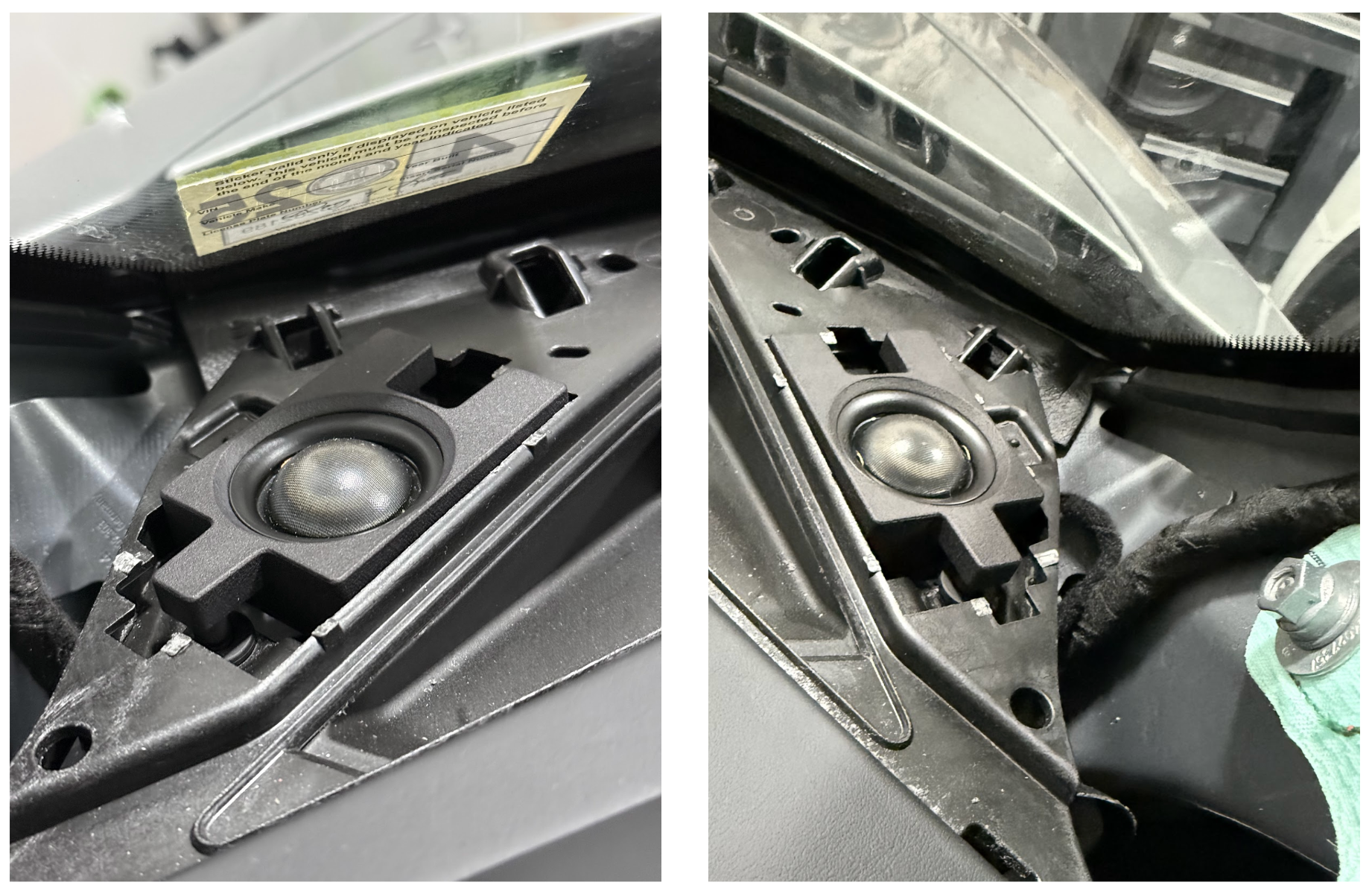

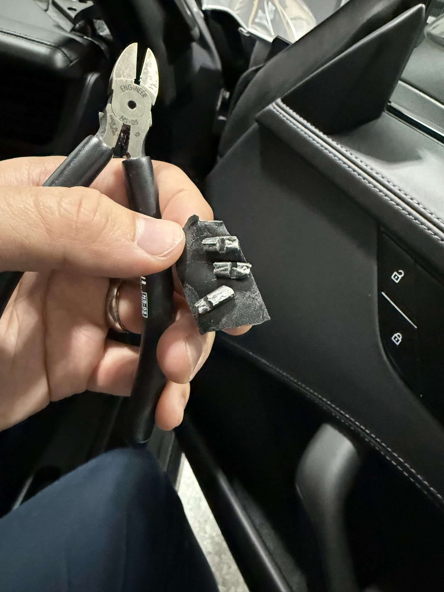

It took me about 30 minutes total to replace the tweeters on both driver and passenger side. Musicar included a plastic trim removal tool that I ended up using. I already own some plastic trim removal tools that I got off amazon a few years ago, but they're getting a bit beat up, and this new one seemed to be nicer quality(?) I'm not actually sure how to objectively judge a plastic trim tool, but I did like using the new one more.
Here are the tweeters loosely in place. This was just to test the fitment, and I also did a quick listen test to make sure the tweeters were all functioning. I utilized the OEM wiring, but I'm aware for the full install, I need to run new tweeter wires:
I know I probably could've spent more time and effort on cleaning up the tabs, but no one is ever going to see them, I'm not too bothered by it.
In instruction video was great, I didn't need to deviate and it was clear to me what needed to be done. I really appreciated the tip to use controlled force when using pliers to remove the metal clip. It definitely took a little oomph to pop that guy off, and without that warning could've lead to some scratches when the clip did finally give.
One suggestion/idea from me. Maybe my snips are of bad quality, but the plastic tabs are surprising hard. What I mean by this is that cutting into the plastic isn't a smooth snip, more of a violent pop. I tried to emulate the technique of holding a thumb over the tab when snipping, and the plastic tab ended up flying somewhere. I actually don't know where it is, hopefully on my garage floor somewhere, but it could totally be somewhere in the cabin like on the carpet somewhere, or hopefully not in some crevice or vent. After that happened, I tried a new technique where I placed a piece of electrical tape over the tab that I was snipping. This way, when the tab snapped, it wouldn't go flying and would stay adhered to the electrical tape. Here is a picture of the result to hopefully give you an idea of what I'm talking about:
The way the tweeters are mounted feel really well done. They feel more solid/substantial to the touch than they would appear. I had previously experienced with a cheaper 3d printed solution to mount tweeters that felt wobbly, flimsy, and kind of felt slapped together. That solution also utilized U Clips to fix that mount into place, and I honestly really disliked dealing with that. I don't want to bad mouth the other solution too much, but it came from the groupbuy that was removed from this forum. The price point of that solution was much lower, so I can't complain too much. But glad to see that the price in the Musicar package improves the quality of all aspects, even down to the mounting solution.

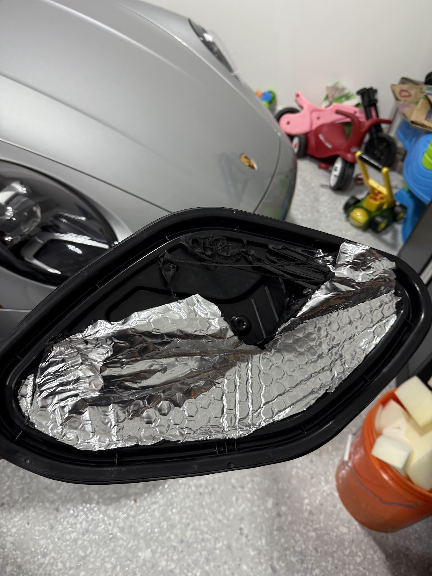

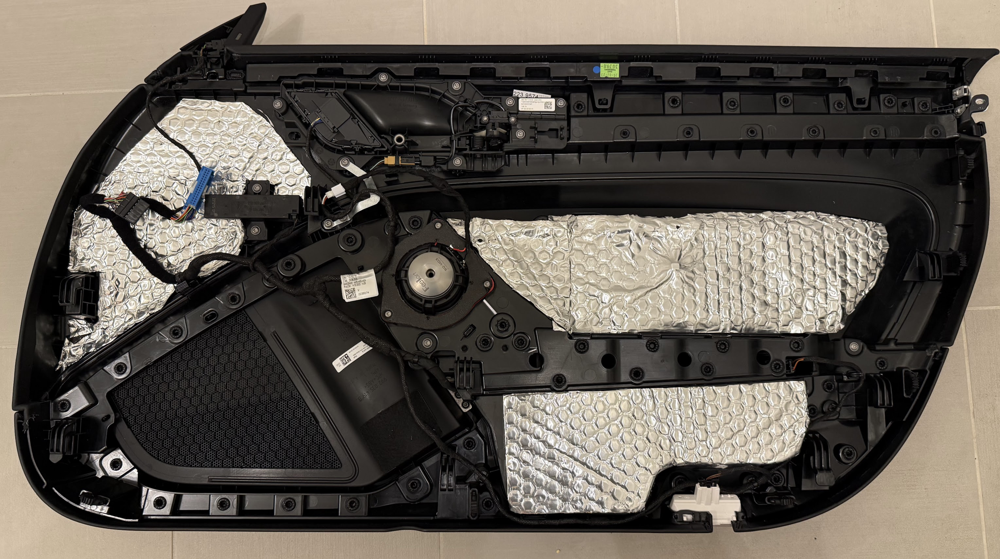

This is the doorskin with Feelart mid and dodomat sound deadening:

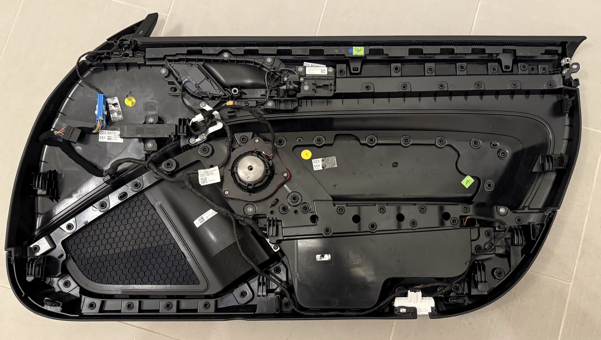

After stripping off the sound deadening, but before removal of the feelart mid, should look similar to stock (but if you really zoom in you can see some staining and boogers from the old stuff)

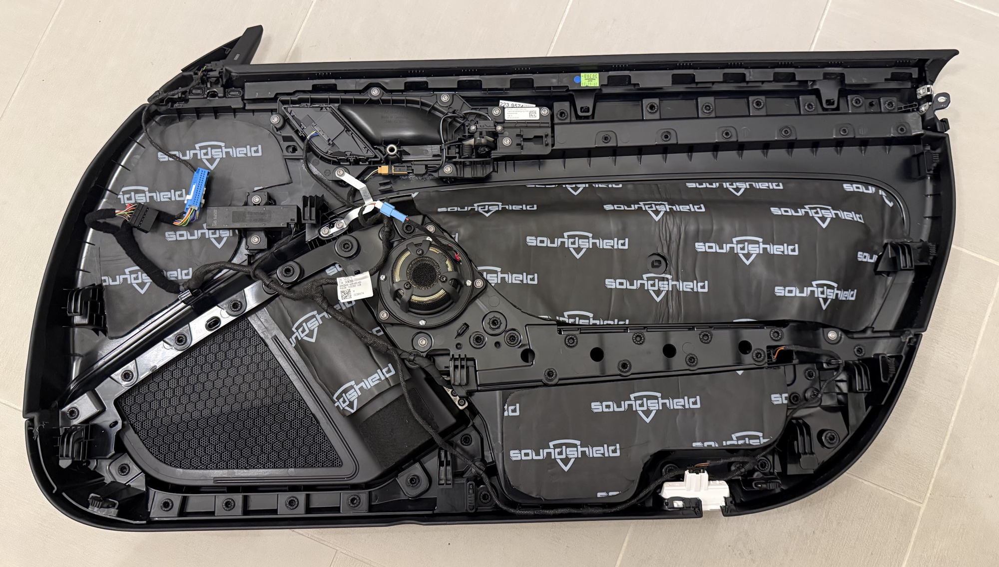

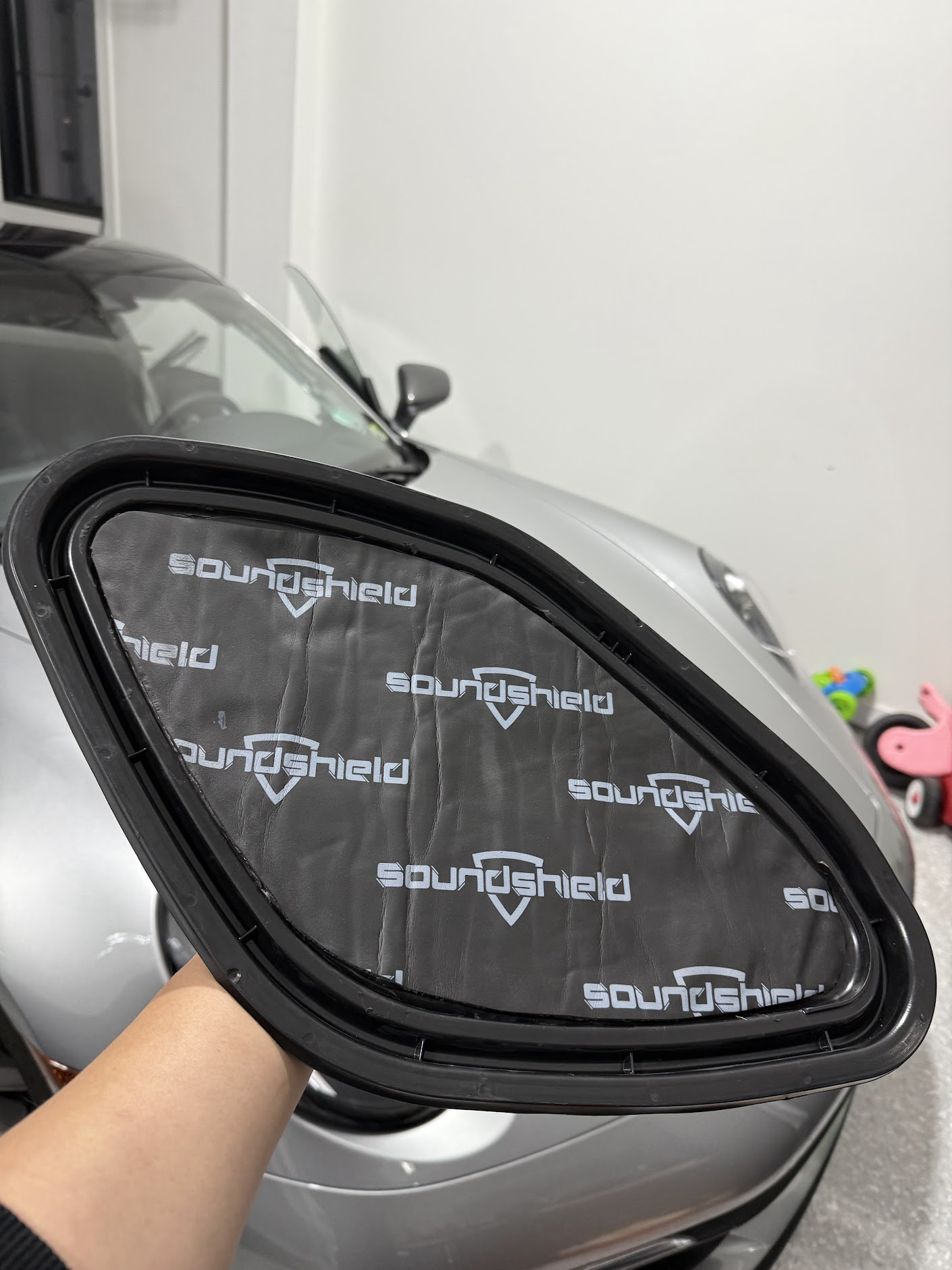

And heres the final result, Musicar/Morel mids in place with the precut SoundShield deadening in place:

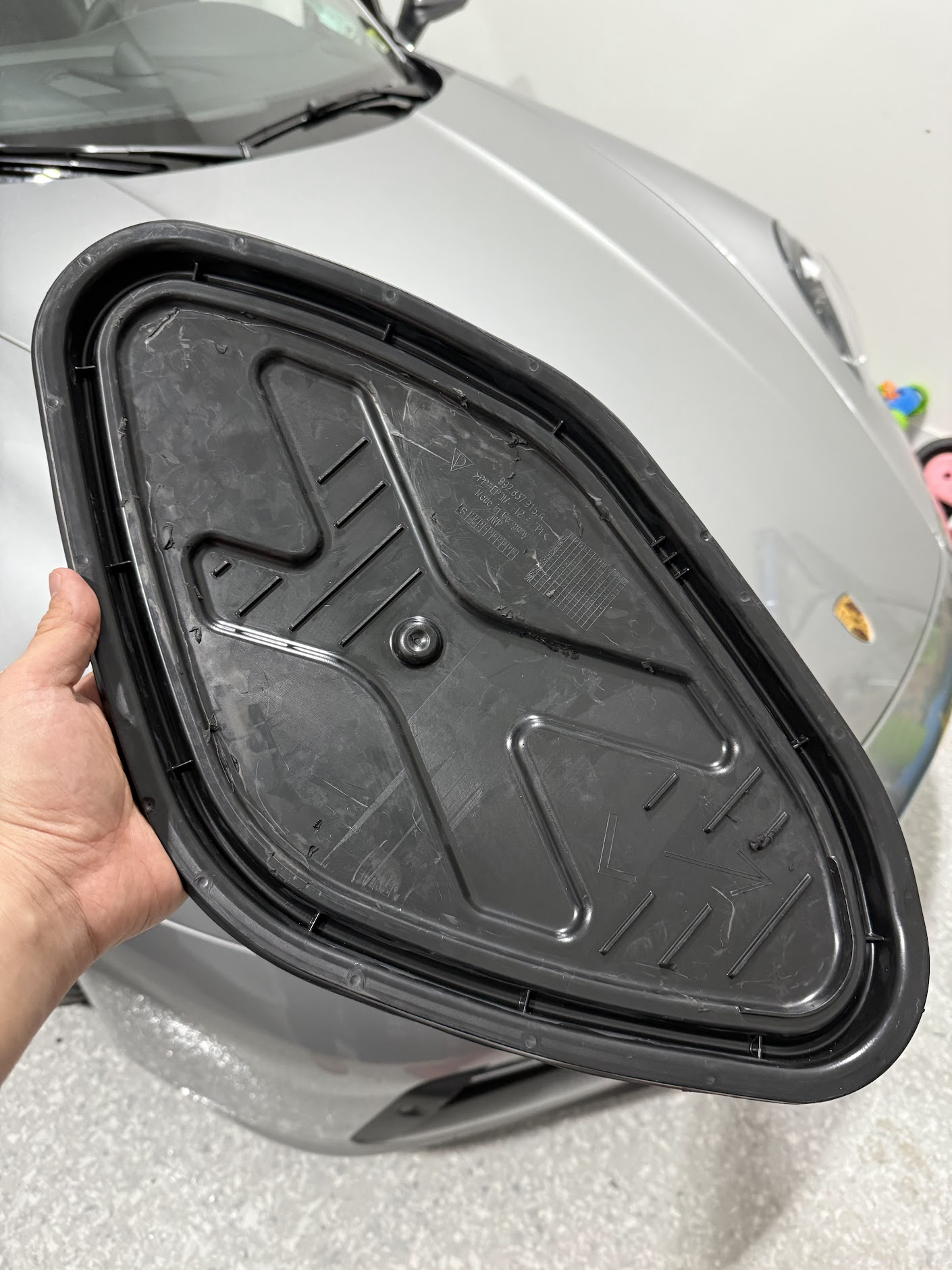

I mentioned that 90% of it came out without problems, heres kind of what I was dealing with in the other 10%:
And after hitting with a scraper, it doesn't quite look good as new, but good enough:
And finally, after I appleid the Musicar/SoundShield stuff on top, you can't even tell there was anything there before:
So some thoughts: Sound deadening stuff is not the most fun thing to deal with. Its sticky and imprecise. However, having the precut stuff helps a lot! The dodomat I had before, hopefully it looks okay, but those were all handcut by myself, and took so much extra time, effort, and stress. There was still some annoyances dealing with the precut pieces, but its certainly better than having to cut your own from a roll.
In terms of comparing the SoundShield to dodomat, the SoundShield stuff is definitely thicker, heavier, and seem more premium. Although unsure how that maps to audible differences yet. Some other notes, yes the dodomat seemed mostly easy to remove, I suspect the SoundShield stuff might be a bit more...sticky. An example of the thickness, with the dodomat, installing the door card back on, it felt almost no different from stock (pretty easy IMO). With the SoundShield, I was a little surprised by how much harder it was to get back into place (this was called out in the install video). It wasn't impossible, but it did take a good bit more finagling and pushing fairly hard to get everything back into place.
With all the speakers installed, but no amp yet, I did decide to power up and give a few test listens. Impressions are...so far, no major change. These speakers might be better, but as Musicar has indicated, the limiting factor is really the lack of a proper amp. I'm excited for the next step (hopefully tonight!) to get the amp in. I've installed amps on previous cars before, and they're always usually where the real step up happens.
I've got about 3-4 Hrs of garage time into this project so far. I suspect getting the amp and cleaning everything up will take a similar amount of time.

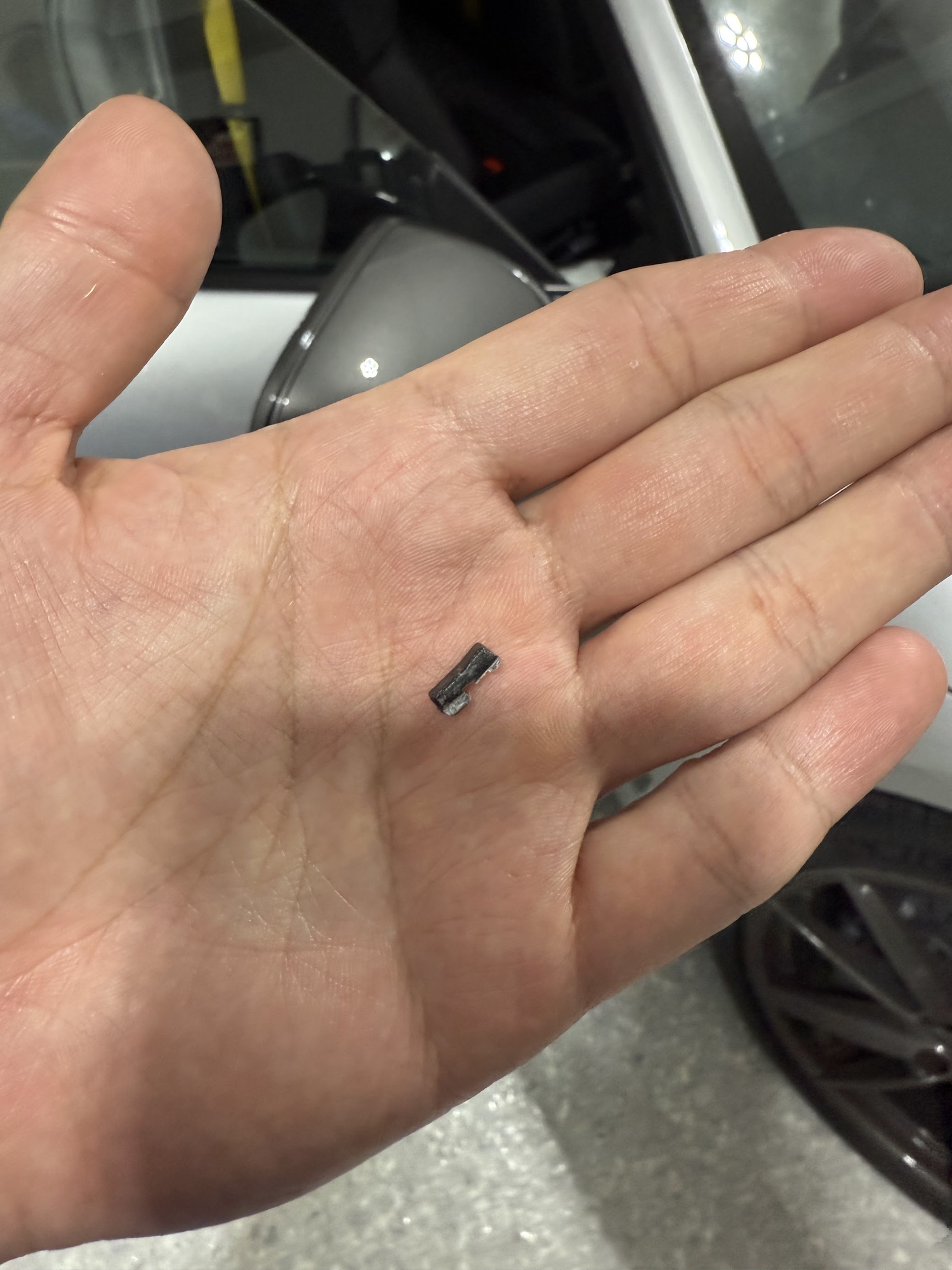

One minor win: On day 1 I mentioned I had lost a plastic tab from snipping the tweeter mount. While wiring everything up and with my face to the carpet, I found the little nugget! So relieved it didn't get into a vent or crevice (the fear was this could be a hard to find rattle):

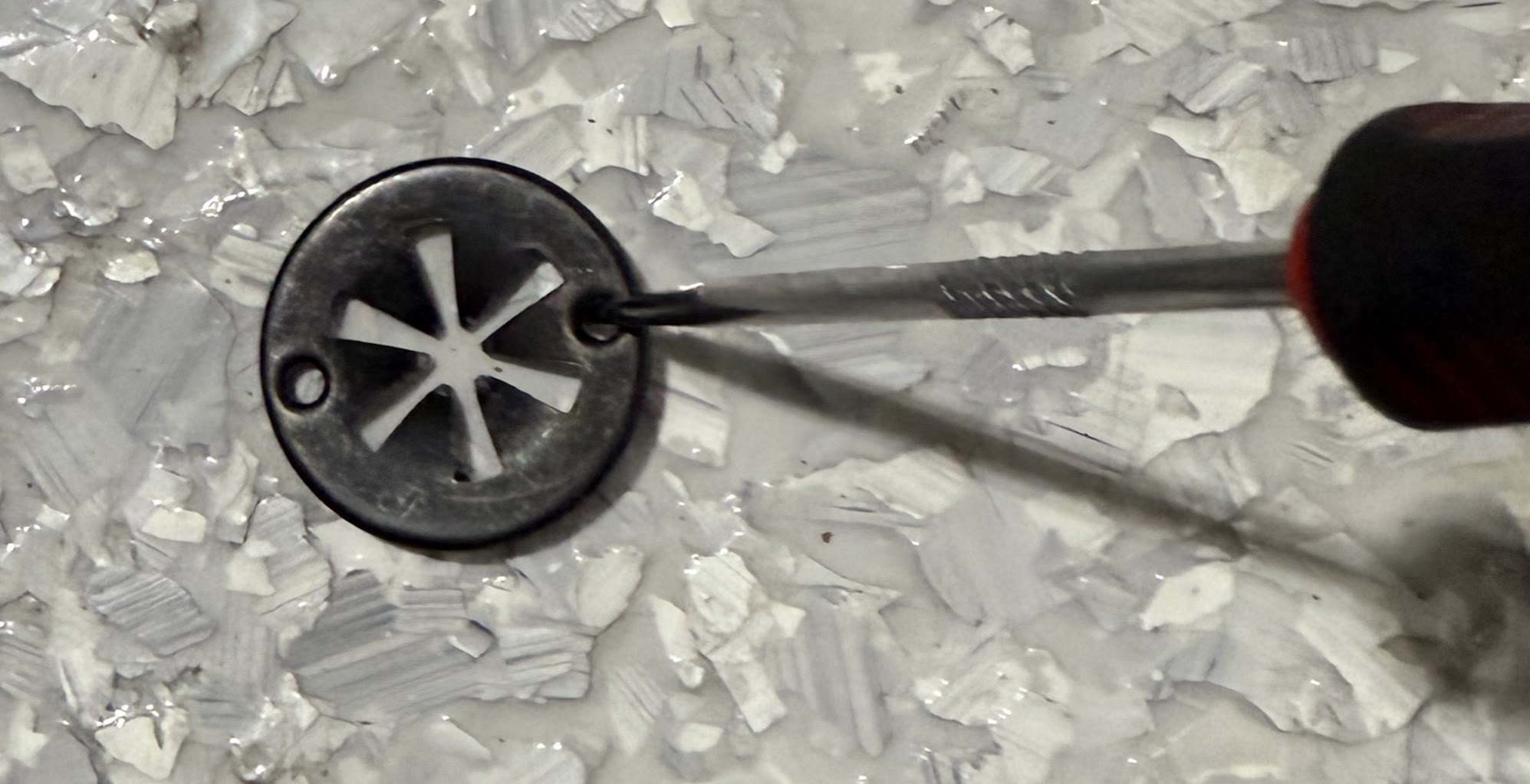

  • I've never seen the weird metal disc clipholders before, they're the ones that hold the foam down and need to be removed. The video just sort of shows how you can use force with a pry tool to remove. I was able to use that method on the first of three, but came up with a different technique on the other two. I noticed there was a small hole on the discs, and the discs have prongs/teeth that seem to hold onto the threads. I realized you can just use a pick and spin counterclockwise, and the disc will back out. I personally preferred this way:
