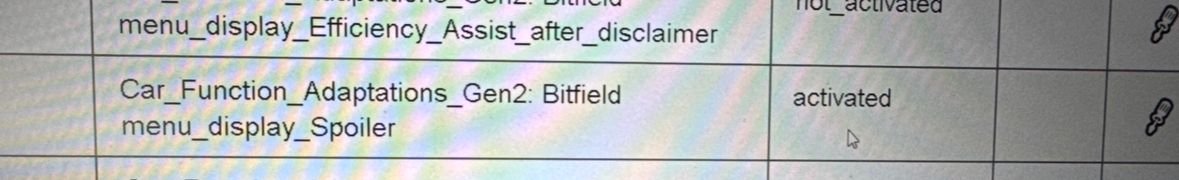

Originally Posted by REVS11
Did you ever go open PIWIS to see what the dealer coded? And were you saying Aerokit change and autocode all modules never worked?
Assuming you were referring to removing the wing option from the menu altogether…..
…..it’s in MIB. You can remove the grayed out section entirely by changing this menu item and auto coding the module. I believe I changed it in two places in MIB.
Change this to “deactivated”.
