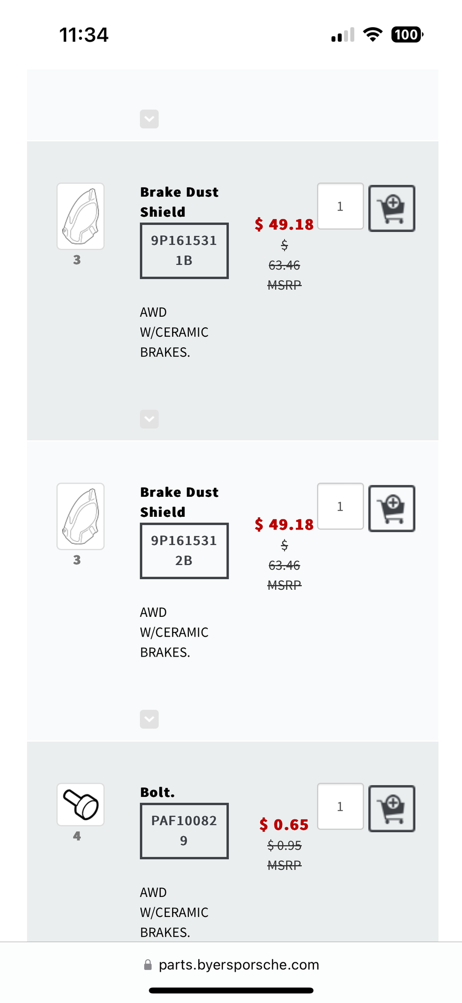

The standard and ceramic both have dust shields. But they’re different part numbers.
PCCB
Steel
Old Jun 29, 2024 | 12:39 PM
PCCB
Steel
great thanks! What site is that?
Google Byers Porsche Parts, they have a pretty good online parts search system.

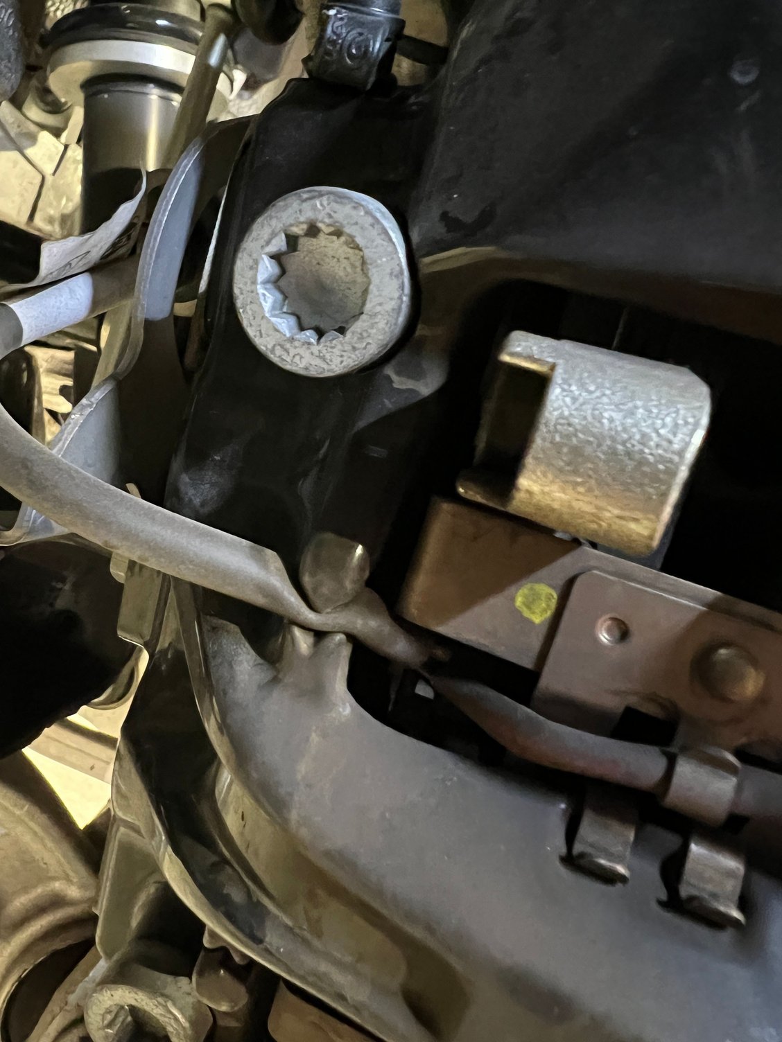

Does anyone know the size torx bit I need to remove the rear calipers?
Old Jun 29, 2024 | 05:20 PM
chelspeed's Avatar
chelspeed
Joined: Nov 2021
Posts: 40
Likes: 22
M14 on mine (2022 GTS).
