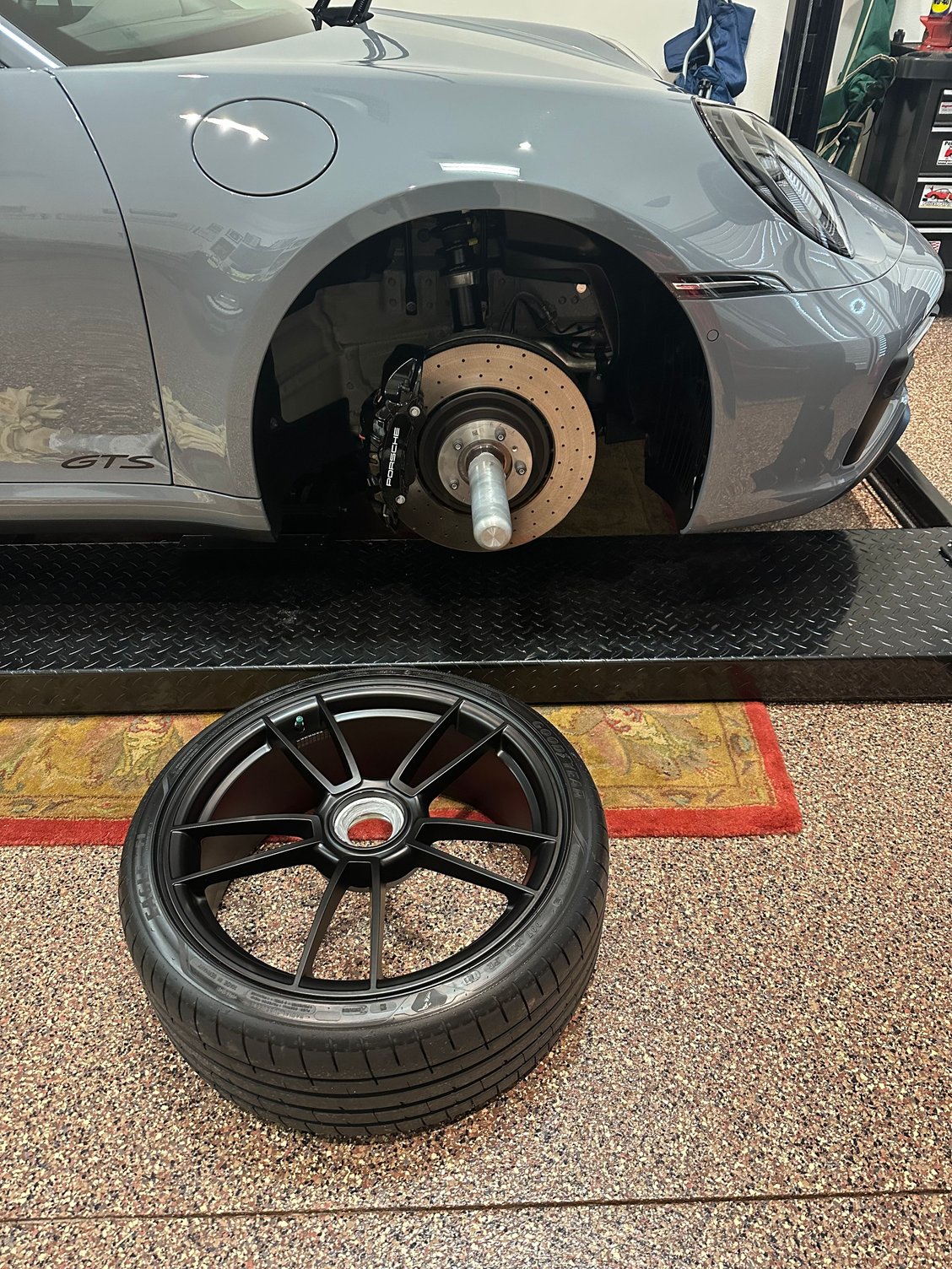

I took delivery of a brand new C2GTS yesterday, build date is December 2023, and today we swapped the tires with winter ones. Here's what I found out.
I bought a Precision Instruments wrench and breaker bar combo before the car arrived and today the usage was flawless and comfortable. Only gripe is that the pin for releasing the torque sensing bar from the wrench is small and impossible to press with a finger, while all the other buttons are big enough. However I do understand that the small section of the torque bar only allows for it.
I do confirm per the instruction manual that there's no need to re-torque the centerlock (CL III version) unless a piece of the assembly or the wheel or rotor have been changed.
The manual also specifies that during torqueing, "maximum tolerance from nominal value is 15%". Said nominal value is 600Nm or 443 lb.ft. The torque for unscrewing the nut can be much higher that 600Nm.
Another info I found in the manual is that "the reaction arm of a battery powered torqueing tool can damage the wheels. Do not use battery powered torqueing tools.". A message to Hytorc users?
Lastly, all the images on the manual show the wrench being pressed towards the floor and nowhere is advised to do the opposite, as I read in some thread.
