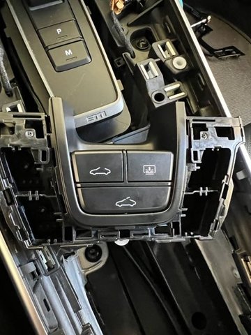

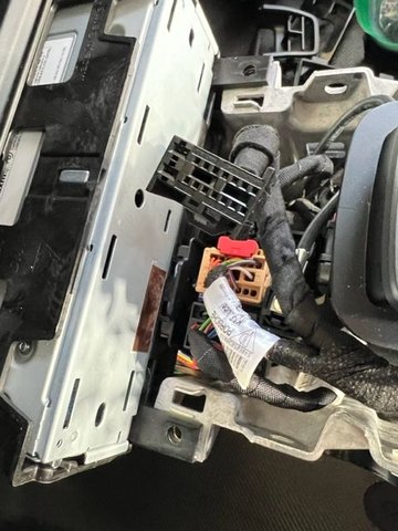

Completed!
I completed the center console install today, it took me 2.5 hours, I have a splint on a finger on one had and 10 stitches in the other hand so my mobility was impacted, it will be easier to pull out all of this trim with good hands. This plug is on the bottom of the part where the AC controls are, do not put out too hard before you disconnect this plug. The plug you see below it with the red part, do not mess with it, there is a smaller plug on the bottom of the trim part where you can disconnect it and remove it from the car.
In the video the guy removes the trim from this part, do not remove it, it is not necessary to remove it. If you do remove it like in the video the switch that controls the sunroof has two small springs behind it, they will pop out and they are hard to find. The only way to get the trim back on this part is to remove the tops of the switches for the two forward sunroof controls, insert the trim and then re-attach the buttons.
Don't forget to swap this piece of gloss black trim off of the front of the old center console before you install the new center console, having to do the install twice because you forgot it is frustrating and embarrassing.
The video is very good for removing the parts of the center console except for the piece mentioned above. Tools needed were a T20 Torx screwdriver (all screws involved a T20), a few trim removal tools and a good work light. I applied some Remington Dry Lube to the plastic trim tabs with a q-tip before reinstallation. This made several of my mistakes less painful when I had to remove some trim pieces for the do-over, they came out a lot easier. None of this trim comes out as easily as it looks in the video.
