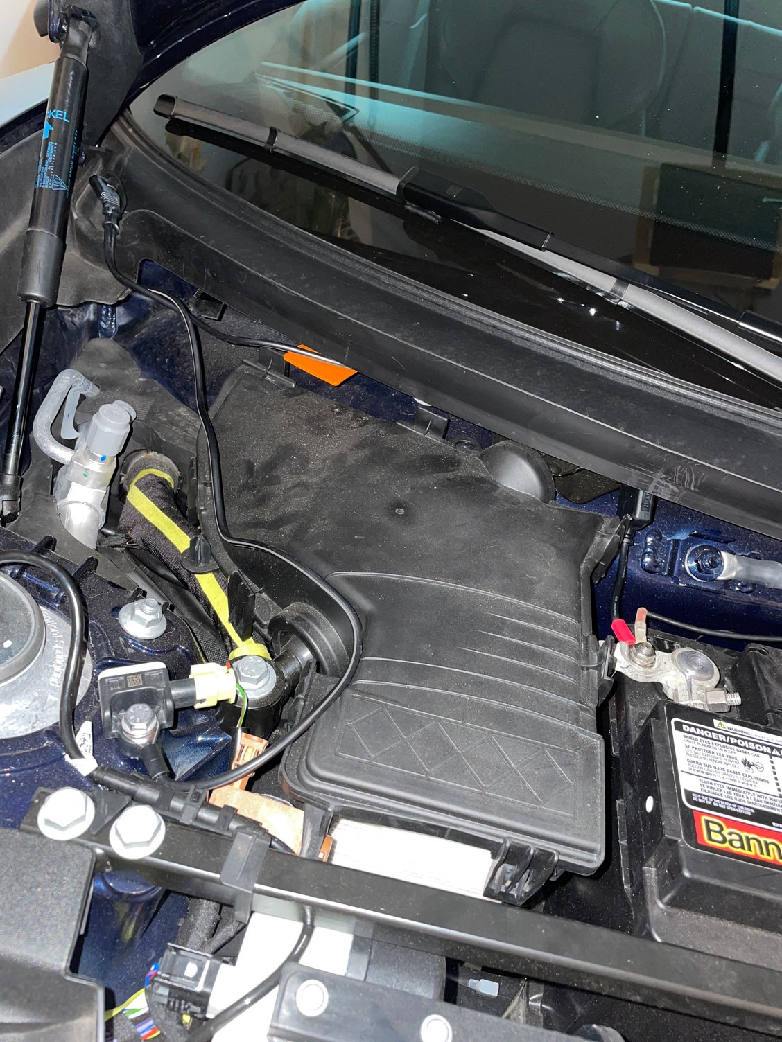

First of all . . . get a "Battery Maintainer"! Do NOT get a "Trickle Charger". Trickle Chargers can and will destroy a battery if not monitored closely, as in every few hours. Battery Maintainers do the monitoring for you and prevent damage from overcharging.
Below is how I ran my connection for my Battery Maintainer.

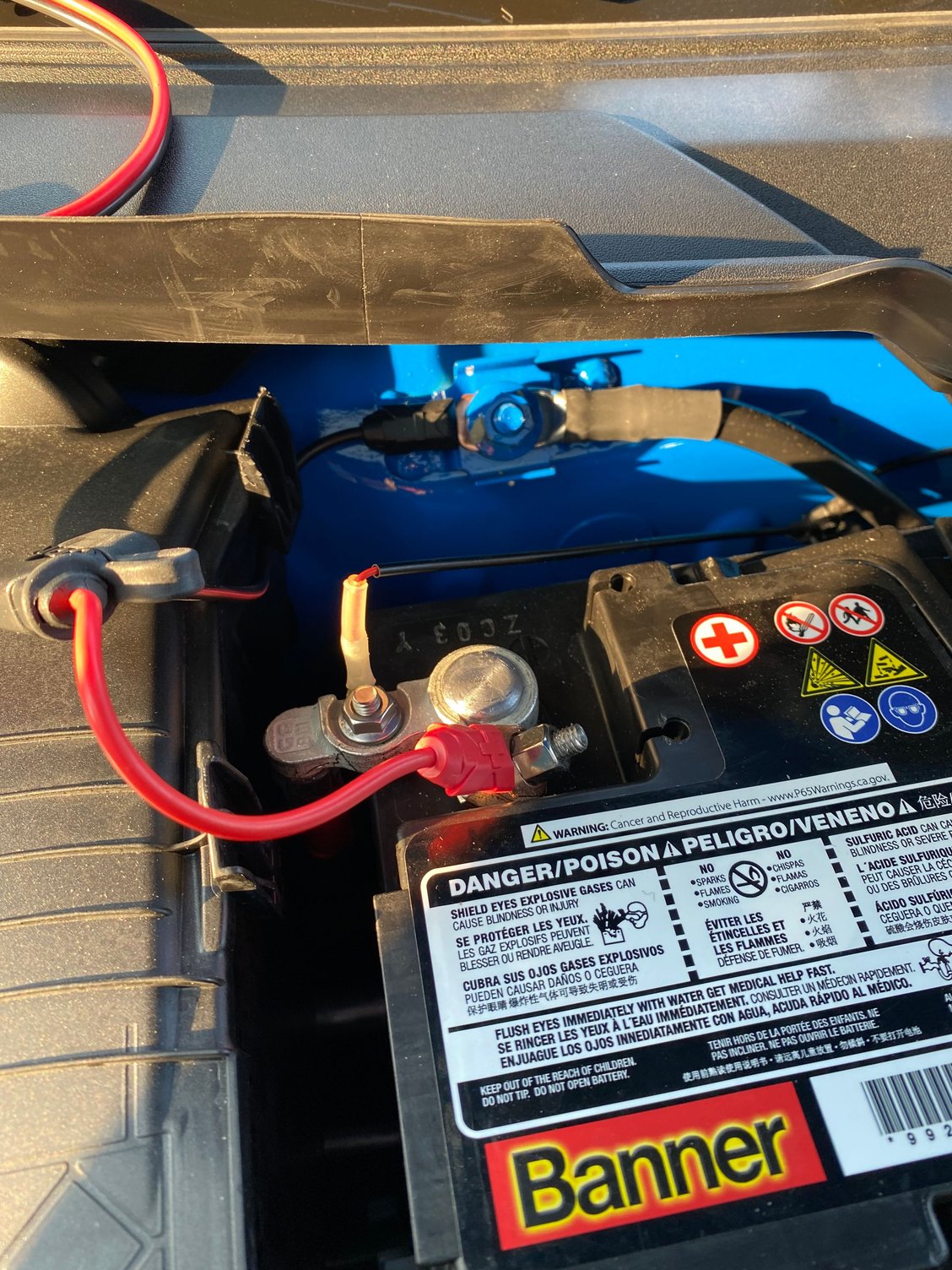

Is that wire a prefabbed cable assembly you are buying from a vendor, or did you have to make it yourself and solder on the connectors at each end?
I bought it off Amazon. My charger is Noco brand, and they make it.
It came with the alligator clips originally.
I realize some people use the socket in the footwell successfully, but the fact that that socket can be switched off, is enough to make me not use that method.

Next level. I like it. But I bet you have some issues
added benefit is if it fails the frunk is open.
+1 on not being comfortable using footwell socket for charging. In addition to shrimp money’s comment, Porsche engineers did not design the footwell socket for this use. I do not like the idea of energizing my wiring harness (and ECU) to maintain the charge in the battery. I prefer to just directly energize the battery to maintain the charge in the battery. The CTEK maintenance through the footwell socket procedure has probably produced more threads on RL than any other.

shrimp money - I noticed you connected to the ground point rather than directly to the battery negative post. The owners manual does instruct to charge with ground point. But almost every example posted show connected directly to the battery positive and negative terminals.

Connecting live and ground ensures the charge added does not bypass the BMS. Can’t see it’s a big deal either way…
It pained me to mess up the pretty blue paint on the nut, but that’s what touch up paint is for. In addition to following the manual, the Noco charging terminal rings aren’t open on one end, like this —-C if you will. The nut on the negative terminal post doesn’t come off, so it would have forced me to cut a notch in the Noco terminal rings if I wanted to connect to the battery directly.
exactly. The captured nut on the negative terminal was all the persuasion I needed to use the ground point also.
