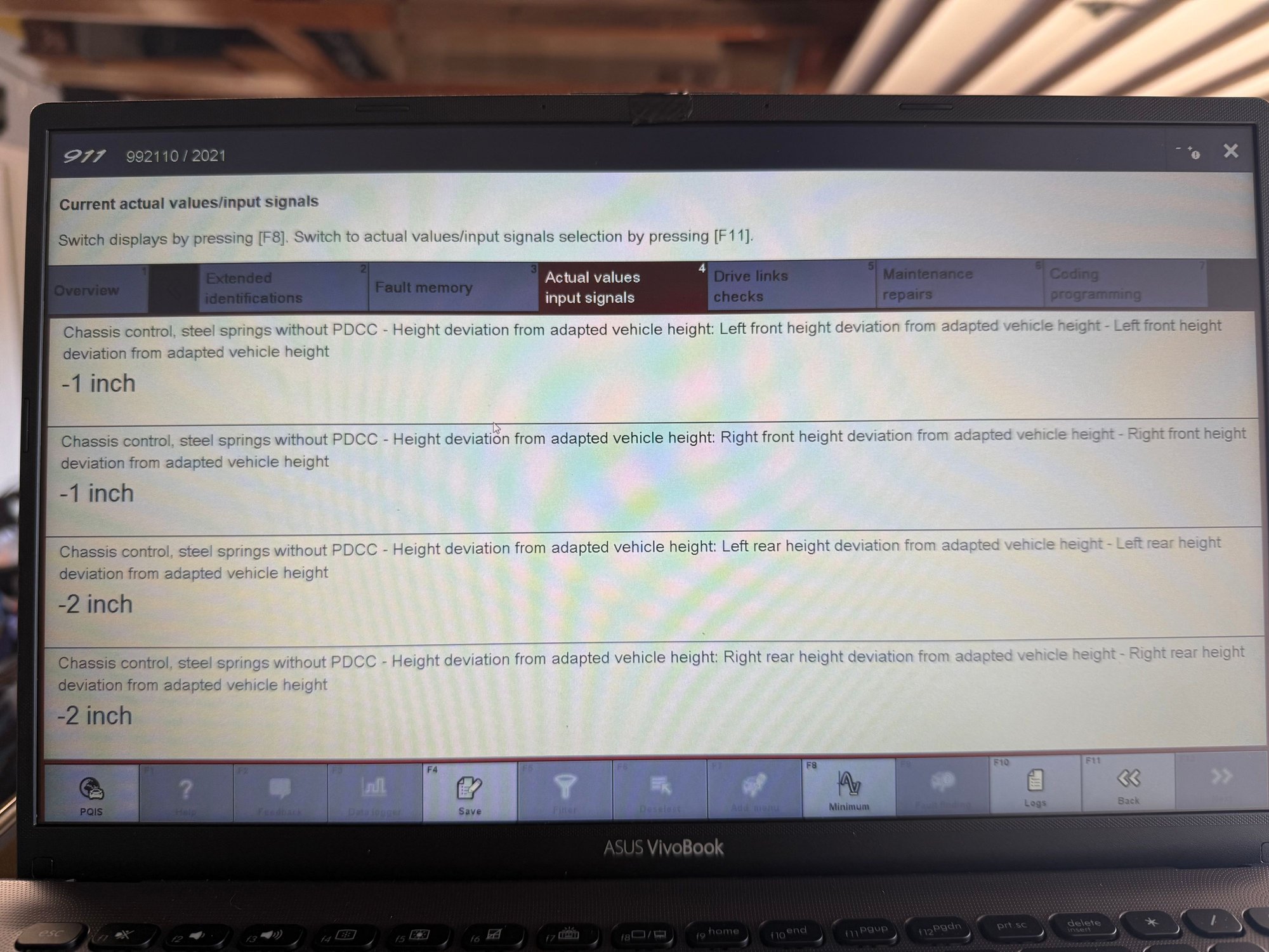

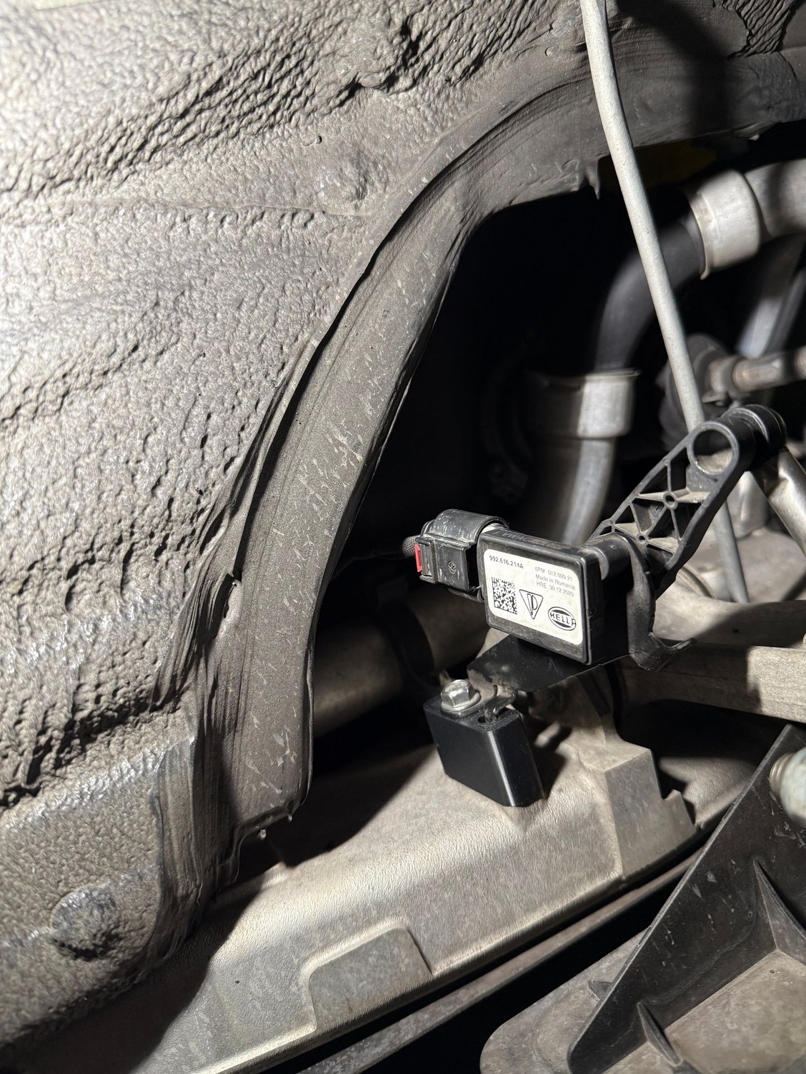

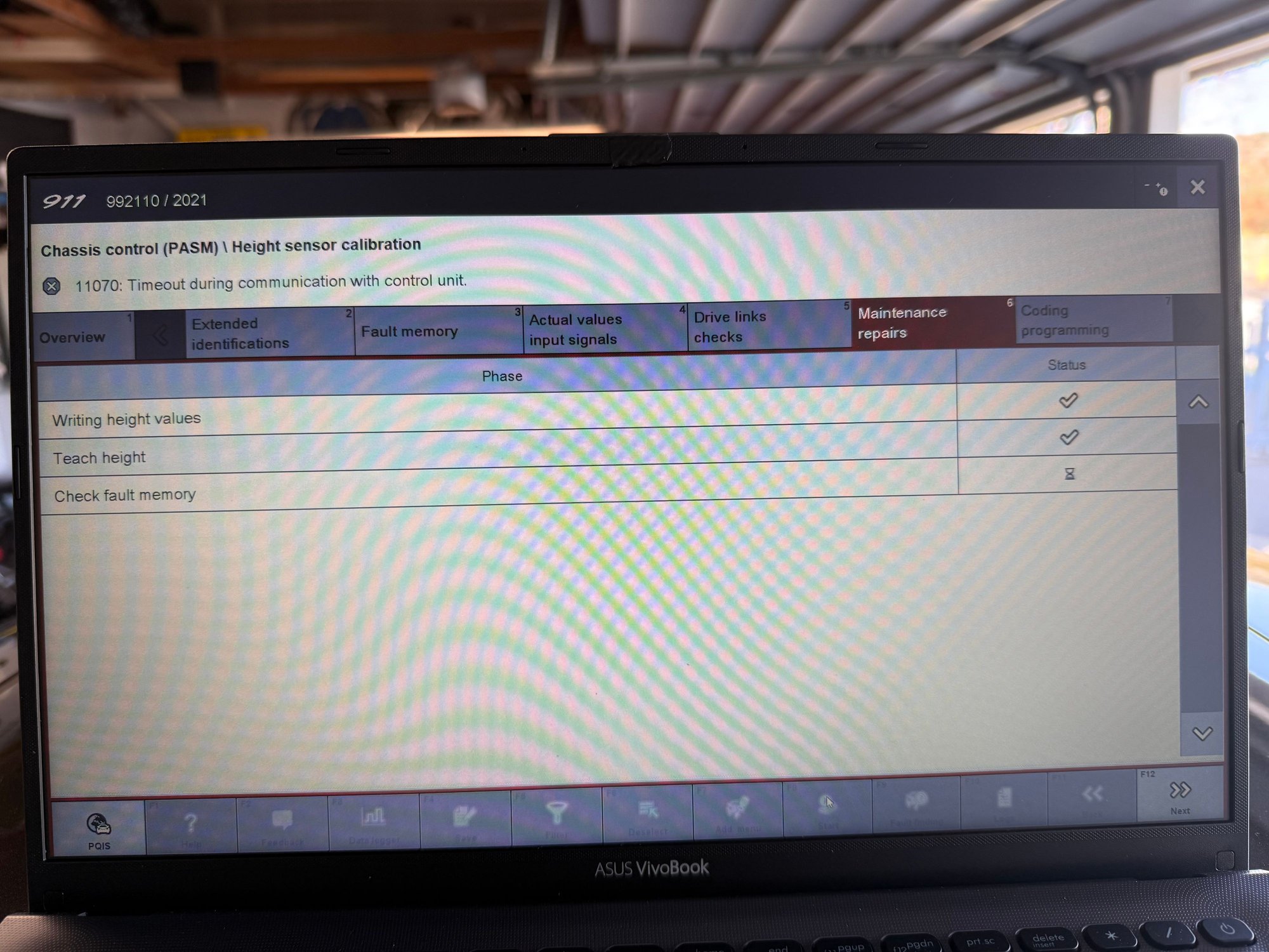

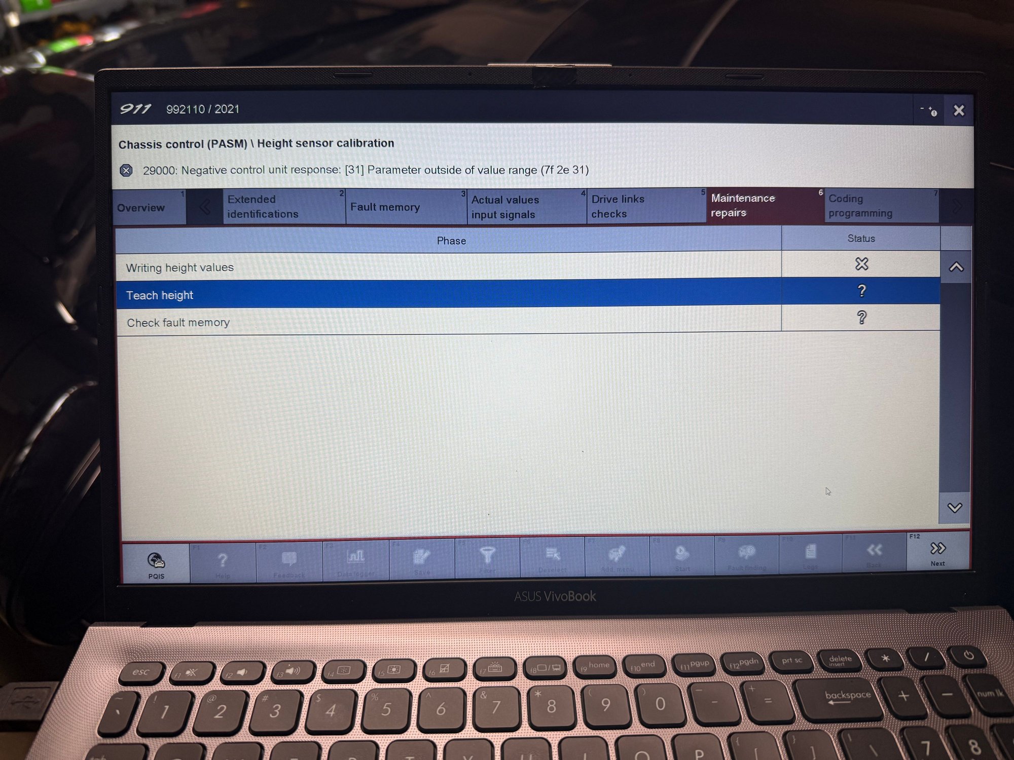

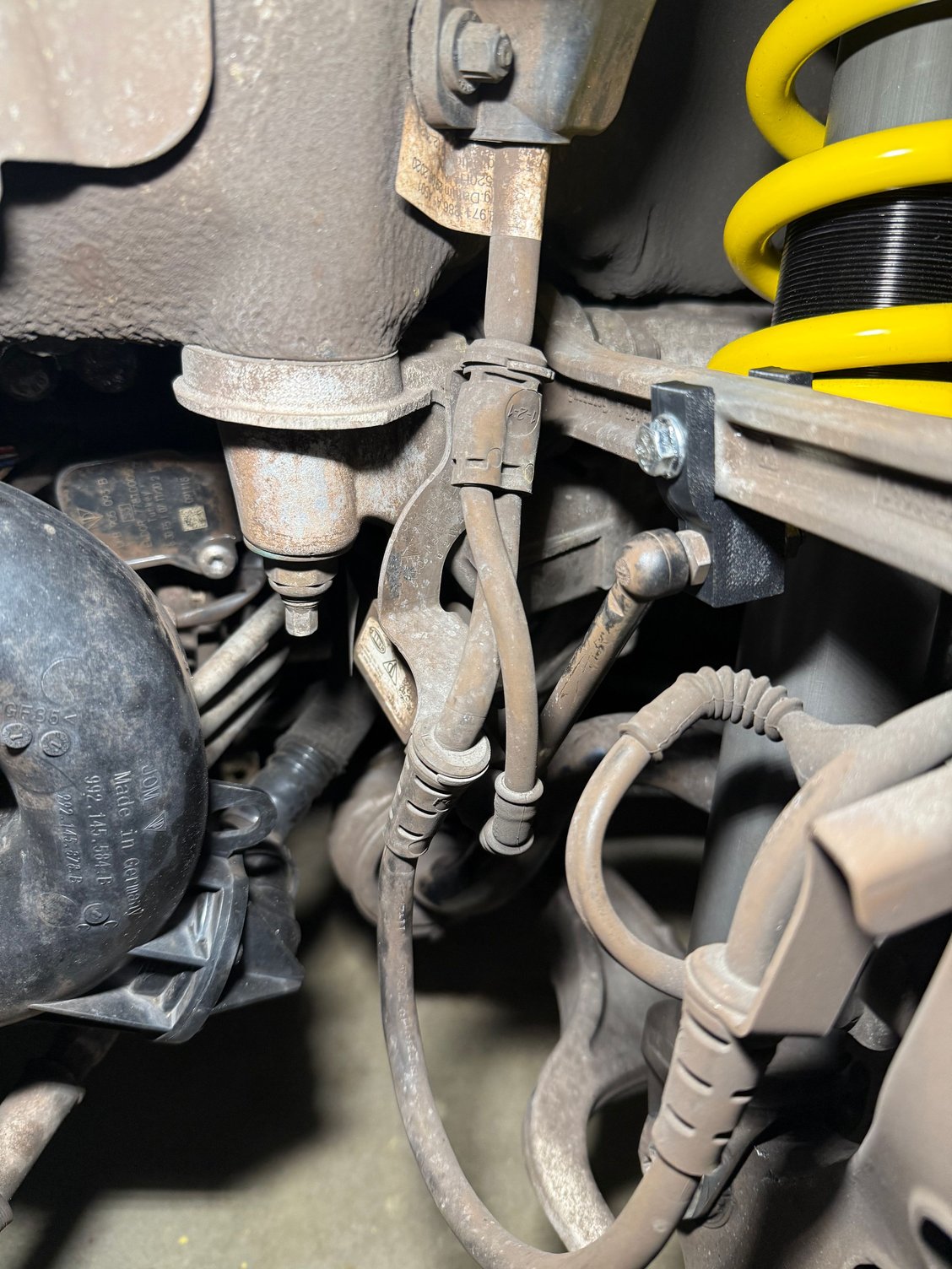

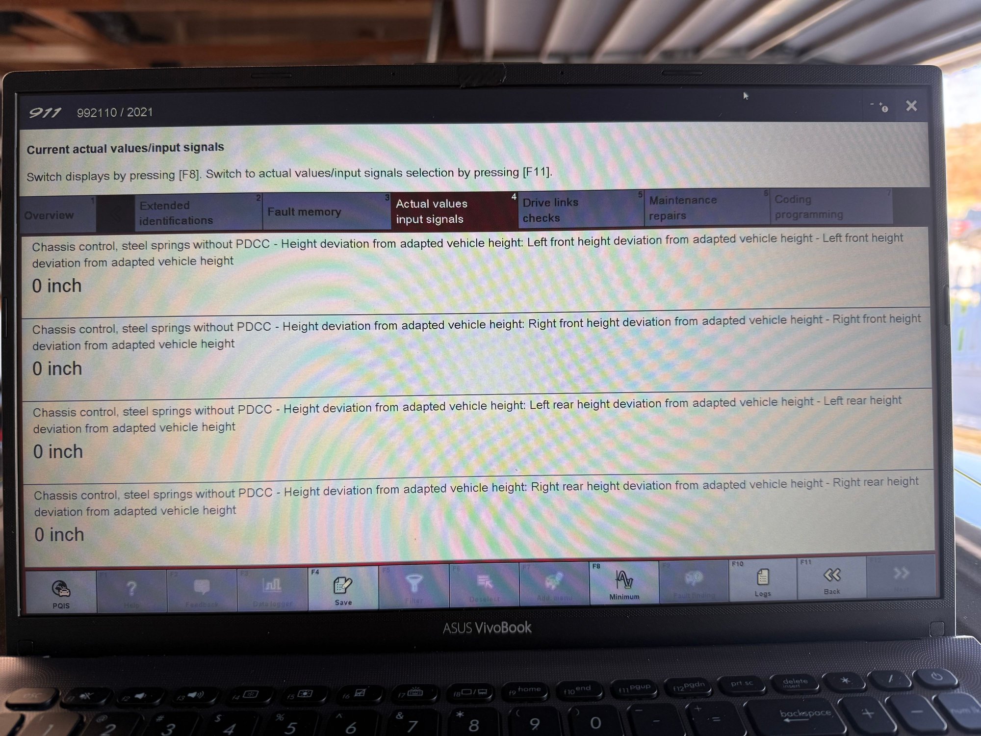

So there were 2 things that made me able to program the ride height sensors after the KW HAS install.
  1. I was able to find the PIWIS 3 software (and corresponding cheap replica VAS 6154 adapter) to use, which has the reprogramming function within.
    1. If wanted, I think I have screenshots from the relearn or "Maintenance repair" procedure?
  2. The rear was actually "too" out of spec to even re-learn, so I 3d printed drop brackets. (also happy to share STL if anyone is interested)

Ended up doing the same thing. I was getting -1 in the front and -2 in the rear.
I couldn’t recalibrate the height sensors because they were out of range like mentioned above.
I ended up 3D printing some spacer for both the front and the rear. They both have a 1 inch spacing.
After that I was able to remove all faults and calibrate the sensors.

Just uploaded mine here!
https://makerworld.com/en/models/253...sensor-bracket

Originally Posted by sullivan1337
Wow. You are a life saver. How many should I get? Are they the same for the front and the rear?
Old Mar 17, 2026 | 10:50 AM
  #43
sullivan1337's Avatar
sullivan1337
Joined: Feb 2021
Posts: 10
From: Pittsburgh
These are only applicable for the rear, so you would just need 2 of them (one on each side)
In my case the front didn't need relocation to program successfully.
