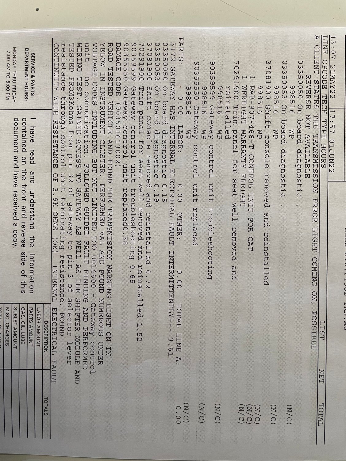

Dropped car off and the techs said they had never seen the error codes. They sent the codes to the engineers in Atlanta. They think it is a transmission module that will be an easy fix when they get the part from Germany in 7 to 10 days. Have a nice Macan loaner which my wife likes, thankfully you can’t buy one.

Fixed, turned out to be a pretty big deal.
