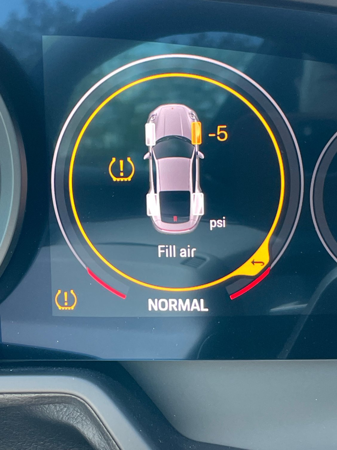

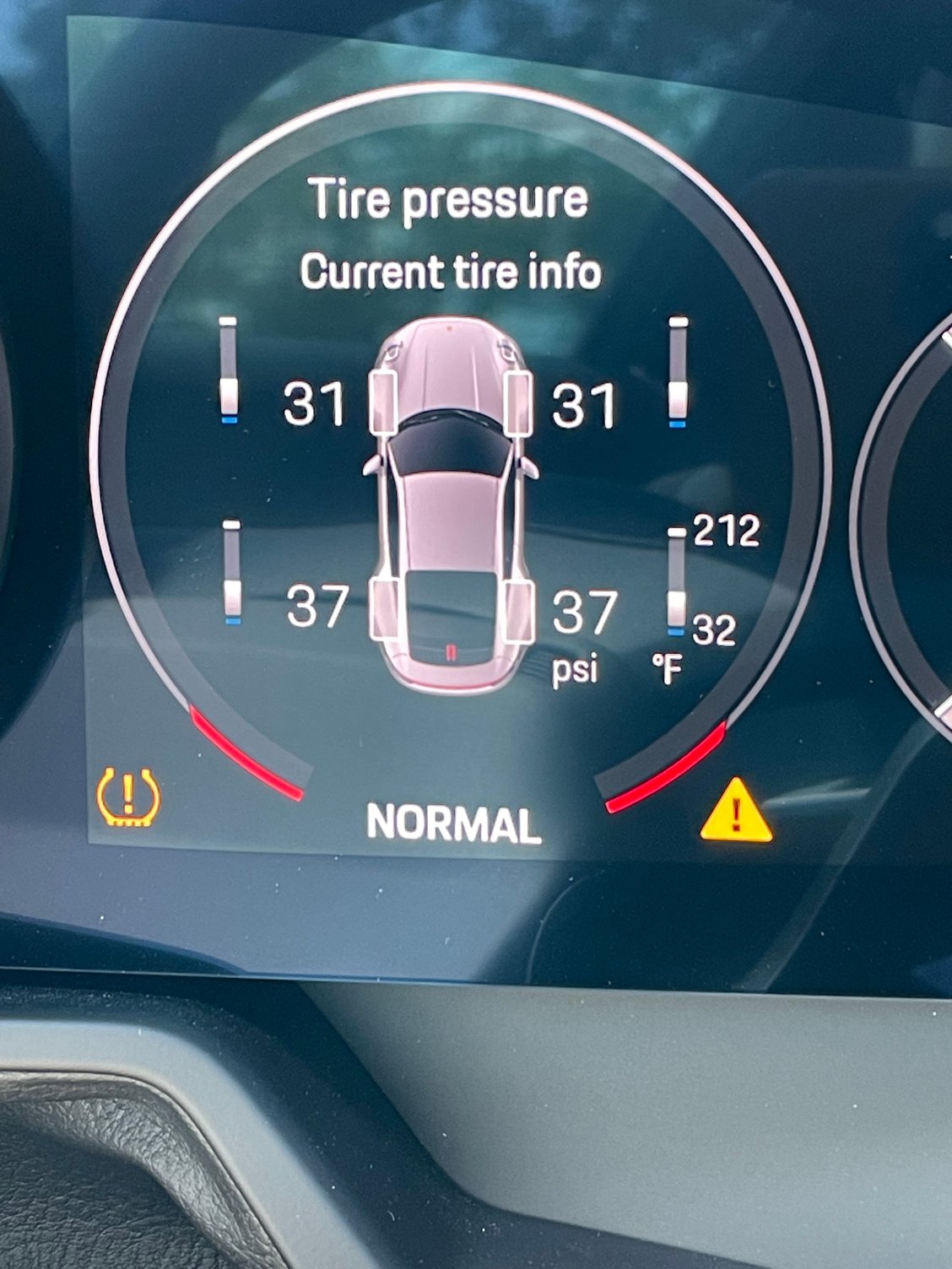

Not too sure if this is real or not. One screen gives me a warning but monitoring says we’re ok. Can’t check with a gauge until this evening but should this reset itself or is there a reset I can’t find?
I check these every time I drive and they are consistently on 31 front / 37 rear.

You may have a flat. I would keep an eye on it.
may have picked up a nail on the way into the office.....

Is your PCM set to comfort? Otherwise I think it would give this warning.

I set it to comfort at lunch, and the warning went away. Neither of the options (comfort or fully loaded) were selected in the PCM and this is the first time I've gotten the warning with consistent pressures.

On 911 GT Cars you can set/select your own tire pressure warning via race setting.
Totally annoying getting low pressure warning continually on my turbo!

All normal this morning at startup....
30....30
36....36
up 1 by the time I got to work.
