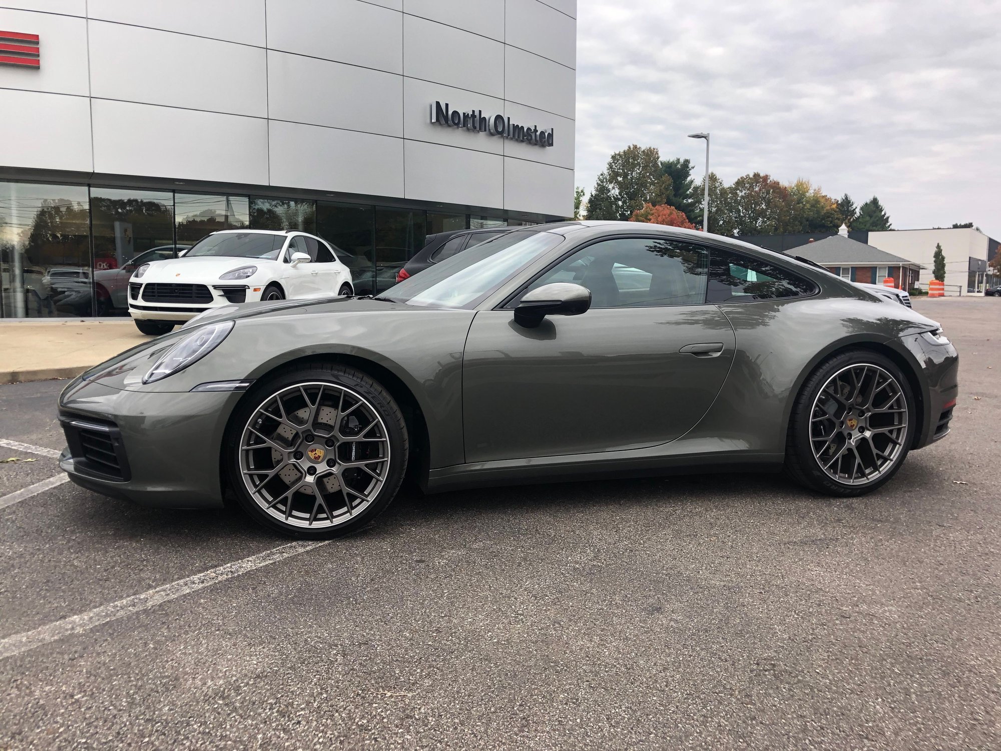

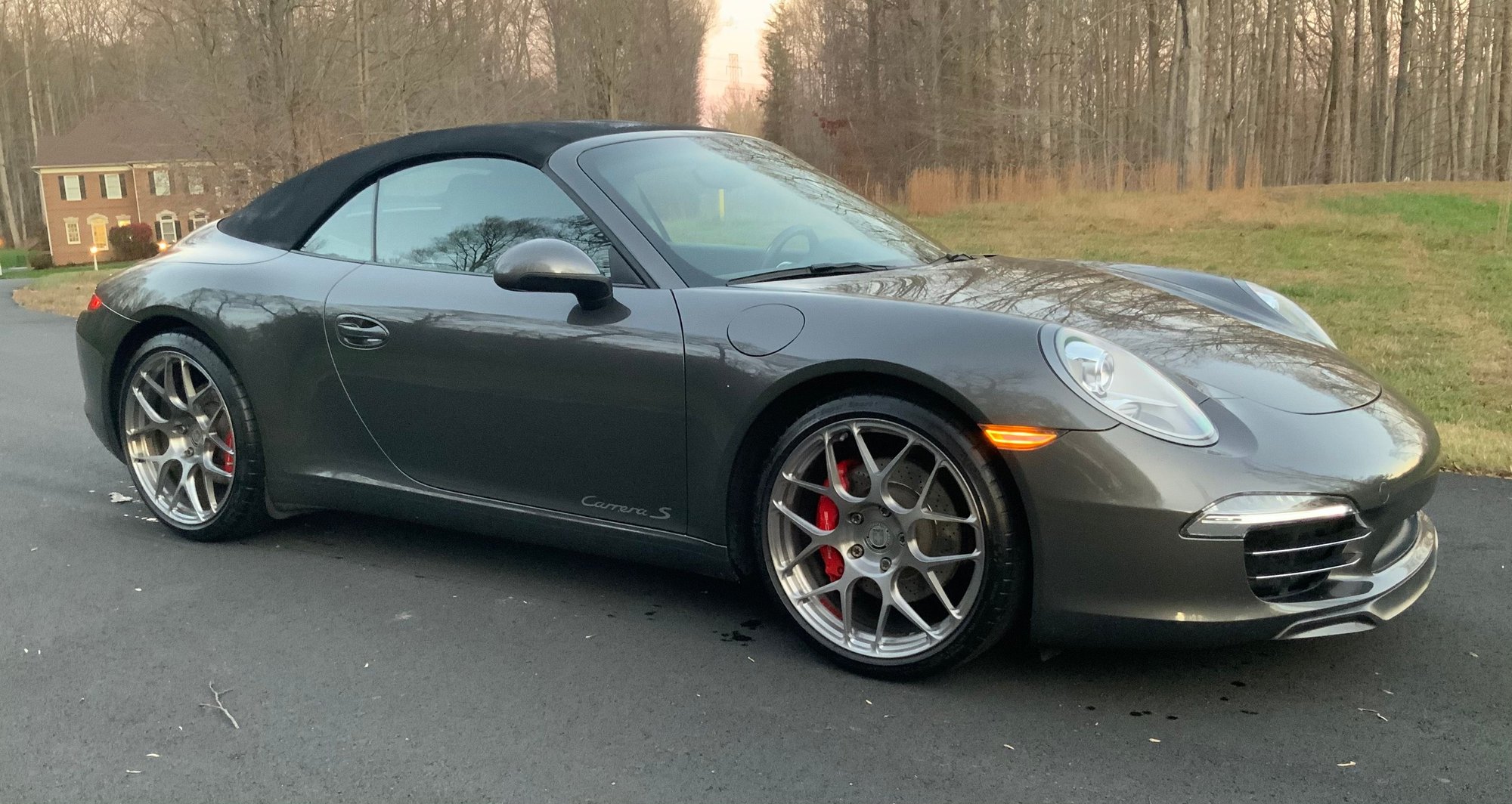

My 991 I painted the PASM lip I got from Suncoast, several times.....whack it, paint it.
I got the Adventurine Green in the Coupe. Looks fabulous in the Cabriolet !

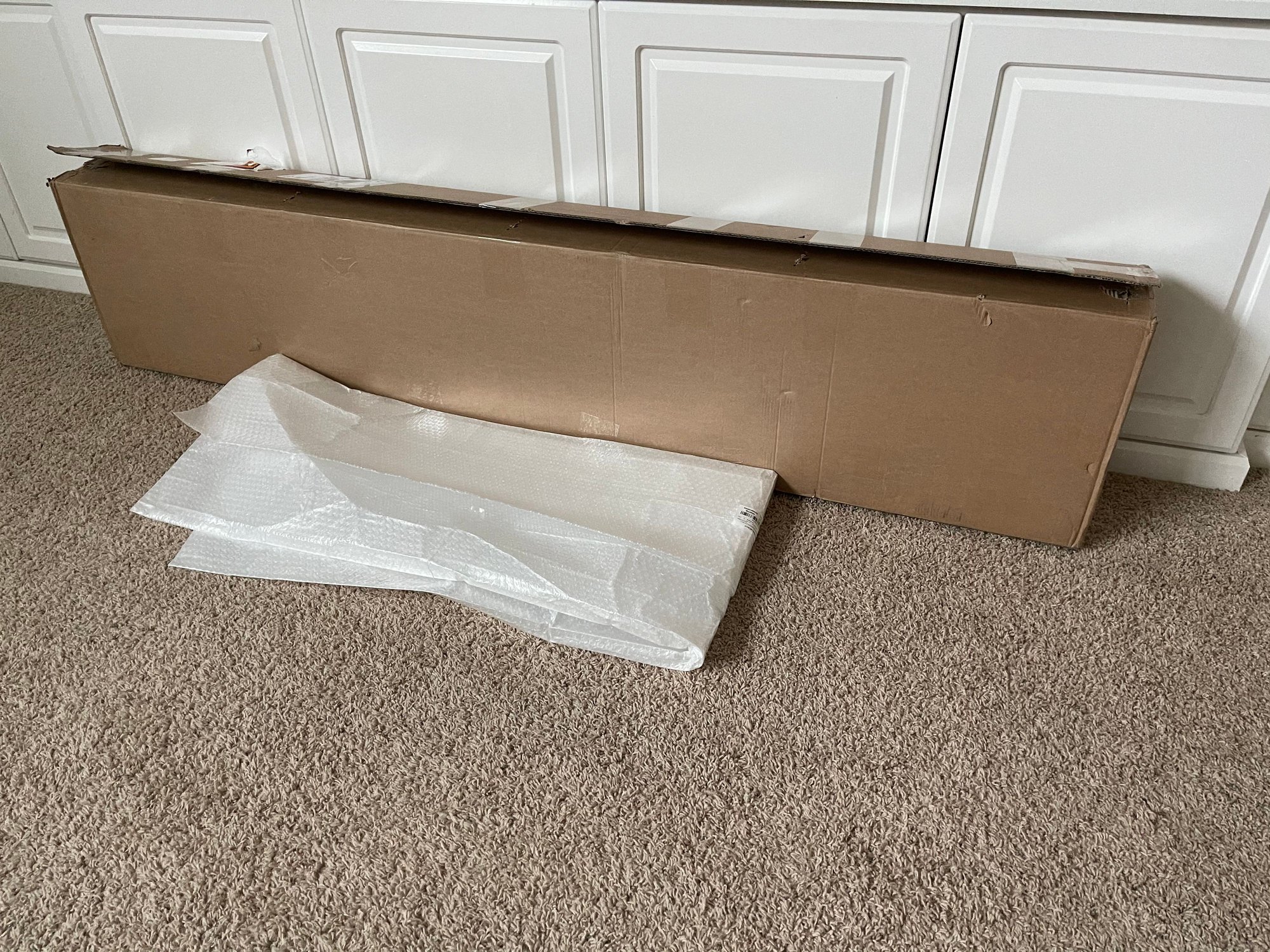

Originally Posted by Bluehighways
If/when you go to buy this spoiler, be sure to pay attention to the shipping cost. Due to it's length it probably makes for one very expensive item to ship. Some on-line dealers showing upwards of $50. Wow!
$42 from Suncoast. Box is huge.

It came in a huge box but shipping was free. For good measure, I threw in the gas cap HAHA.

As you get a collection of these the box is a good place to store the old ones….

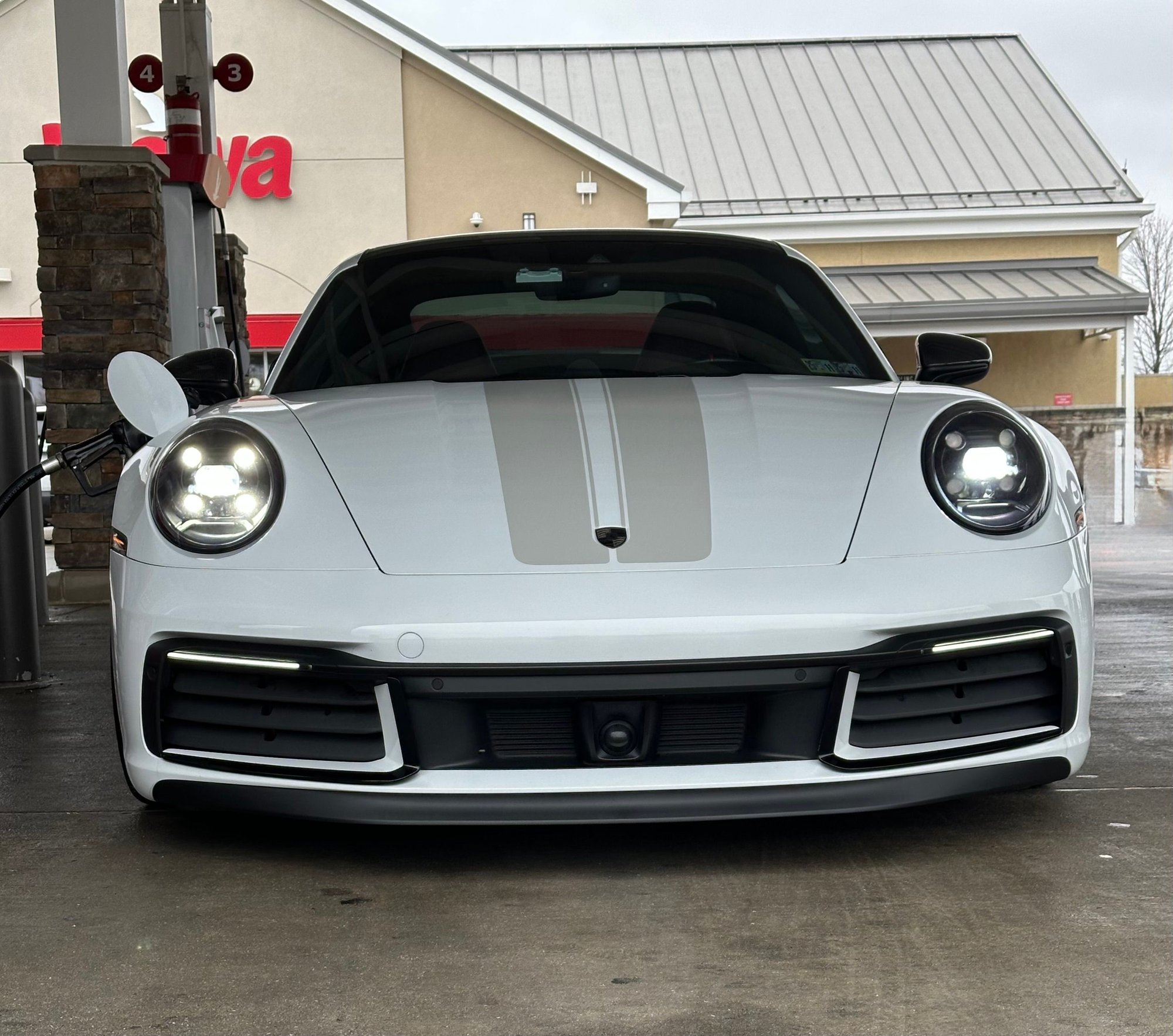

I recently replaced by SPASM front lip - something nice about brand new even though most wouldn’t notice the scrapes down there. Borderline OCD? 🤔😁
For those wanting to avoid shipping - see if your local dealer will price match an online price. Mine did.
