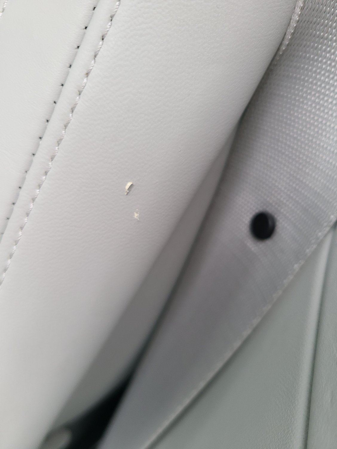

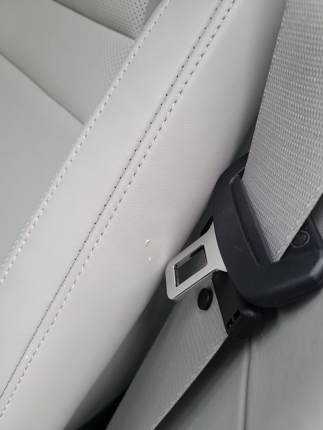

A little dramatic but I think somehow the seatbelt knicked by leather seats causing this damage.
Any suggestions on how to repair it? You think this is normal? The car is only a month old. Surprised this happened.

I've done that on a previously owned 911...the culprit was a zipper on my jacket. I don't think there's anything on a seatbelt buckle that would do that.

If you have the power seats (14 way or 18 way) , did you move the seat backward when the seat buckle was in-between the seat and the rear b pillar trim panel? I think I did a bit of damage to my rear b pillar trim leather this way as the seat goes very far back and applied pressure between the buckle and the interior rear trim (small dents in the leather). Luckily , I also have an unrelated weird manufacturing defect on that trim panel, and my dealer managed to get it covered under warranty because of that. Now, I always hold the buckle out of the way when moving the seat back and I gently release the buckle when unbuckling. Ironically, I was in the habit of moving the seat back to avoid putting wear and tear on the seat bolster

An auto upholstery shop can "fix" that w/a colored filler.
BUT there's no guarantee that the filler w/stay afixed to the damaged spot BUT since it's on the side of the seat, you've got a good chace of the fix working because there shouldn't see too much flexion that would pop out the filler. No way to know unless you try it.
The other "problem" with this kind of fix is (like touch up paint) the color match may not be "perfect." Just depends on how much it bothers you whether it's worth trying to fix or not.
I've got some small "odd" cuts in the driver's seat of my MB SUV that I thought about fixing in this way but figured the filler wouldn't stick becaues I'm constantly getting in and out of the seat. Only real solution would be to recover the seat and it's NOT that big a problem to me.

My 2020 car did this because the seat belts were installed with the wrong twist to them. Porsche recovered both seats and fixed the belt. Issue has not recurred since. If the buckle tends to get trapped then the seat belts are the culprit.
