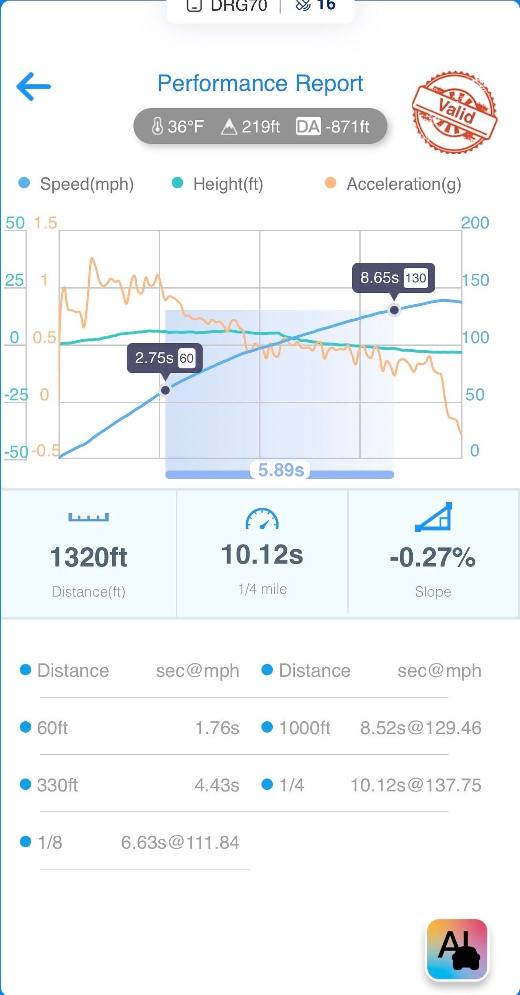

This was more of a curious run. I estimated 685whp - 710whp Dynojet based on 8-12% variance.
Last run was with 3 fans in the back and 5 in the front.
The power band seems to flattened around 4200-5500rpm as if its pulling timing. I have to do some data logging and see what's happening. This is a OTS Softronic tune.
The pull looks to have been done in Auto mode and you can hear the car upshifting, instead of running it on manual mode and hitting limiter.
Car is running 5.8 60-130mph so it pulls fairly well.

Very strong ! Any Draggy runs in the 1/4 ?
Yes. Posting below.

Best draggy. This was 36F, rainy and with winter tires.
I also let go at the end since I was approaching 140mph.
