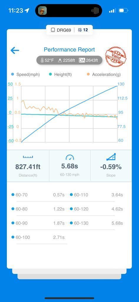

Finally had time to do the clutch relearn. The car seems to be shifting a bit harder and possibly faster.
The DA finally came down here too so I did some 60-130 hits to see if there would be an improvement. 60-130 came down a bit, surprised me some. I’ve been running a different pump gas 93 shell, so far it seems better than 94 here.
Going to load up that ms109 tune tomorrow and see if that trans error when shifting into 4th is gone now.
This run is stage 2, with 93 Oct pump gas.

This is absolutely outstanding! My next mod!!

My mustang coyote buddies swear by shell 93 (Canada). I gave it a try and zero timing retard in my logs, but it was also at night and ambient was 14c… cooler air may have helped too.
Max I started with a generic M Eng tune and have been working with Scott at M Eng to revise and tweak the tune. I think we did about 4-5 revisions. I send Scott a log and he sends me back a new tune after he tweaks it. I’m running about 28.5 degree of timing and ~24.5psi of boost on the top end. (If I’m reading the manifold pressure correctly minus atmospheric).
I noticed on my logs from lastnight with the better DA and I made another 1.5psi of boost. That would help explain why the 60-130 improved. (I think along w/ the clutch relearn).

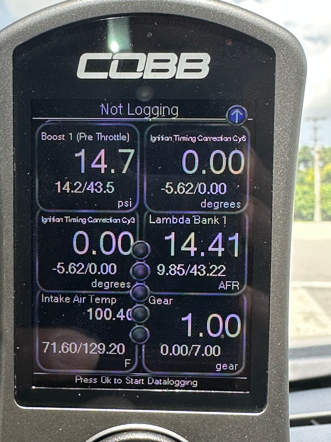

Huge proponent of Meth on this platform - specifically because of the huge IAT benefits. Case in point:
It’s hot as ***** out here in South Florida, but I can get a 50 degree drop in IAT’s. The difference is staggering, but the temperature drop (combined with an increase in effective octane and to a lesser degree some added fuel) enables a more aggressive tune. The intercooler upgrade does not add power by itself, but does allow a more generous tune because the aftermarket intercoolers reduce heat soak longer and more effectively than OEM parts (theoretically better than OEM because Porsche OEM is very good). It’s so hot here so much of the year, I view Meth as almost a safety mod for the motor. I see you’re doing all your mods yourself - I respect that. It’s not my approach though, especially when it comes to the Meth install. I wanted an absolute professional to do that work because I wanted the most flawless install possible for such a game changing mod, and what could also be the most catastrophic mod if done wrong.
Looking forward to your results in the real world. I’ve seen videos of others with the 992 and Meth and turbos, and I was disappointed by their numbers. Hoping to see your candid, progressive approach yield better results.
