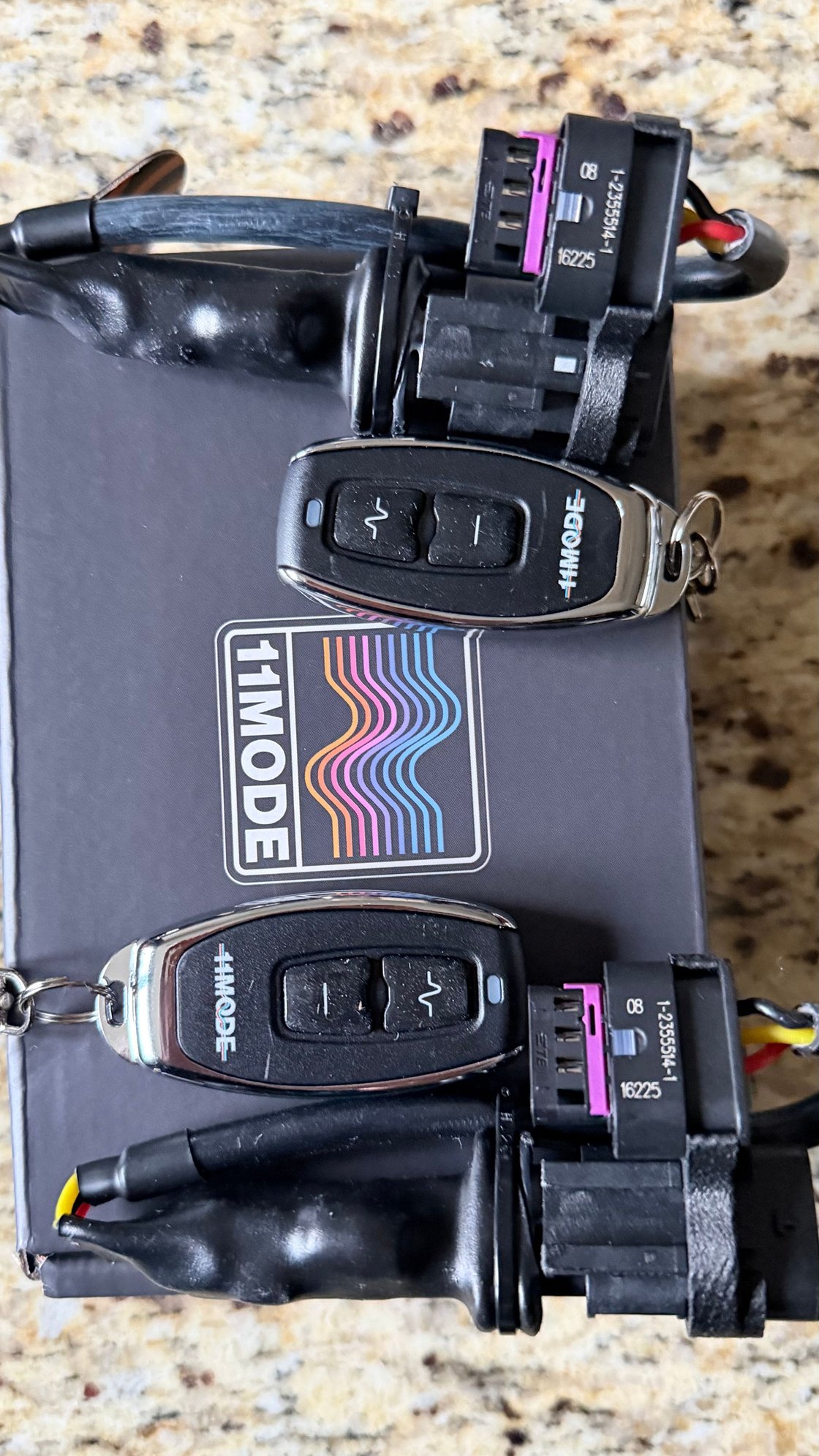

Installing later today

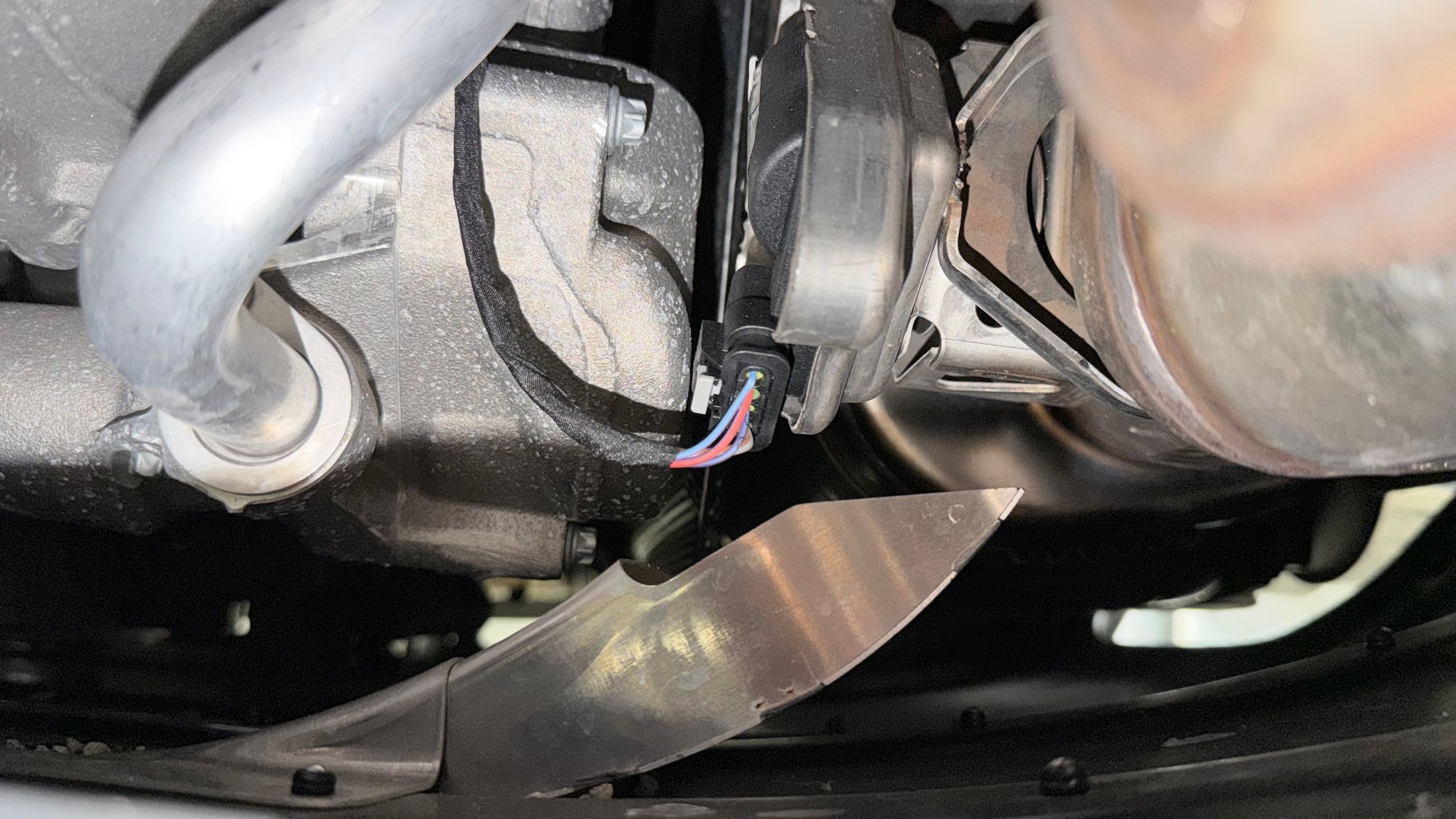

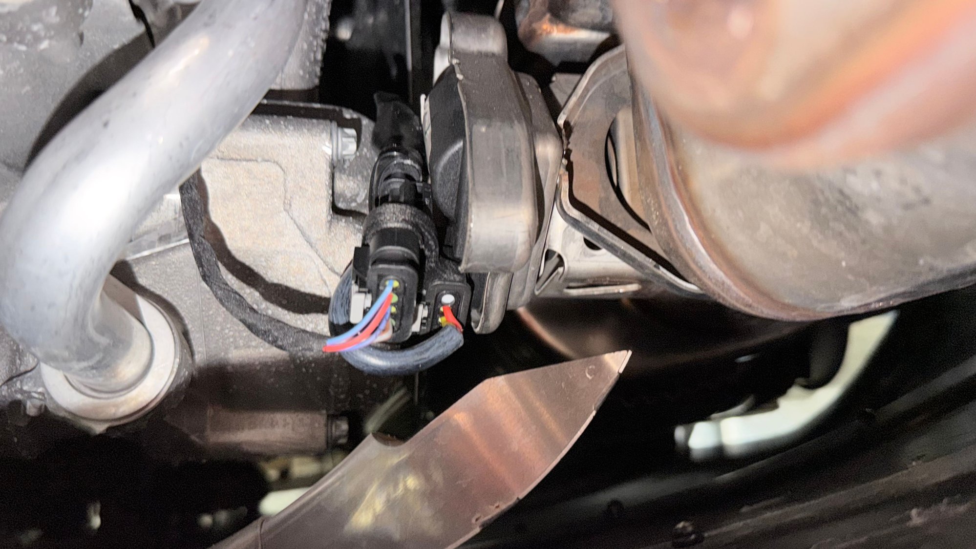

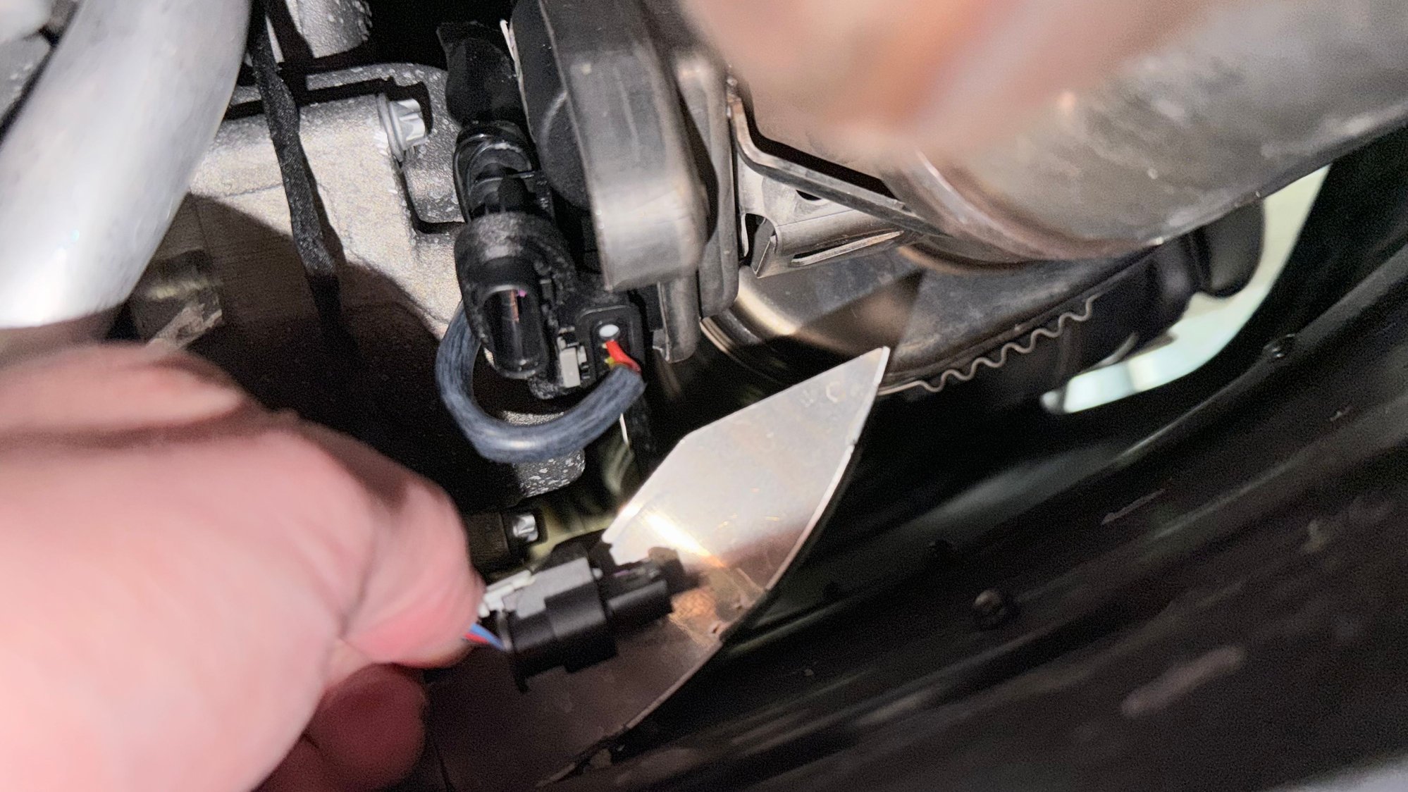

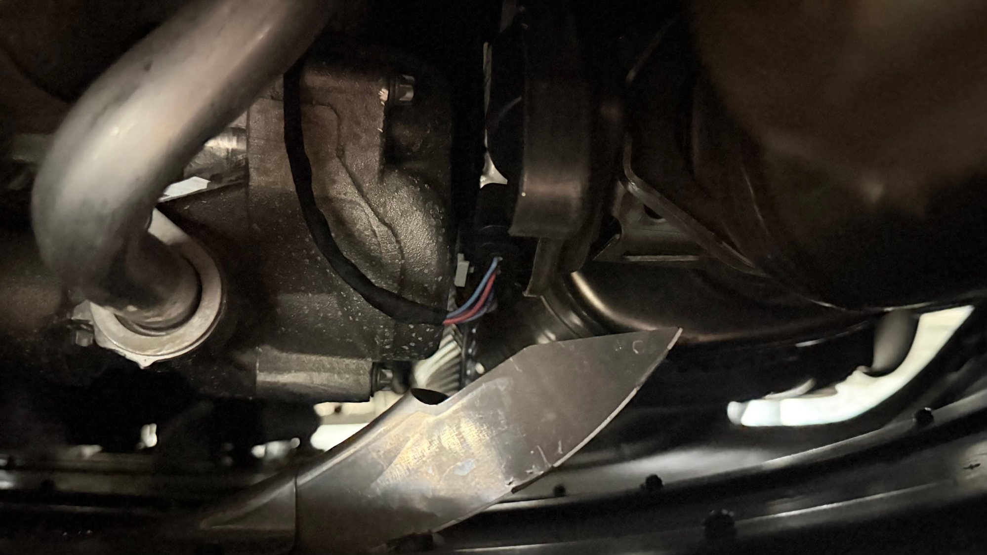

Drivers side pictures.
maybe 30 seconds to install?
passenger side a little bit more difficult, as the tab is facing inside. Not impossible. Long nose plied helps. No lift or diffuser removal.
more noticeable idling and cold start. From 1-3k rpm a deeper sound comes to live. Mixes up as the revs go up to the usual. As expected given valves fully open normally after that.
worth the money and effort. Easy to reverse. No fiddling with the engine bay. Homelink successfully programmed.
