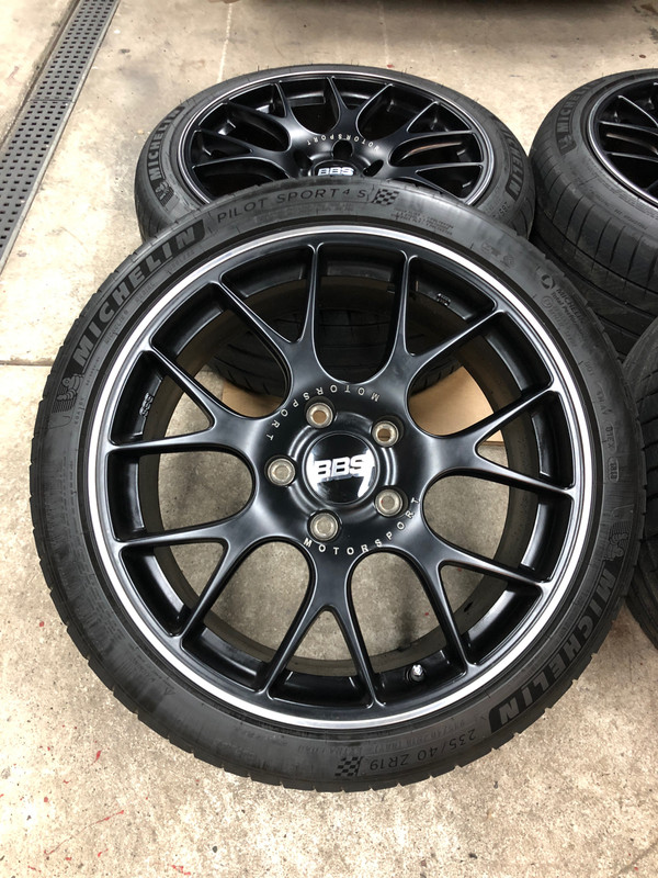

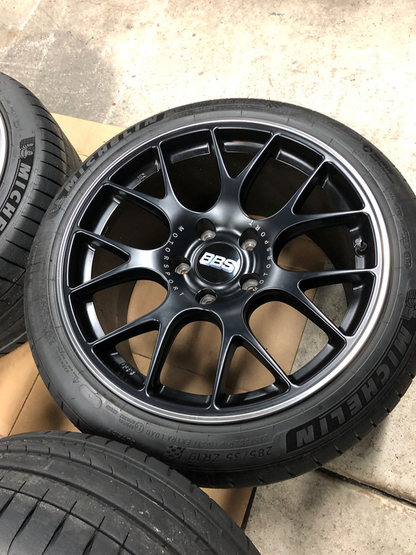

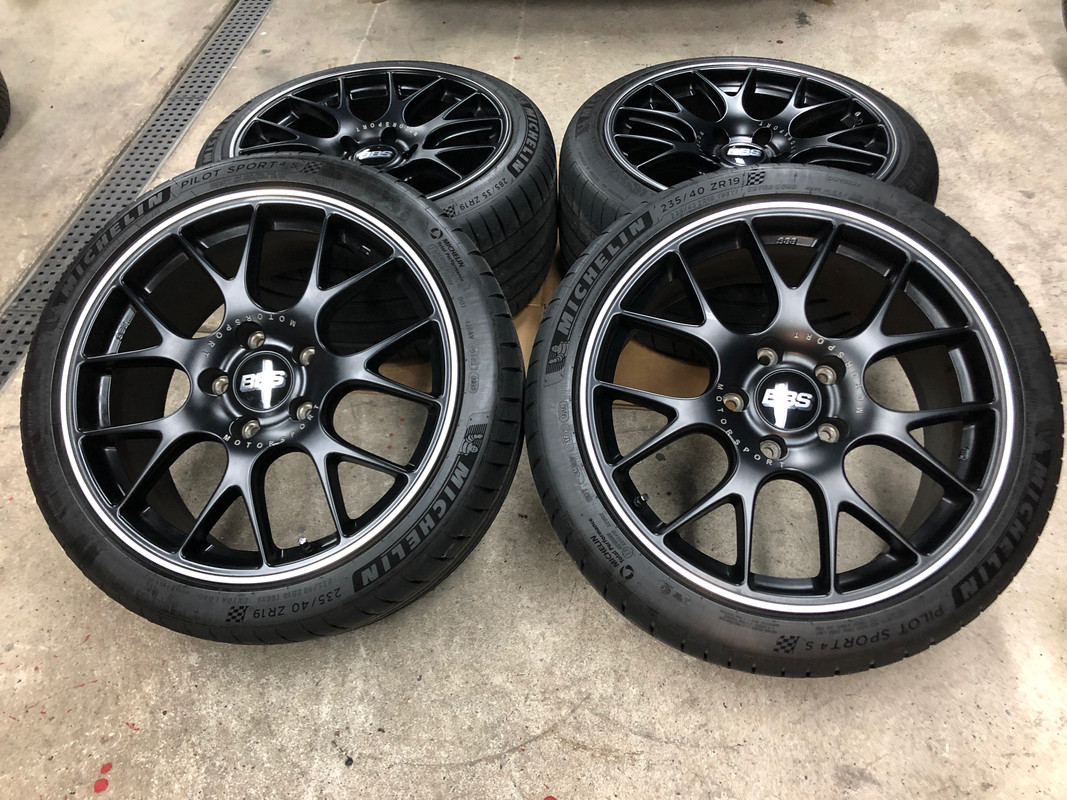

Originally Posted by 05Mdriver
I have 991 track wheels / tires for sale..
Satin Black BBS CH-R with Michelin Pilot P4S for 991 Porsche.
Wheels are: 19x8.5 et 51 and 19x11 et 56
Tires are : 235/40/19 and 285/35/19.
The set was used for a few hundred street miles and (2) 20 minute track sessions. Tires have approx 9/32 tread remaining (90%)
No curb rash / never refinished.
TPMS is installed.
3250 picked up outside phila. Will ship as well.
05mdriver@gmail.com
These are not the right sized wheels or tires for 991 cars...using wrong overall diameter tires front and back ratio you will have issues with PSM during braking and acceleration out of corners.
Old Oct 26, 2018 | 01:49 AM
  #30
mgordon18's Avatar
mgordon18
Joined: Dec 2009
Posts: 1,710
Likes: 332
From: Central Jersey
Not sure why you'd say that. This is the exact 19" size Tire Rack recommends for winter tires. Would it be different for track use?
