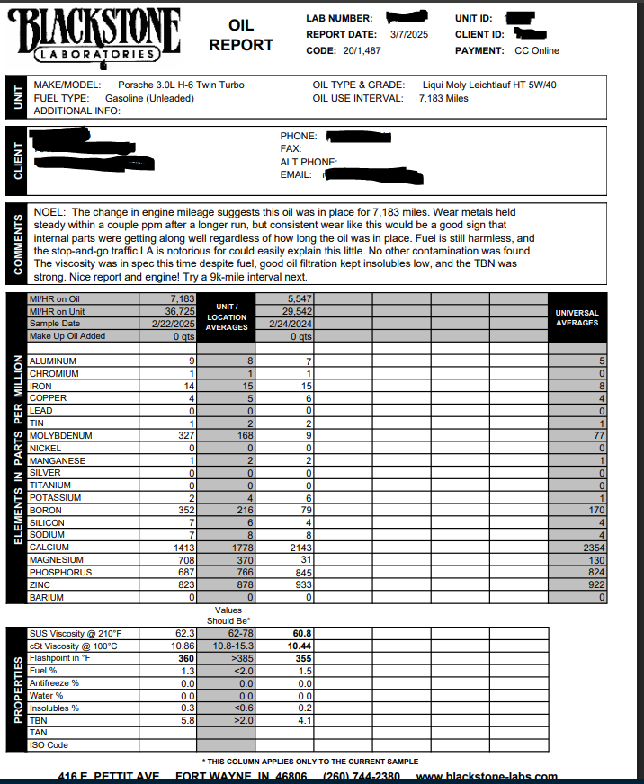

My 991.2 is a daily driver... so not quite apples to apples comparison but a data point nonetheless. I bought my C2S in May 2023 and I've done 3 oil changes - initial upon purchase, Feb 2024 and Feb 2025.
From the Feb 2024 report, Blackstone said to try going to 7k.... and I did. See results below. I plan on going another 2 or 3 months until the next oil change --- I'm currently about 3k from 45k.
Personally, I wouldn't worry about the time and wait out until the year is up (or longer).

Your aluminum and iron are way too high IMHO. Your TBN is too low. Your viscosity is on the low end.
Blackstone will always compliment your values. But as far as I'm concerned you kept this oil for too long.
