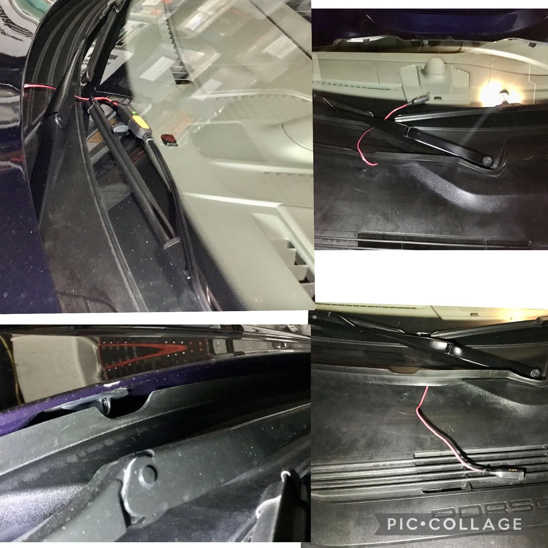

Originally Posted by tiiger
If you use one of the CTEK/porsche chargers, can't hurt to get one of the little quick-release adapters that allow you to hook directly to the battery, then you can run the cable out the back of the hood (near wipers), and close the hood if you need to (i tend to leave the hood cracked open, but that's just me)... anyway very clean and no cable pinching in the windows from cig lighter connection.
https://www.ctek.com/us/battery-char...ect-eyelet-m10
That's exactly what I did ...
