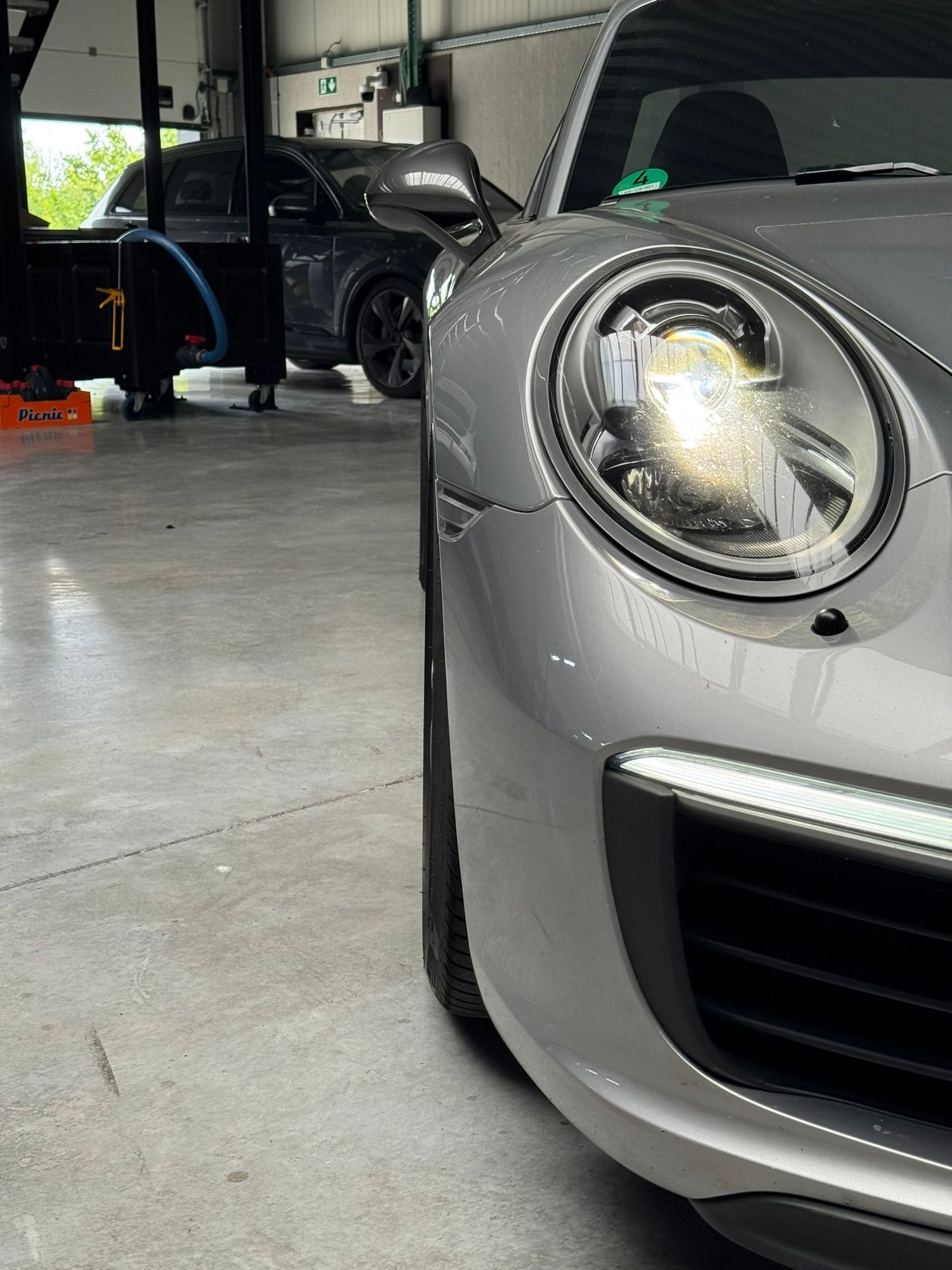

I mounted OEM 996 GT3 LCA with 15mm spacers.
Used the offset hole on the LCA together with std tension arm.
Car is a 2018 Carrera T running KW HAS
Alignment is right where I wanted to be

Old Aug 25, 2025 | 06:49 PM
ghhally's Avatar
ghhally
Joined: Aug 2006
Posts: 707
Likes: 52
From: Belgium
Originally Posted by F355bob
do you have 15 mm wheel spacers or 15mm LCA shims?
No spacers, 15mm shims on LCA

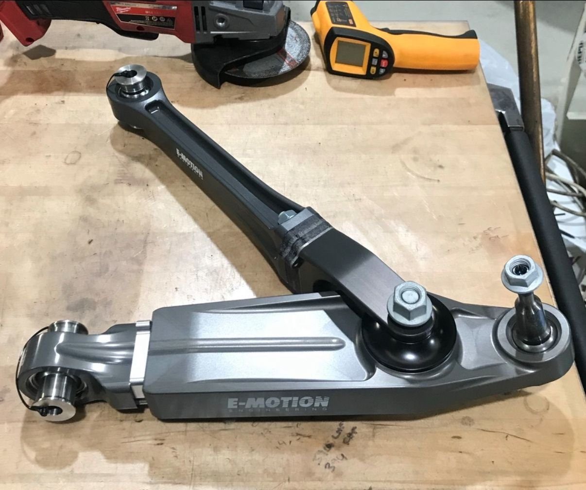

4 Point 0's Avatar
4 Point 0
Joined: Aug 2017
Posts: 2,572
Likes: 1,524
E-Motion
E-Motion
You can see the two shim stacks on my setup above.

Originally Posted by 4 Point 0
E-Motion
E-Motion
I have the same setup. I didn’t need the longer tie rods, I had enough thread. Did you use longer tie rods with the spherical bearings? Any difference in steering feel?
So, the one and only thing you changed is the LCA and you adjusted the camber at the strut tower top?
How much camber have you dialed in?
Old Aug 27, 2025 | 04:36 PM
ghhally's Avatar
ghhally
Joined: Aug 2006
Posts: 707
Likes: 52
From: Belgium
Correct, with 15mm shims and the strut maximum pulled outward, I have 1.4° camber
