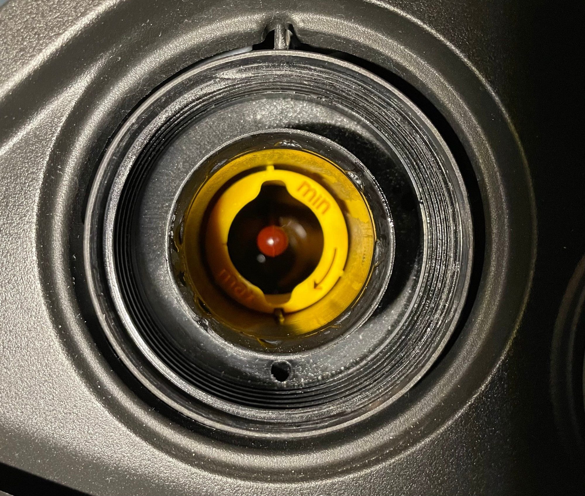

You could also just have an air bubble floating around in your coolant. Have you looked at your Coolant float level. the ball should be in the middle. If the ball is not in the middle fill accordingly. Drive around a bit and see if message reappears. Check the easy stuff first.
