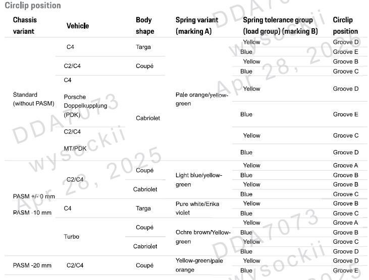

Originally Posted by LordDRIFT
From what I’ve seen the spring seat has several static positions .
You are correct, as it is to adjust the proper preload on the spring based on the chassis and what suspension option you have, as you can see here:
So while you "could" manipulate this perch, the hassle of getting to it to decompress the spring you might as well just get a properly sorted spring kit or coilovers. Sorry, the cheap way just isn't the good way.

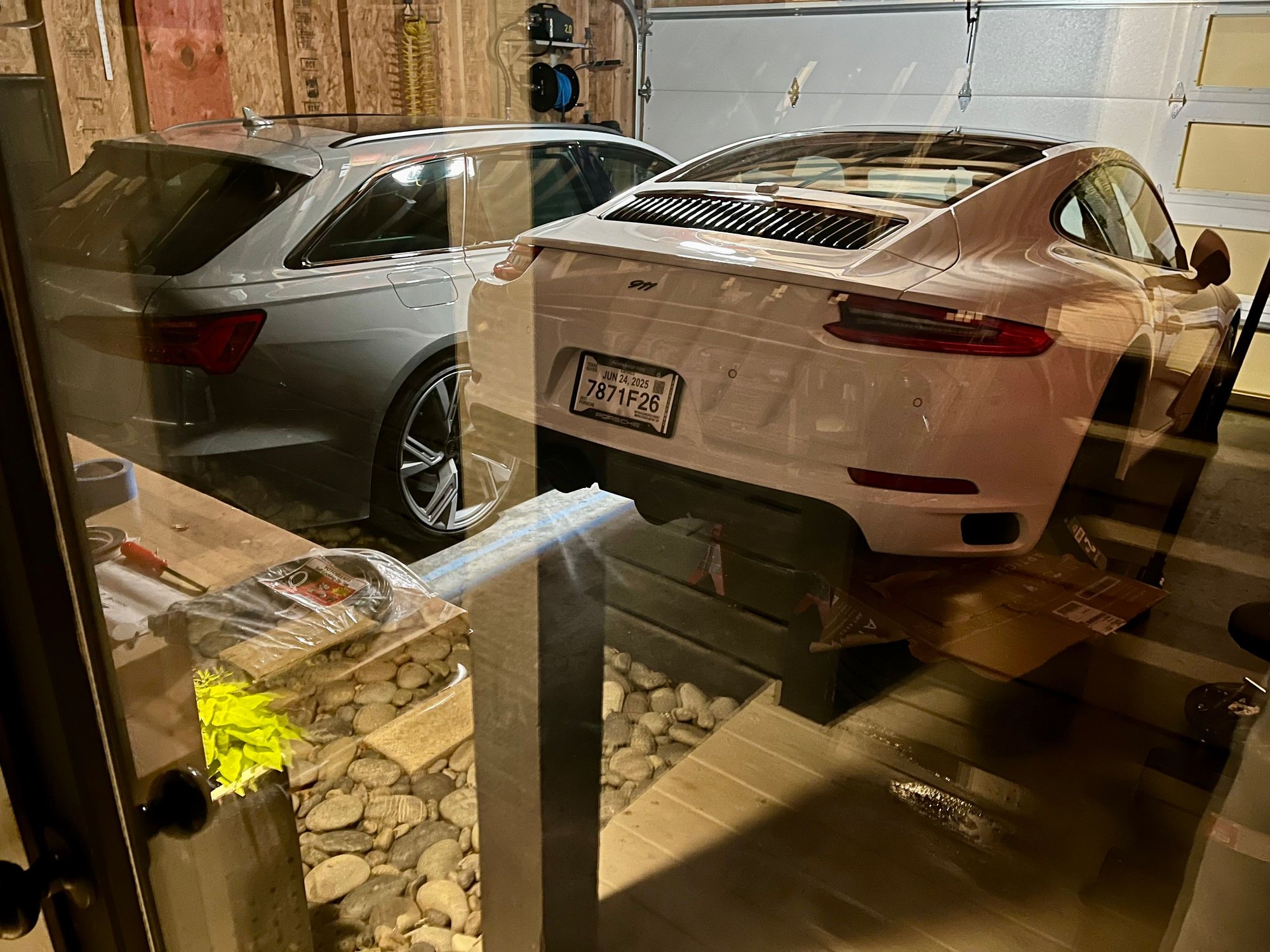

Well, this escalated quickly. She sleeps like this tonight until the brown truck drops off the Swedish Gold tomorrow 👀
