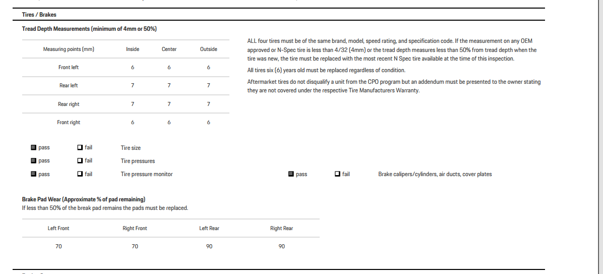

You shouldve received the CPO report upon request (it's okay but nothing amazing other than a statement that something was looked at) but the tires and brakes have actual quantitative data instead of pass/fail like almost everything else on the report.
example from mine
You can also ask your sales guy to give you the report on what (if anything) was done to bring the car up to CPO, at least mine gave it to me upon request and it was greatly appreciated.
