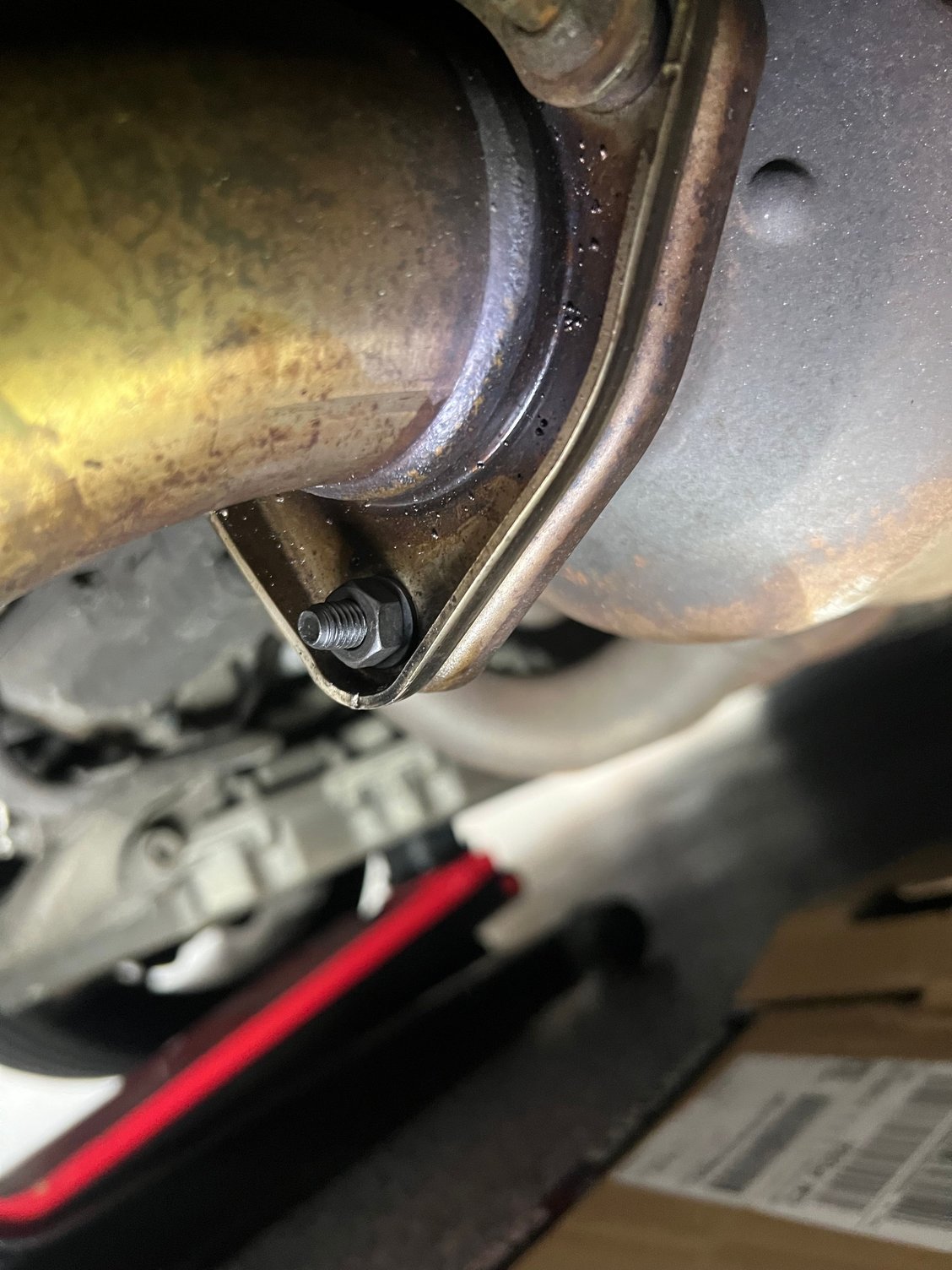

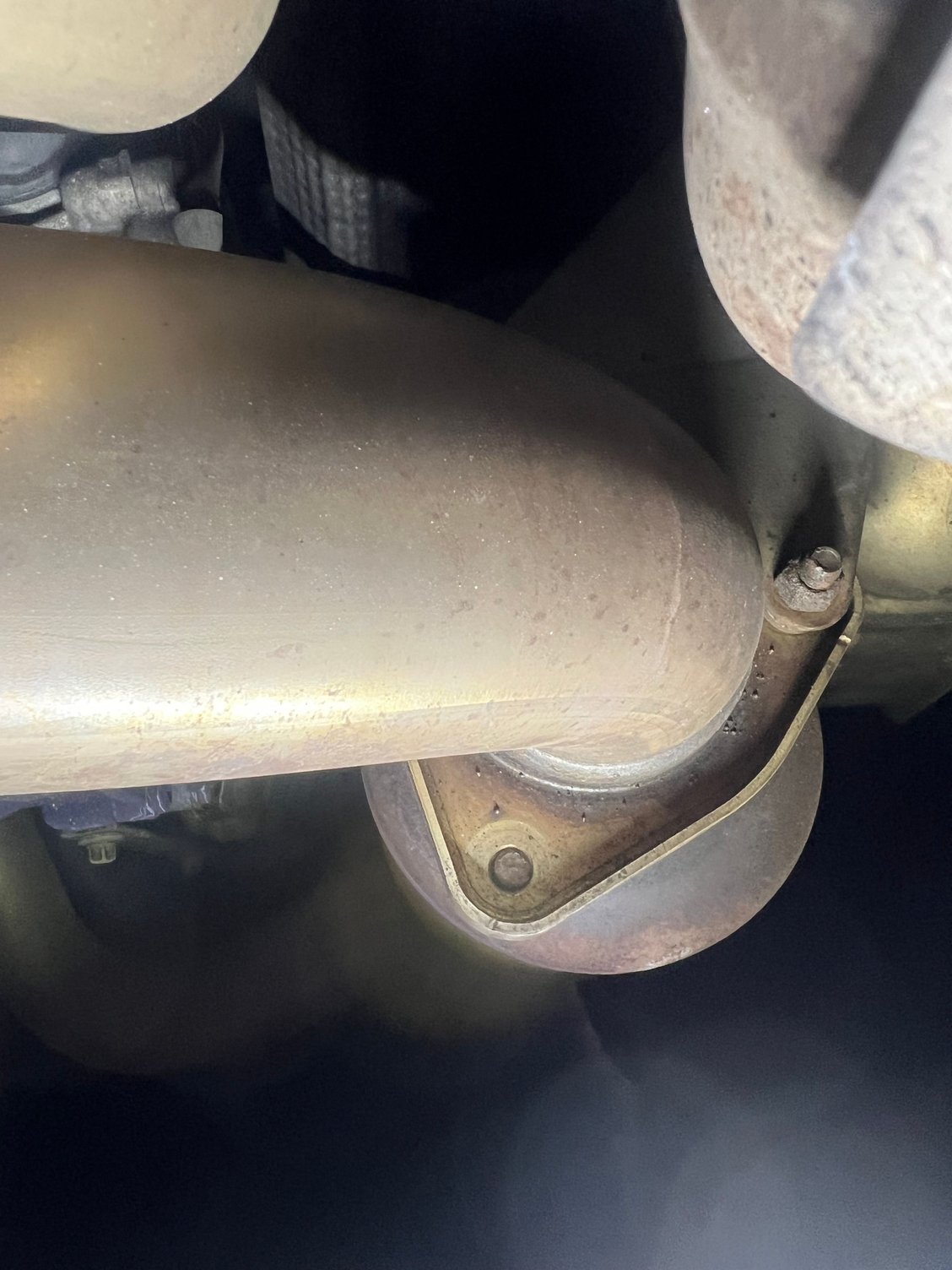

I’m curious how to replace this broken bolt on my 991. The nut end is gone and not sure what would attach to the other side????

it's a pressfit stud. You can punch it out and use any nut and bolt combo that fits in there to clamp it

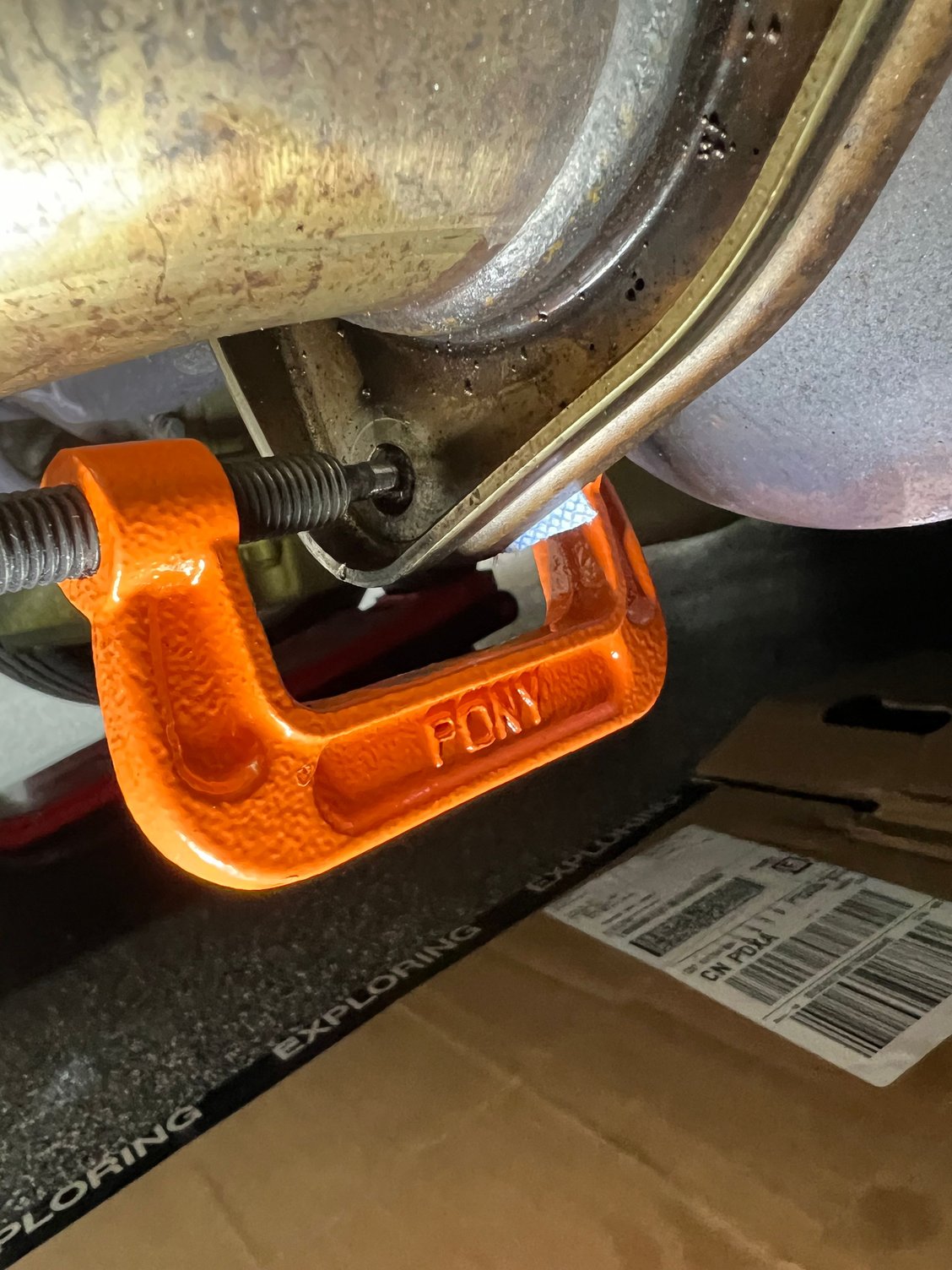

Thanks for the reply’s, that bolt is stuck! Tried using a hole punch/ hammer, heat, pb blaster and a C clamp with a socket. Hasn’t budged.001”. Hopefully my local muffler shop can help.

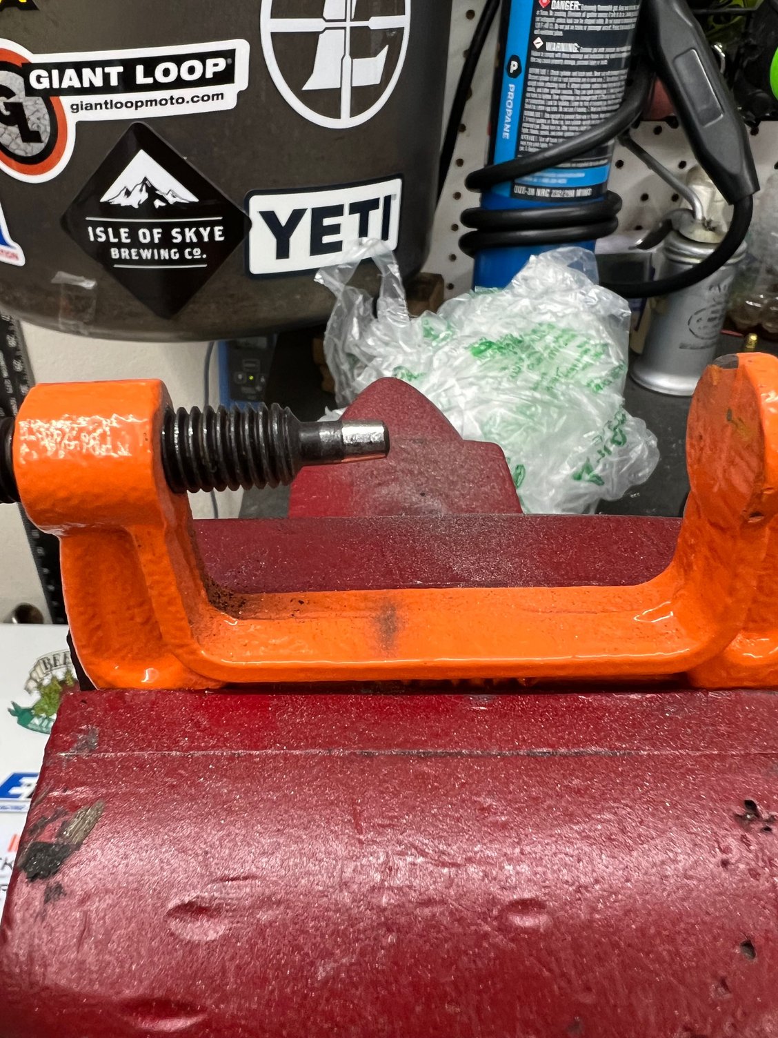

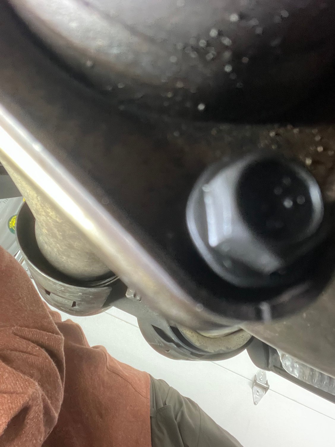

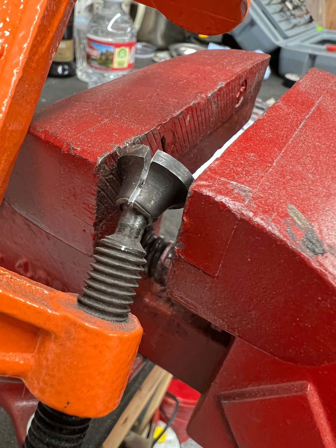

Success! Had to purchase and modify a C clamp. I purchased an orange Pony brand C clamp and cut off the adjustable swivel end and a nice pin was at the end of the jack screw. Used a 15mm socket on the stud head and then started tightening the clamp. A few hard hammer hit on the jack screw was helpful when the turning force was too great for the $5 clamp. Took about 15 minutes!
Cutting the end off with a dremel tool
New bolt in place
