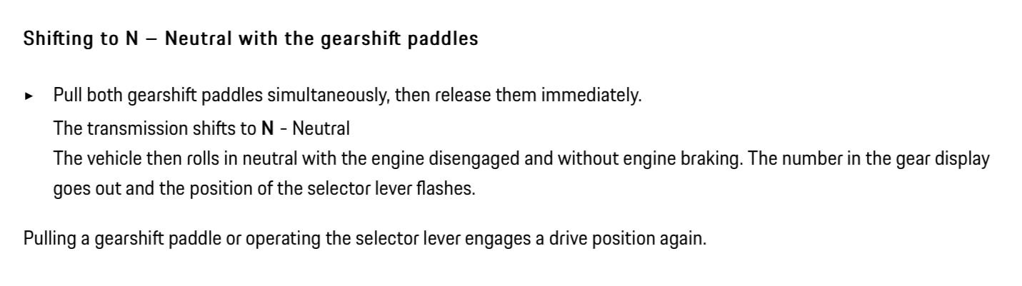

I found this blurb in my owner’s manual. Gave it a try, getting back into gear is not so straightforward. This is a 991.2… not sure if this works on a 991.1
I found myself at a stop light and not able to go when light turned green.
Here are my observations:
you can pull either paddle to switch back into whichever gear is appropriate, WHILE moving. The Pdk seems to go to the speed appropriate gear.
IF, you are stationary … you must press the brake, then pull paddle, without the brake applied it will not go back into gear.
just sharing as the part about braking/stationary is not in the owners manual.
Anyone else seen similar behavior?

That is not always the case ... if you do the dual-paddle pull for N ... and then pull again to re-engage while still moving, it does go back into gear (what seems to be the speed appropriate gear)... ie, highway off-ramp, pull for N ... coast down to 5 mph, pull a paddle you end up in 3rd gear or something.
