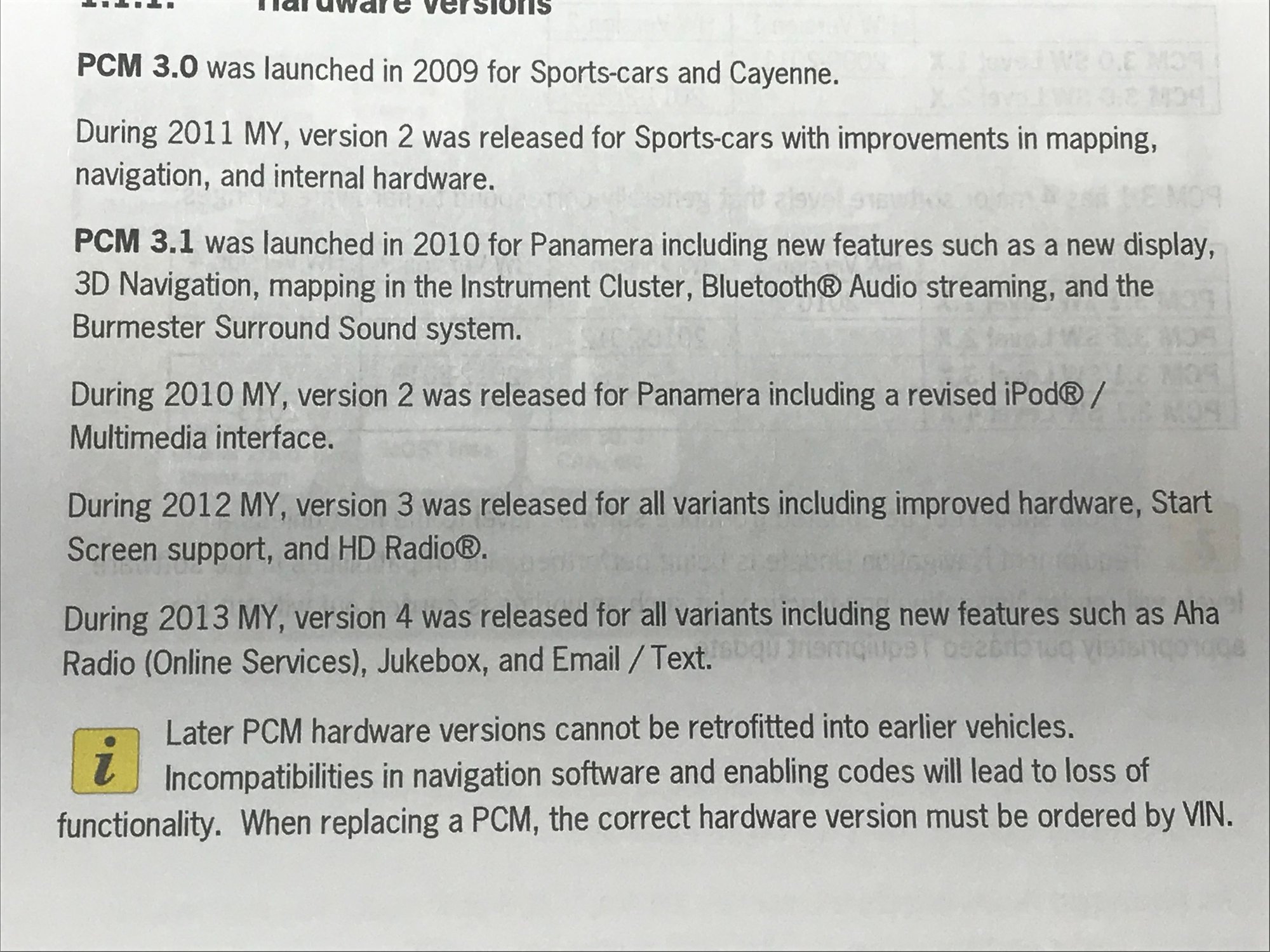

According to the Porsche PCM 3.X Overview “ Later PCM hardware versions cannot be retrofitted into earlier vehicles “ (see screenshot below). Jim

I'm reasonably sure that you can drop in the v4, it'll just require some coding. at worst you'll need to splice some wires.
as I said before, you can put a PCM4 into a 991.1. That's definitely a different connector though, you'll need to do some wiring on top of coding.

Yes, it can be. I retrofitted a 2016 PCM3.1 running V4.76 into my 2014 991.1 GT3 without issues (other than the need to recode with the VIN-specific code for the different headunit). No physical changes, no extra connections, no splicing required - just the code then it's plug and play.
