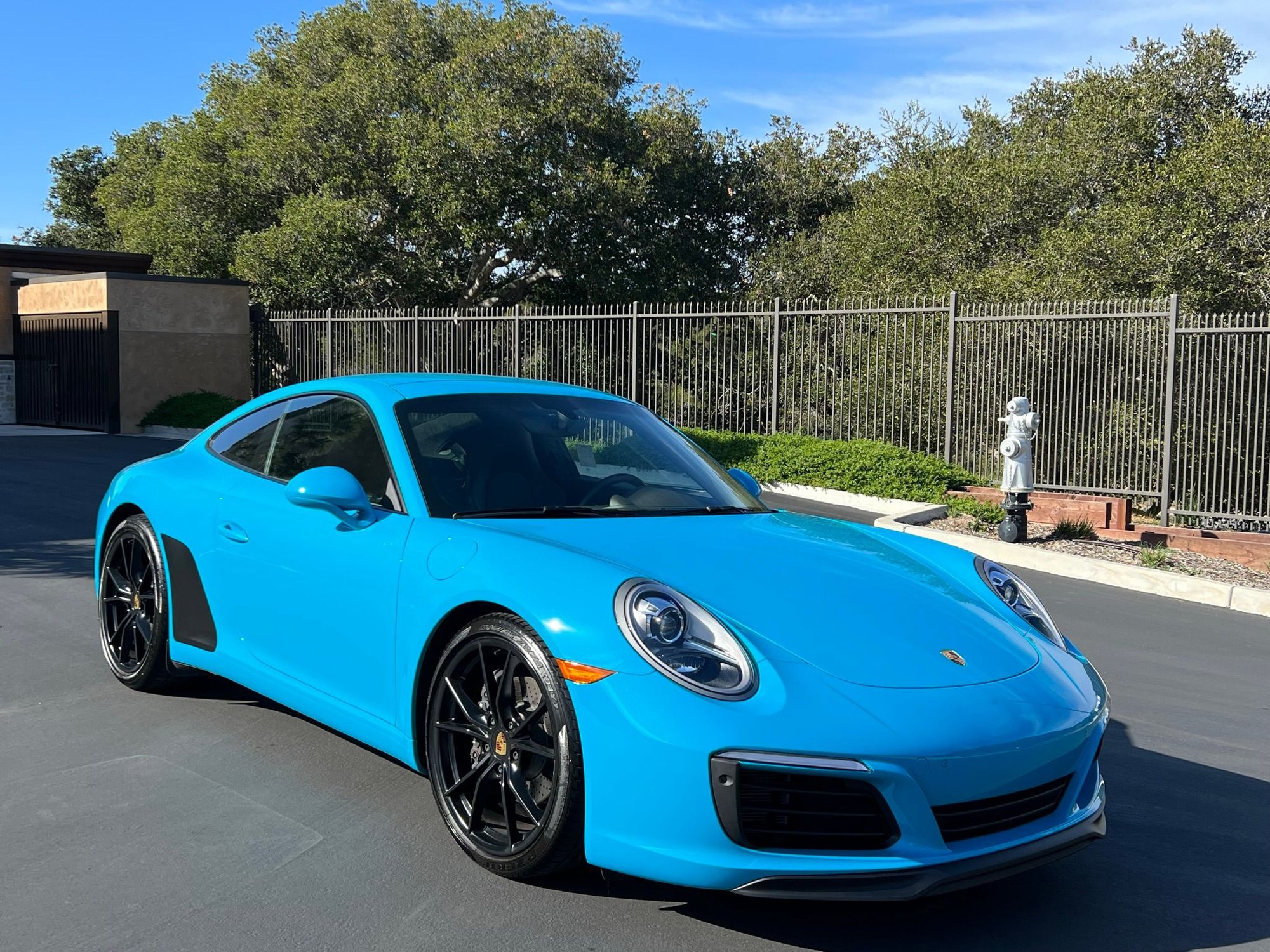

@blackcheetah I have a base carrera. I just intalled a Cobb AP, running 93oct map. The car feels more awake, but I am yearning for more.

CongratI realy like your blu pcar
