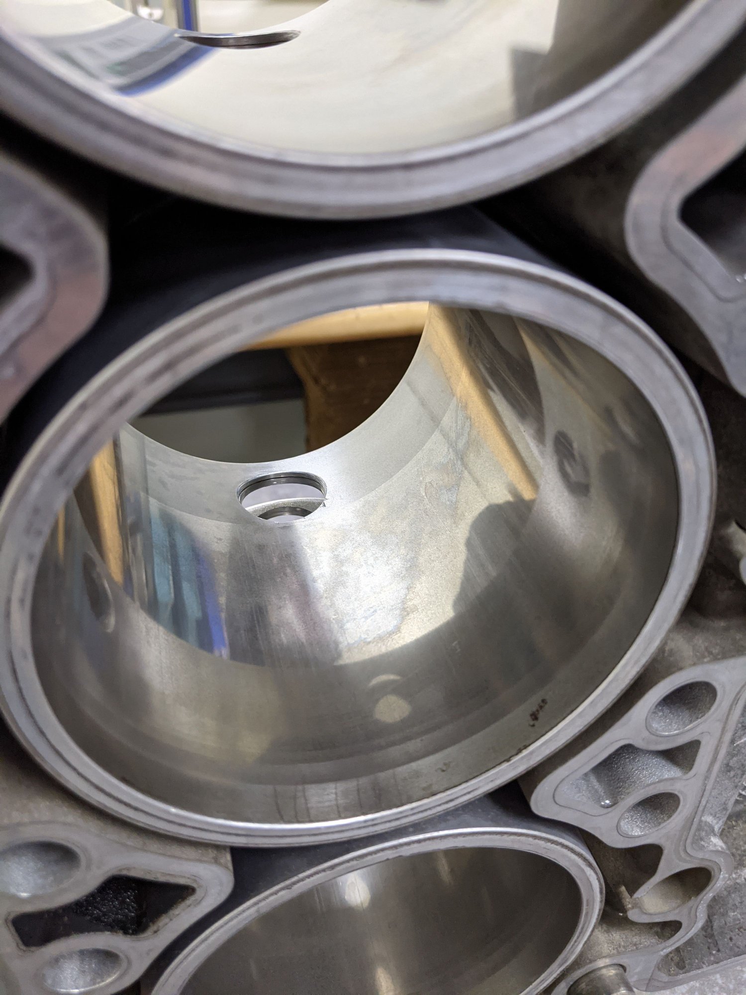

The 991.2, 992, and 718 engines (and several other from VWAG) are using Oerlikon's SUMEbore process. From what I've seen with the testing we've done in conjunction with Oerlikon, Total Seal, and Flat 6 Innovations, it's great stuff. No measurable or visible wear after some pretty tough testing we did on a 3.2 to 3.8 build we did to evaluate the process.

With relation to the current 9A2 engines (or even 9A1), does anyone know how long the 997s went before bore scoring became an issue? I don’t know if there is enough experience. With regard to tracking, does the LT2 have the same issue? In everything I’ve read and seen, there isn’t one cause. I’m not even sure how many other manufacturers have this issue. Does anyone know? What about the basic H6 design verses a V? I’m sure Porsche is well aware of all other designs and subsequent experience.
Charles, just read your 2019 research article “Understanding Bore Scoring”. Great work. I also now understand the difference between PWTA and SUMEBore process. Thanks.
Really appreciate it. That has definitely been my take away and my plan now is to shoot for a 991.2 or 9A2 engine model in my budget. Thanks!
On your website you have been gracious in providing much information including the following:
https://lnengineering.com/products/w...1.html?limit=8
"Later 991.2, 992, and 718 (4-cyl) models still utilize an aluminum engine block, but the cylinders bores are coated using a SUMEbore coating."
Since the 718 4-cyl is explicitly specified, should I read this to mean that exclusively the 4 cylinder 718s got SUMEbore -- and therefore others like the naturally aspirated 6-cylinder Cayman GT4 did not? Do you know when they switched the 6 cylinder Cayman engines to SUMEbore? Presumably they must have but I just don't understand exactly when the switch occurred since I read your verbiage to indicate the 4-cylinders got it first (I guess maybe that makes sense since those are higher pressure boosted?).
Are you aware of any instances of SUMEbore failures? I realize there may be limited information as many if not all would still be under warranty and therefore there is not much information in the aftermarket. Just curious if you have heard of anything........

I've tracked this a bit and so far I'm not aware of any community reported bore scoring cases in 991.2 engines, at least in the same fashion that the 997s or a few 991.1s had.
FWIW these were also rare in the 991.1 engines... I was one of the unlucky few this happened to. But I ended up getting a rebuild by the incredible Deman Motorsports and as part of his 4.5L package he switches to Nikasil which doesn't have this issue (the underlying cause in my case was a bad injector).
Of course, that's not to say it's not impossible. if there's something seriously wrong with the engine I'm sure you could manage it.

I am unaware of any failures with SUMEbore. From my personal experience with SUMEbore, it is awesome. If there end up being any issues in the future, it's going to be related not to the coating on the bores but other issues like shrinkage in the bores around them main bearing saddles combined with very tight piston to cylinder clearances.
I purposefully did not include in my statement quoted above the 718 GT4 as I am not 100% sure when and if they switched to SUMEbore. I would assume models with the plastic oil pan as found on the 991.2 would also have received SUMEbore, but I don't have access to information about this and Oerlikon could not confirm this with me as they just sell the SUMEbore powders and the coating equipment. to VAG.

Nonsence, here in the Uk loads of 991.1 3.8 9a have bore score, hartec are inundated with work from them, I have a 991.1 c4s,it has now got borescore and will need new cylinders,the car has been looked after its whole life, every Porsche will suffer from Borsesocre no matter what, this is a Porsche flaw but they dont care, they got paid the high price for the car when new and as they change hands over the years some with no warranty then its not there problem anymore,they just dont care,they Do know it will happen eventually Fact

Ahhhh, I think you might be confusing the 9A1 engine with Alusil cylinder liners found in the 991.1 with the 9A2 engine with SUMEbore iron cylinder liners in the 991.2 and 992 models. Apples and oranges.
