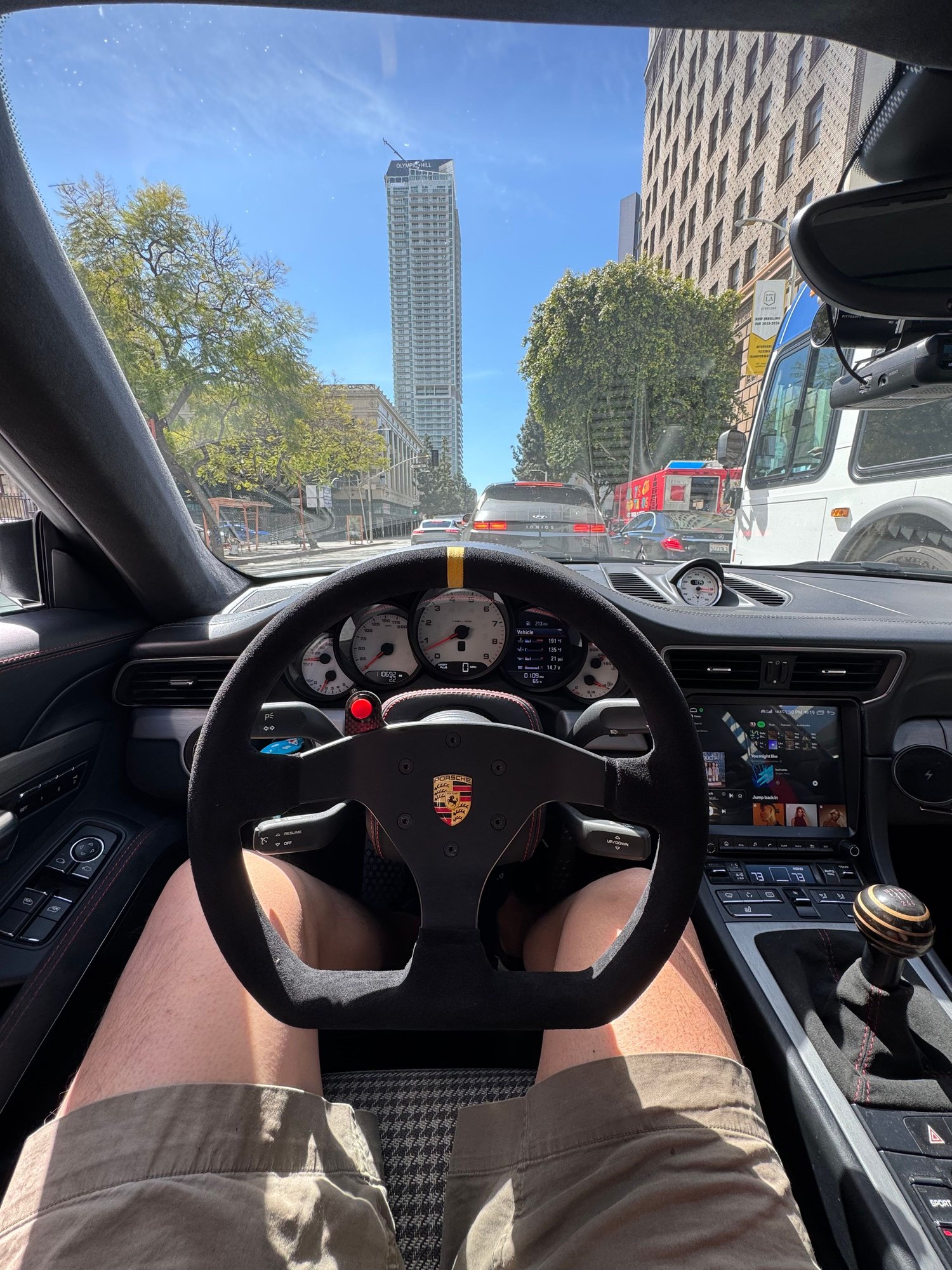

If you really want to change the steering feel for about $250, but you lose your airbag.
Just get one of these cup car steering wheels LOL
That's what I did, and love it.

i know i sound weird and butthurt arguing for this but if you read through the troubleshooting process we went through two years ago when this came up we discussed that possibility.
i put the car into other modes and drove around.
-the 4S mode gave the error and steering feel was just like the 2S.
-there was another mode that wasn't the GT3 mode that threw the error and felt different from the 4S or 2S modes.
-the GT3 mode throws error and steering feels more like my 993.
so all modes besides the one for the car had the same error and those other calibrations were clearly ready for production.
anywho
got a new steering wheel to match my awesome, perfect, problem-free GT3 calibration. :P
