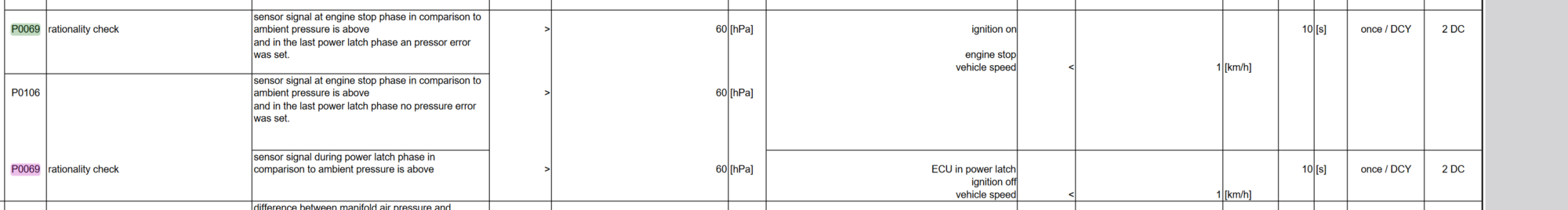

Maybe I'm reading this wrong but the enablement condition for this code is when
Ignition off, vehicle speed < 1kmh. Which means that the engine has to be off for this error to pop up?
Or when the engine is on, but you're revving the engine.
Sounds like the best way to trigger this condition is to rev the engine for a bit and then get it to overrun.
I would turn off the car and see if the sensor is showing anything. If not good idea to do a leak test. Sounds like air is entering somewhere. Hope that diagram helps.
I also think you could try adjusting the throttle valve. Maybe the dealership didn't do it right.
Ignition off, vehicle speed < 1kmh…..
You happen to have a link to this document that spells out the exact conditions that trigger DTCs?
…or is this a screen shot off a scan tool?
