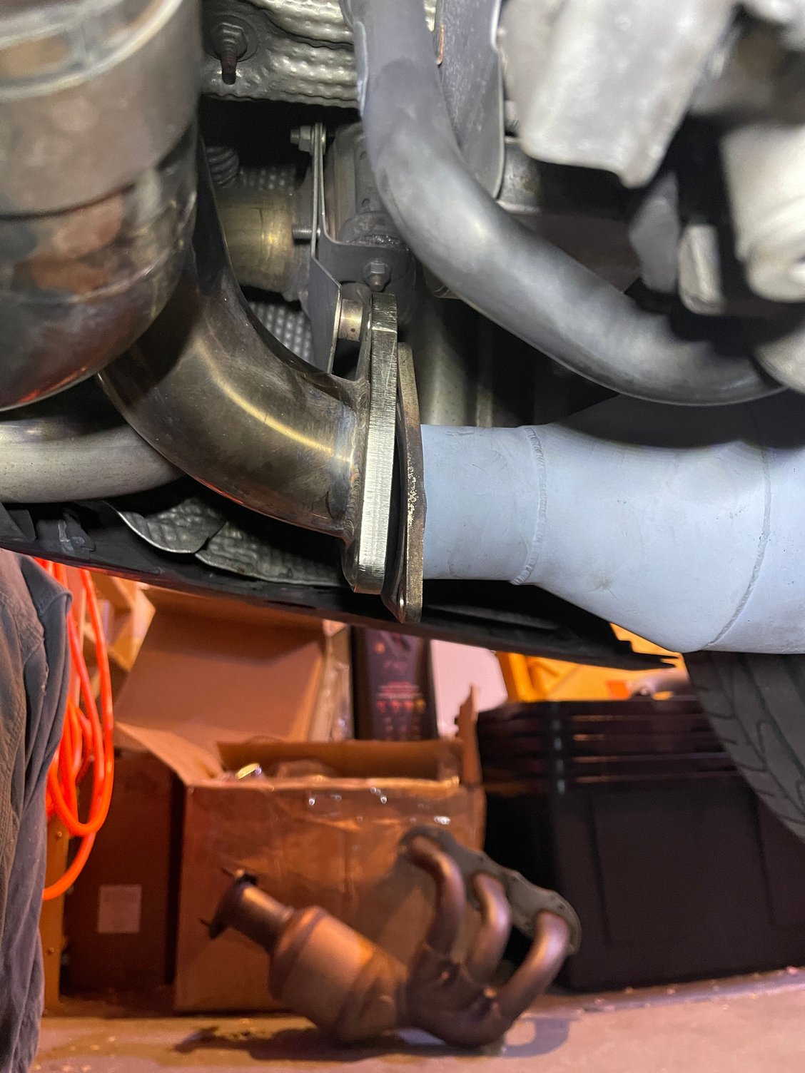

Does anybody have experience with Kline headers for 991.1?
Trying to install a pair of street headers on my GTS with an IPE exhaust on it. IPE lined up perfectly with the factory headers (installed a few months ago) so took off the headers and kept the IPE exhaust bolted up thinking the Kline headers would fit just like the factory but not the case.
Here are some pics, I don't see how I could get the IPE to fit, even if I took it off and tried to align it with the Kline headers but what do you guys think? Is there enough adjustment if I loosened up the IPE exhaust to have it line up right? Had to step away anyways since I need to buy bolts tomorrow (they were used kline's so they didn't come with the flange bolts).
I tried pulling the headers up to line up with the flange on the IPE but I didn't want to put too much pressure on the headers and pop a weld or bend something because it wasn't going to line up without a LOT of pressure.

Probably best to break everything loose and start from there. I had installed the FVD Brombacher Sport exhaust (center muffler delete) with the OEM headers and when I went to install the M&M Headers from FVD, we found it easier to tear it all off and start the installation from the exhaust flange rearward.

I was afraid of that………
much easier to do with these jacks! Thanks again Tom.

When we aligned the rear center section, we also eliminated the stock supporting band clamps as they were causing issues. The center section is securely bolted to the cat flanges with six(6) bolts, 3 on each flange, so it’s got all the support it needs and isn’t going anywhere. I checked after 2000miles and everything is secure with no signs of looseness or rattling of any sort.
Eliminating the center band clamps may help with the alignment issues.

Before you bolt on the headers, place the flange side of both the OEM and the Kline flat on a bench top. You can then visually compare and measure the Kline set against the OEM for flange to cat center dimensions, cat flange position and orientation, etc. With today’s modern equipment, the Kline should be an exact match but some tolerances may have been exceeded at time of manufacturing resulting in a non-matching fit up. No experience with Kline so I would have to assume they are a close match.

I think I’ll bolt up both headers and then reinstall the IPE exhaust, there is no play in how the headers go on but the rear section does have a little.

I just needed to be patient! As soon as I took the other side header off the whole exhaust dropped down and aligned perfectly. Didn't have to undo the cat-back section.
