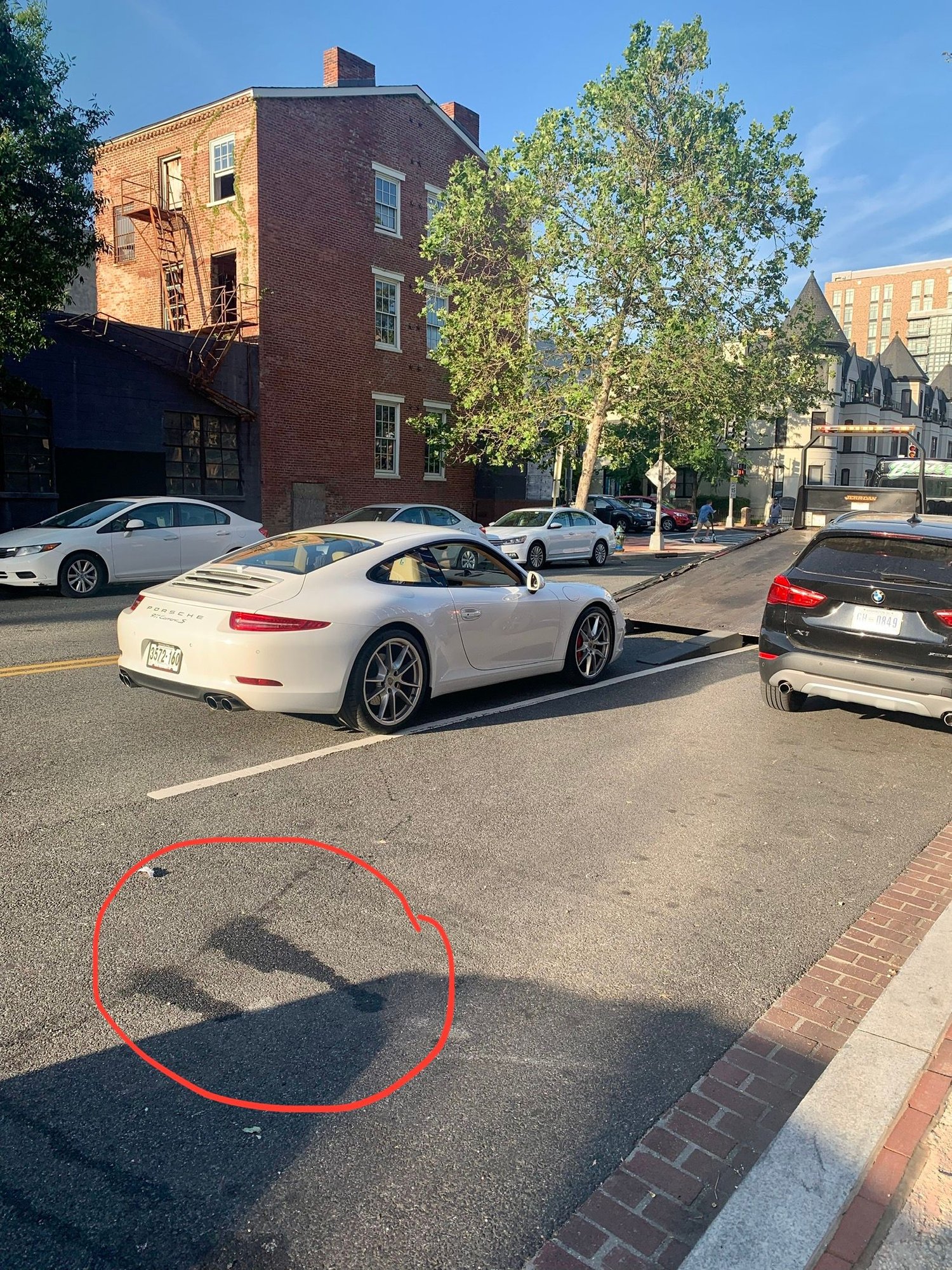

It is most likely water pump failure. It is quite common.

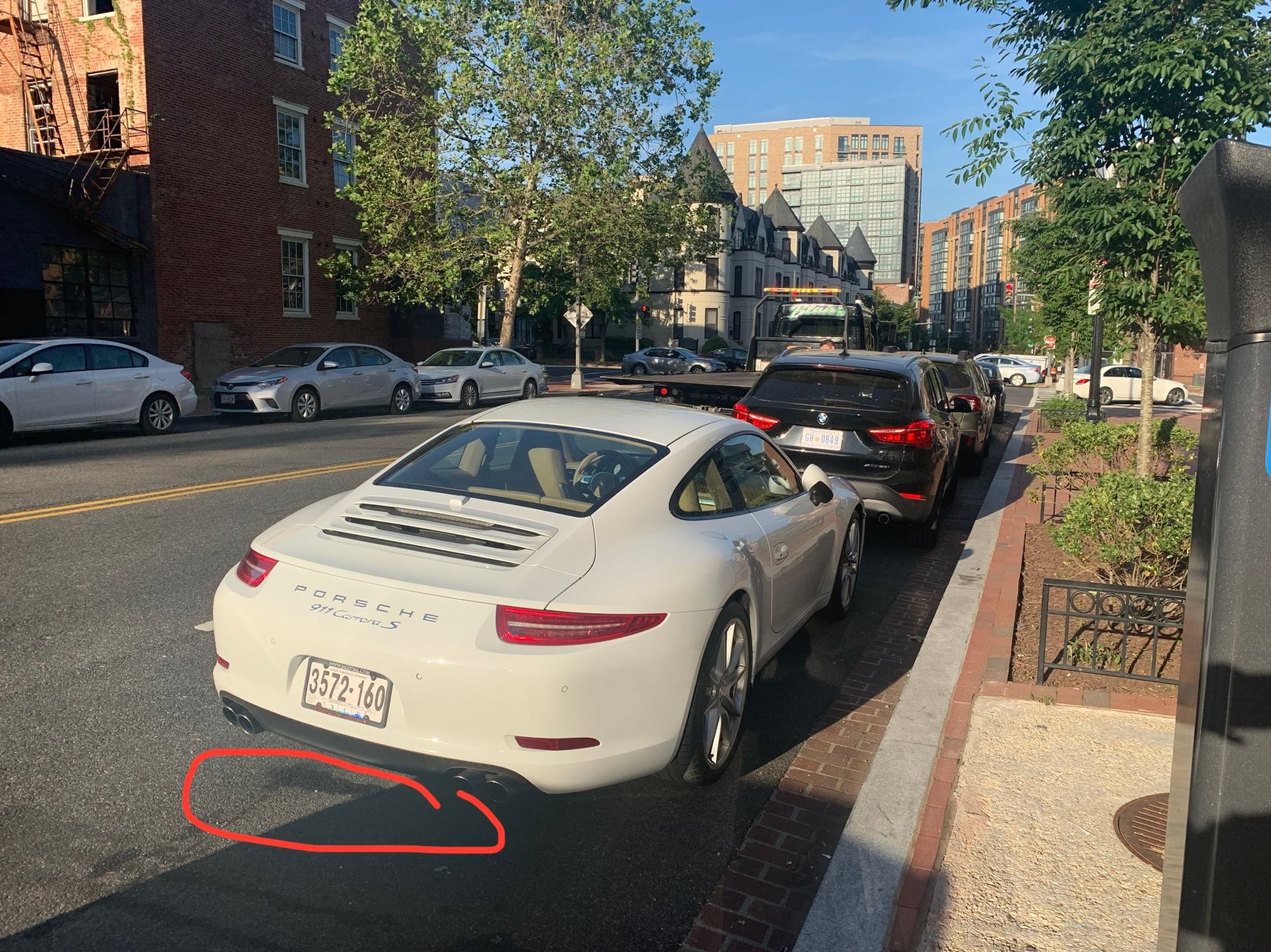

Thanks - Now that you mention that, I went back to look at my pics and noticed there was a large puddle by the exhaust and where the water pump would be located.

Sorry to hear. Yes, the message you got + large puddle under the rear sounds like a water pump (again). The good news is you caught it early. Hope it gets resolved at the dealer fast. The linked threads should have more info about the part(s) that are typically replaced, including the water pump and components associated. Good luck!
