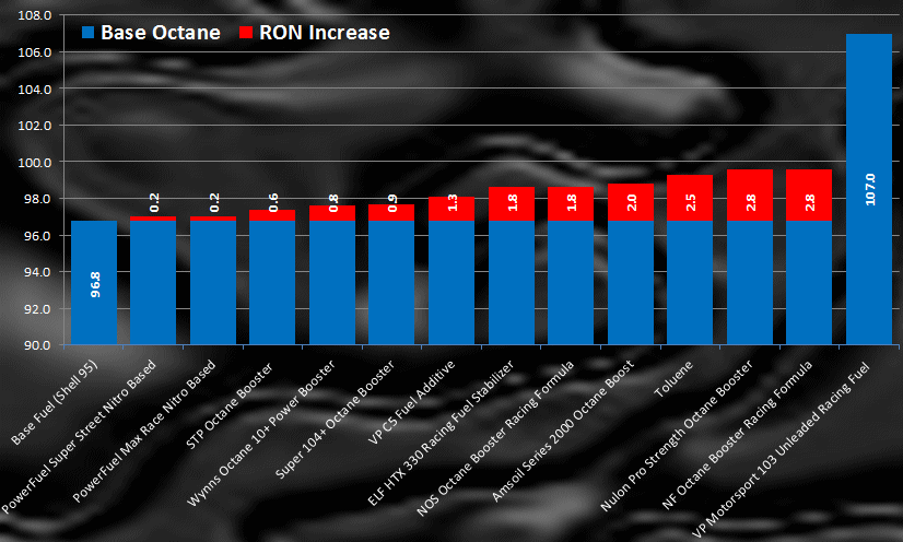

Originally Posted by Fullyield
Octane booster for sale at WalMart?
careful, the vast majority of these are snake oil, especially the ones you find at Walmart or your gas station. you're better off just putting straight toluene in your tank.
here's some light reading showing that some DO work, unfortunately only measuring RON instead of AKI, but the picture is pretty clear. at the price, you might as well just run race gas.
the handy graph from the above link for those who don't want to read:
For AKI, these 2.5-2.8 RON increases will translate into something like 1-2 AKI, bringing your 91 pump gas to just above 92. You won't notice it, and neither will your car.
