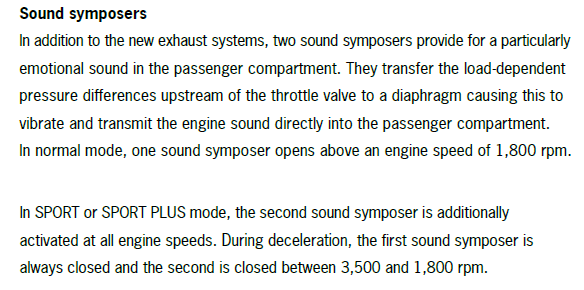

As regards to the lack of engine noise, vs. tire/road noise, if the car is not new to you, it would be an idea to check if the sound symposer was blocked by the previous owner with a filler, cap, or insert. The sound symposer system is two small 1" plastic tubes connected with some electrickery from the intake system to the car interior, the idea being to allow sound to enter the cabin It is for a "particularly emotional sound", as it's described in the Service Information Technik document for the 991.2.
