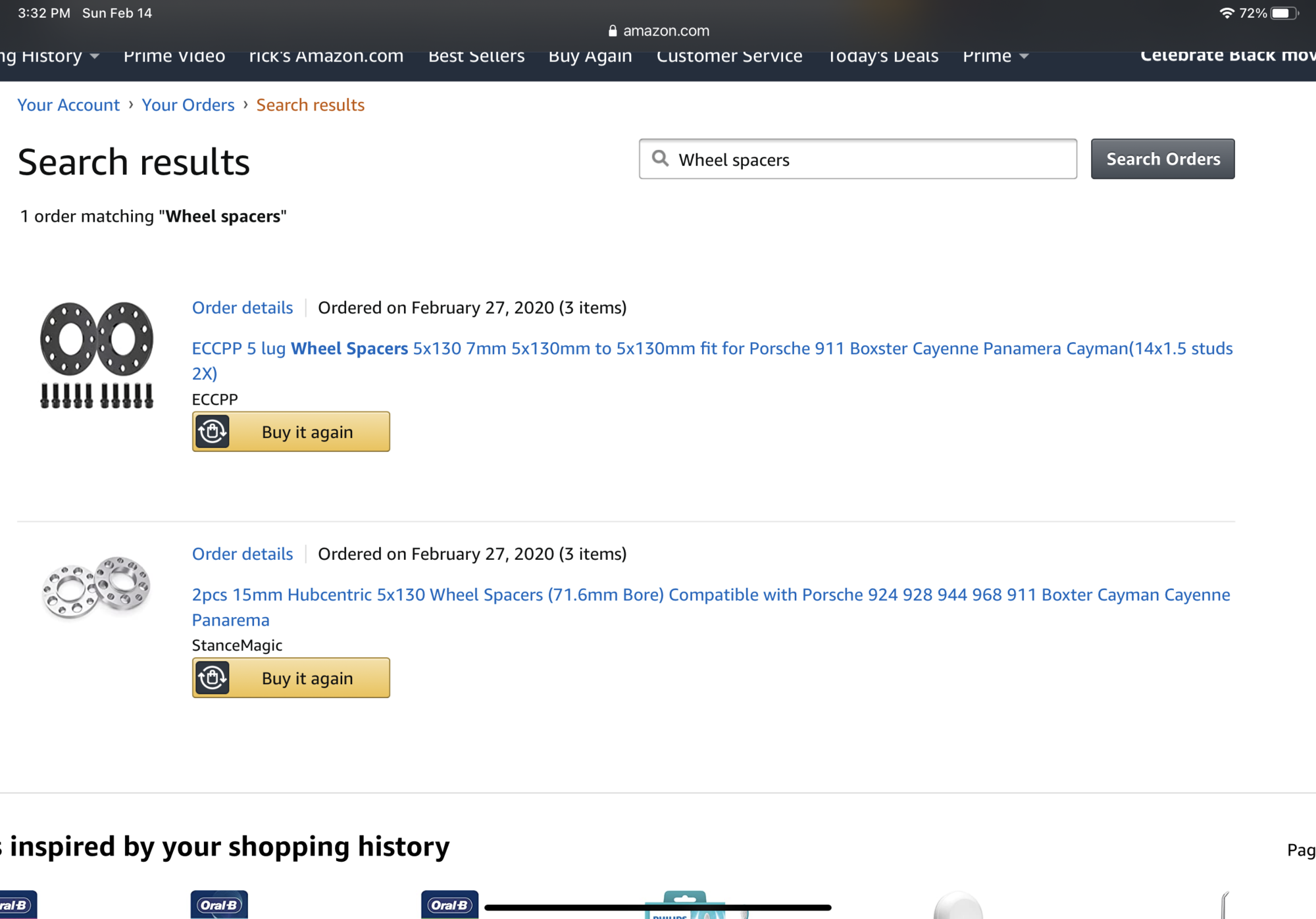

I went with 7mm front and 15mm rear on my ‘13 C2S with PASM. Love the look. I went the cheap route and bought them on Amazon.bought the longer bolts there also. Don’t wast your money on the high priced brand name spacers. They are simple pieces of aluminum that anyone with a lathe could make. Just make sure they are “hub centric.” Here are the ones I bought:
