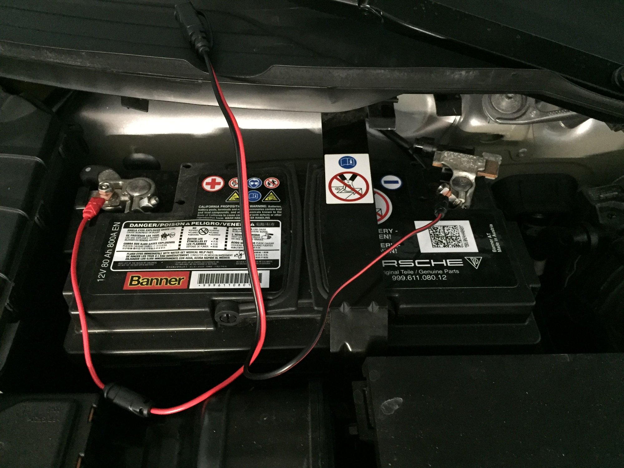

Open thread on the expectations of the Porche 991.2 auto battery charger. Not certain if the car is fully charging the battery.

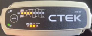

My 2019 was just purchased from Porsche on CPO where a new battery was installed. But being careful, I also purchased a CTEK conditioner (shown below) to maintain the battery when the vehicle is not being regularly driven.
Today being beautiful here (78 degrees) I took the opportunity to drive with the top down for about 50 or so miles - maybe 1 1/2 hours of driving. The vehicle was reporting a charge voltage of 14.5. When I got home, I took the opportunity to change how the CTEK is connected - from using the 12V plug on the PASS side (PITA) to hooking to the battery + and ground. When I started the CTEK, the car voltage was about 12.4 which, for an AGM, means that that battery was about 1/2 charged.

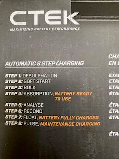

After connecting the CTEK, it ran on a slow charge state (0.6A) in step 2 until the battery reached 12.6V when it shifted into bulk step 3. As for the other times I charged this way, the CTEK will charge all the way to step 7 and float (green) as expected.
So is the car's charging system not charging the battery to full health where a battery tender will? Brand new battery - I can't believe there might be something wrong with it but in any case, it fully charges with the CTEK.
I haven't had a situation where the car wouldn't start but I have seen it where it won't shut off at traffic lights when I'm in normal indicating a battery issue. Has any experience in this realm?
Update: got to float stage in about 2 hours at which time the battery reached 12.9V. so maybe I’m ok.

You are describing what sounds like normal operation to me?
The "On charge" voltage and "at rest" voltage are not the same. You are going to get different voltages with a meter across your battery, than you will when it's on charge. Your CTEK charger is capable of a fairly hefty amount of current (around 4.0 Amps) at charging voltage - 14 or more volts. (That's about the same value that your car's alternator was charging at, 14.5V, as you noted). 14 V from the CTEK is the "bulk" charge rate and sufficient to get fully discharged batteries up as rapidly as possible. It will (as you noted) switch modes and cycle the charging profile automatically. It should be (and usually is) set and forget device.
(One other note: "12" V batteries are typically composed of 6 cells, wired in series, each with a nominal full state of charge of 2.1V. So the nominal "full" condition, measured with a voltmeter, will be around 6*2.1 or 12.6V. At 12.4V, your battery was somewhere around 75% full (https://modernsurvivalblog.com/alter...f-charge-chart ). This applies both to traditional lead acid flooded wet-cell or more modern Absorbent Glass Mat batteries.)
FWIW I also use a direct connect pigtail on my battery, which on my '17 C2 is (I think) original to the car. It takes my 1A NOCO Genius charger about 8 hours to charge back to green if I've taken it for a drive. If I let it sit a few days, usually it's back to green overnight.
I think you are fine.
