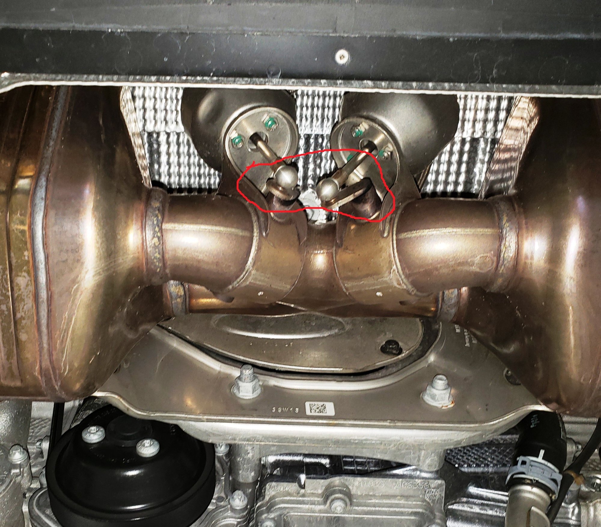

The PSE uses a vacuum-operated valve in each side of the exhaust. You can look under the middle of the rear bumper and see the actuators move the valve linkages when PSE is turned from on to off and back again.
