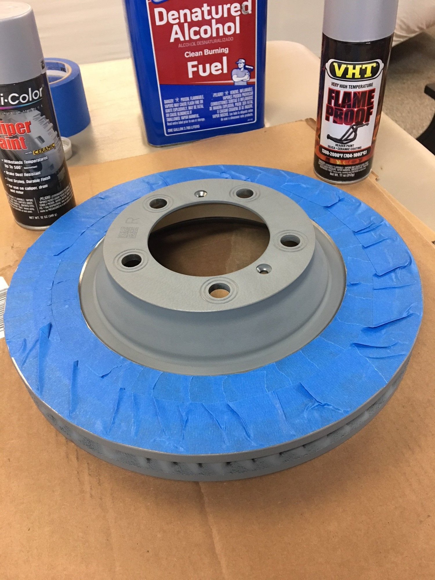

And do this to the new OE Porsche rotors before installing:
What is this Lex some kind of anti-rust treatment?
Mainly to have the rotor hats look nice, longer, when up against the wheels. OE Porsche rotors already come with an anti-rust coating (pic #1....the dull gray coating). Many aftermarket rotors do not, and the hats rust and discolor badly. I coated the the OE Porsche rotors hats with about 6 light coats of high temp paint, then coated them with 3-4 light coats of high-temp clear. Then, I baked them in the oven for about 4 hours, when the wife was out. I also made a big batch of chili that day to mask any baking evidence. In total the project took about 3 weekends, because of the curing steps required for the coatings. You can lay down many coatings in one day (within a 60 minute period), but after that initial 60 minute period, it requires several days of curing before another coating cycle.

Painting the hats is really a great move. I had new rotors put on the wifes past Lexus RX and they were So ugly and rusted within the first 3 months I took it back to the shop and made them paint them.
