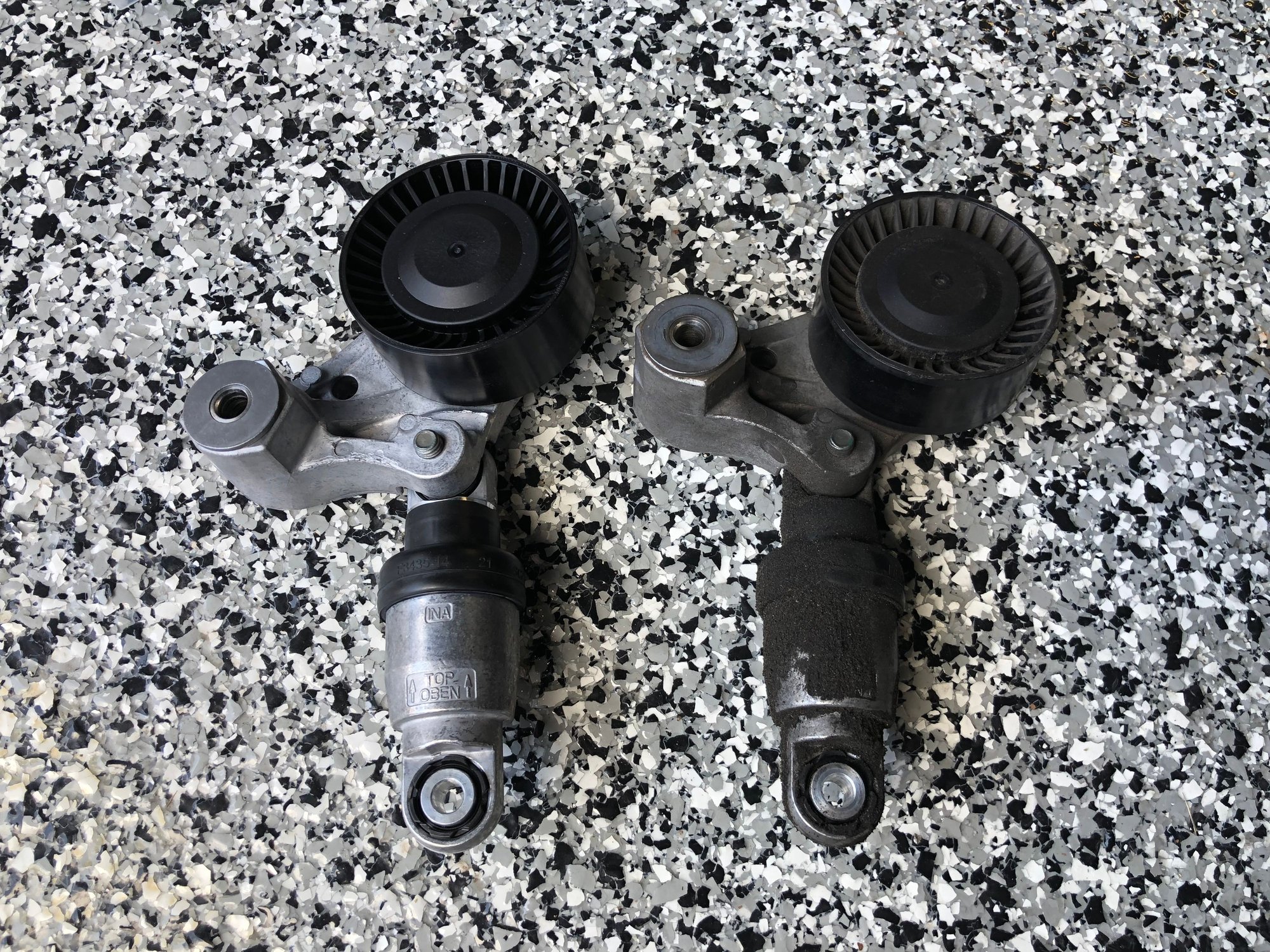

Originally Posted by Picketthouse
My 2018 c4s had the water pump leak at 7k. Now the tensioner locked up and melted the serpentine belt. I think its bad work from the shop on the water pump. A tensioner should last more than 8k miles. I will fight them if they try to make me pay for it. Oh and btw my parst are coming from Germany so its been two weeks in the shop and counting
tensioner damper is known failure item, they go bad just sitting there, I guess the seals go bad and start leaking fluid. Easy to diagnose if you pop your head under the car every once in a while you can keep an eye on it. Here’s the one I removed from my car, and the replacement for comparison:
If you see a bunch of grime on it, it’s because the oil is leaking out and collecting dust to make the grime. Replace if it looks like this! They are $30 parts, but takes effort to get there, have to remove everything same as belt/filter, and then you can remove the tensioner assembly and replace the damper (or the whole assembly is about $250 if you want to go that route).
