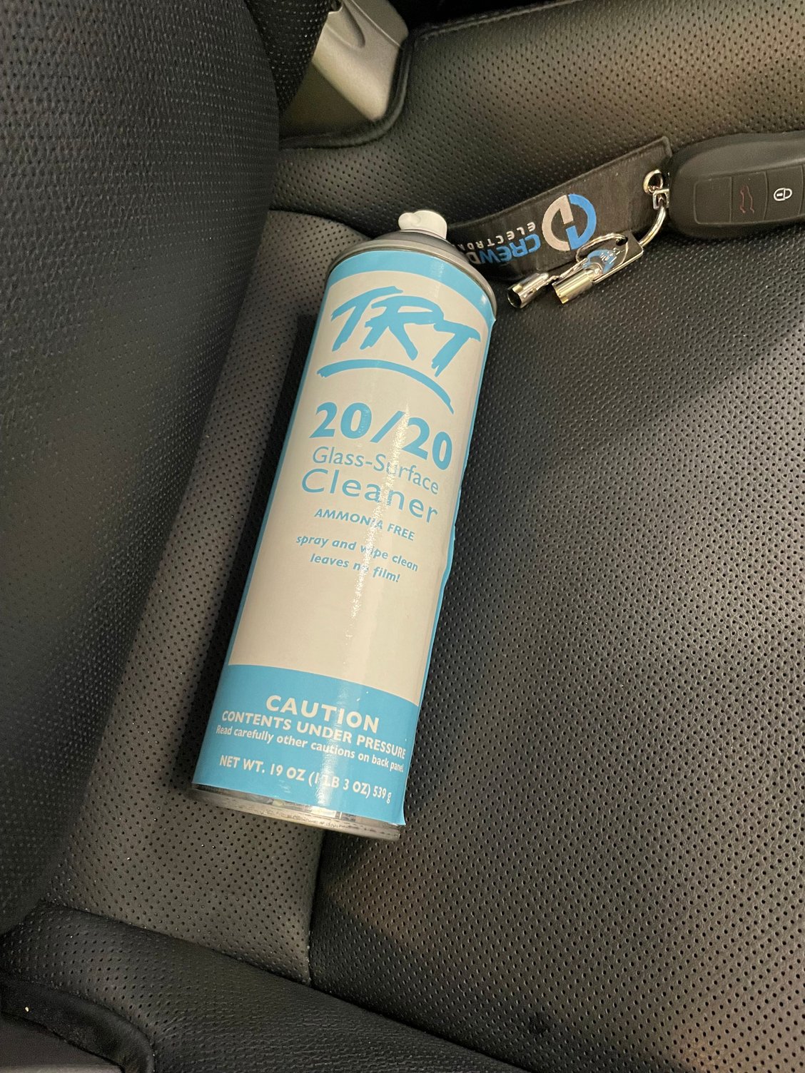

I stopped by my new to me local dealer yesterday (we moved to Venice FL this month), Suncoast Porsche in Sarasota FL to chat with my new SA. I asked him about a few things, and mentioned that the buttons on the car were always sticky, and did he have any suggestions.
He took a look, and said "give me five minutes" and drove it back to the detail shop. When he got back, the buttons were almost 90% of new function. I had him show me the product what he used, and what he did, sitting on the service drive. Basically, he sprayed a light coating of this "TRT 20/20 ammonia free foaming surface-glass cleaner, let it sit for a few seconds, then wiped away the foam:
Each time he did it, a bit of the foam came up from behind the switch, with a slightly brown-ish color (like, say, the color of a double latte ). He did this a couple more times, and by this time, each and every switch on that side of the car console worked absolutely 100%, like the ones on the driver side. He said he had seen this before, but never so bad as in my car.
I am so glad I stopped by Suncoast. This was all done without an appointment, just drove in with my car to say hi. I was pretty dang impressed.

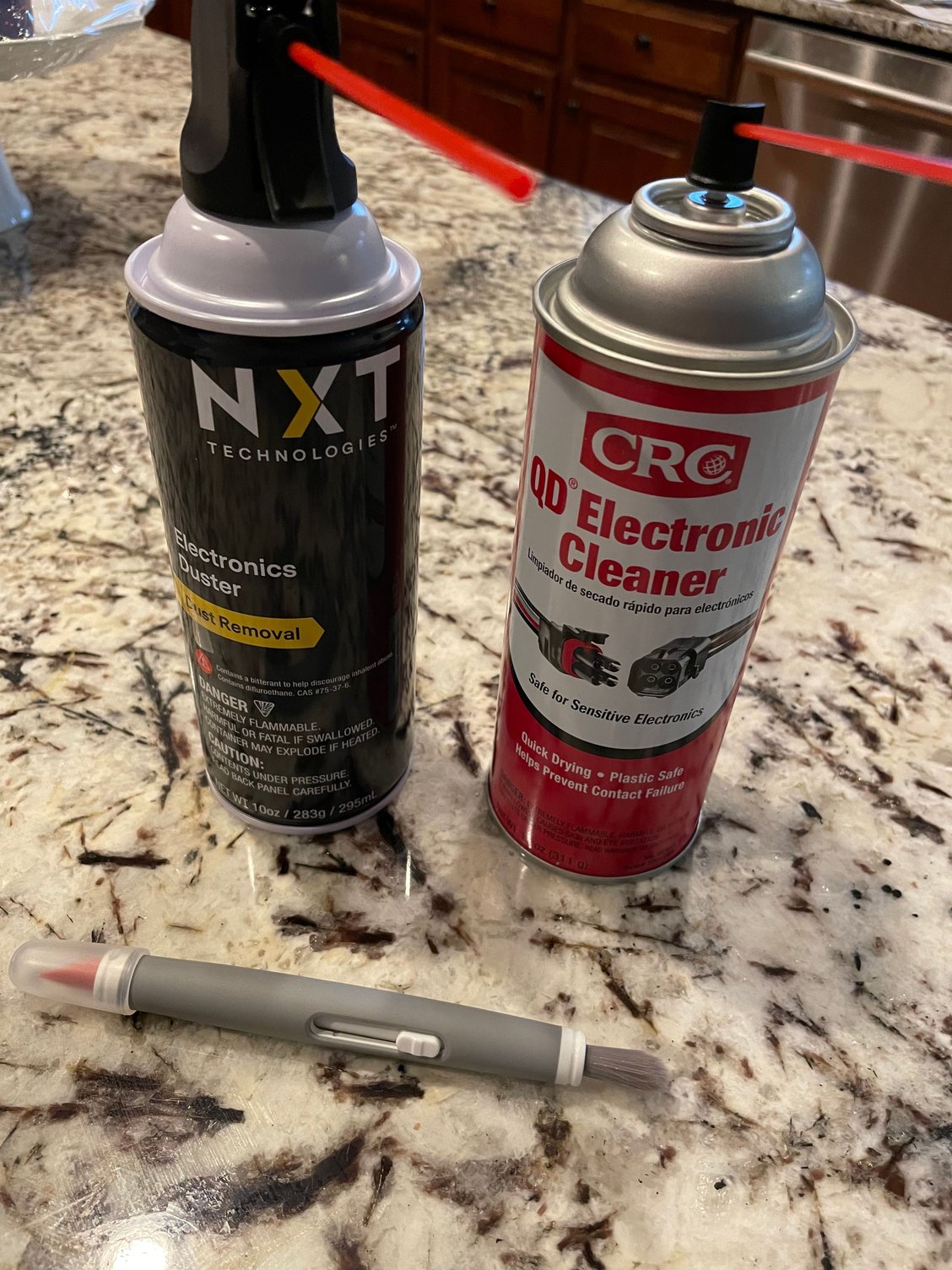

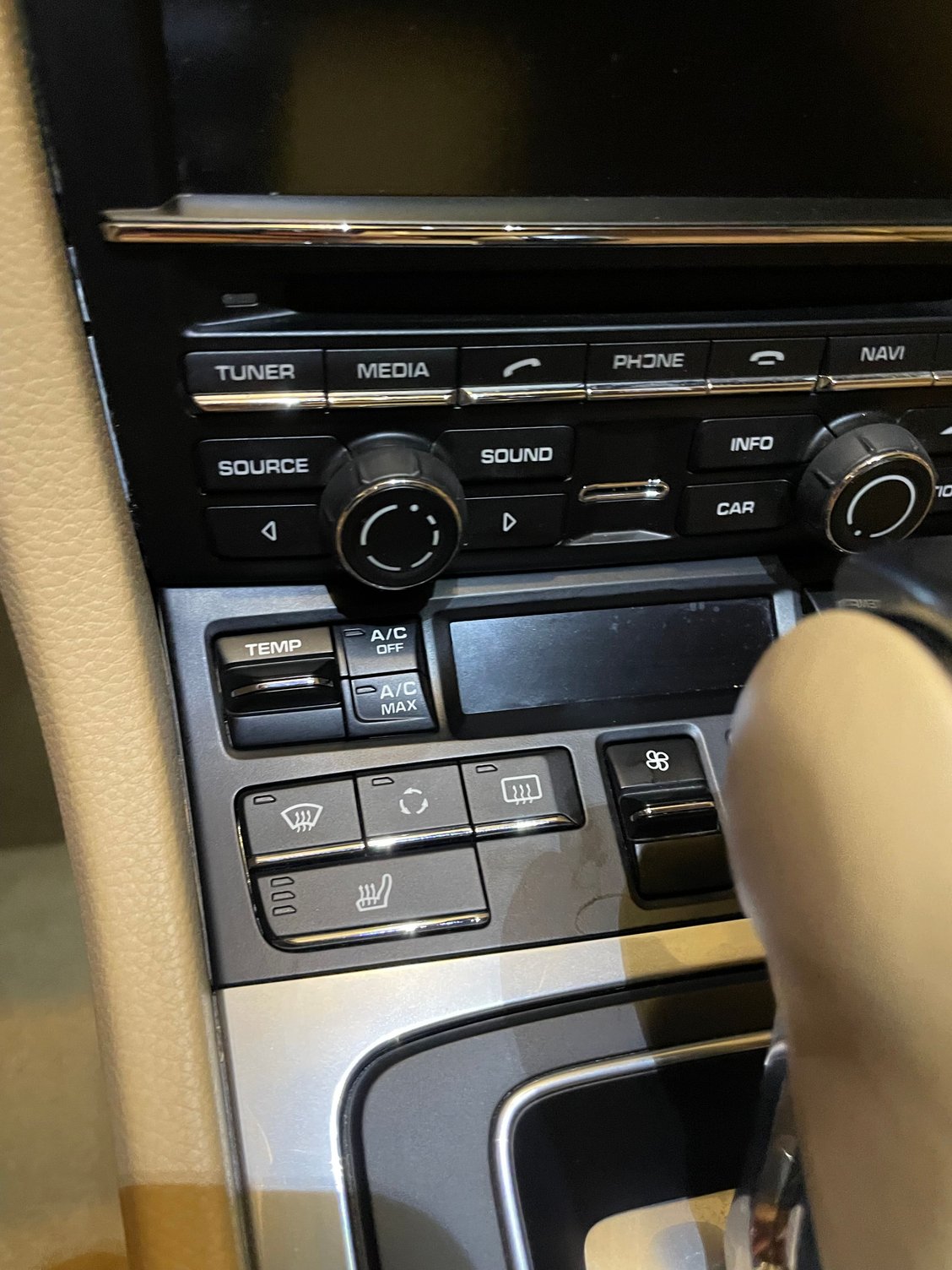

Similar to others who posted here, I have a 2012 911, 991.1 that had 3 climate control temps that would heavily stick. They were functional but took a *lot* of pressure to press / activate. Impacted buttons where all driver-side: temp down (up was fine), AC off, and AC Max.
  • Round one: I tried dental floss. (tip: I used an OXO Good Grips keyboard cleaner. The fine brush part effectively helps you push floss around the buttons. Found here: https://tinyurl.com/bdf67vbz). Floss came out clean (no gunk) and did little to help
  • Round two: I tried using a can of compressed air while being mindful to keep at a distance so that the cold air temp didn't cause any issues. No luck.
  • Round three: Admittedly I was hesitant to use (and spray) the CRC QD electronic cleaner directly into the side of the buttons. However, after shaking the can and spraying it on an unrelated surface (and using the compressed air) and ensuring no residual; everything checked out fine. I sprayed small amounts around the buttons and worked them for several minutes. Everything eventually loosened up and now all the buttons are 100% operational and easy to use. They all even 'click' when pressed.
Couldn't be more pleased!
Good luck,
Steve
